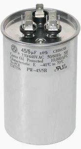

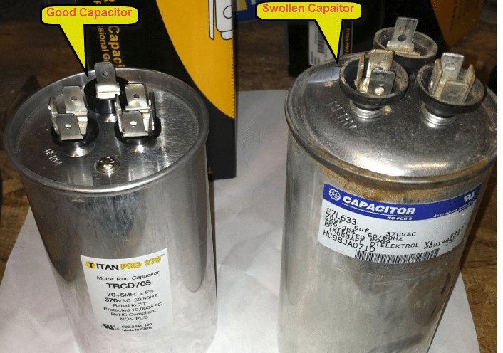

    I have great BS detector too, but the HVAC guy popped a fuse right in front of my face and played it off cool, like, "oops", and if it weren't for me having a Nest T-stat I pay attention to, I would've missed it and probably spent the money. Likewise with my buddy Matt who had an HVAC guy I'd used here previously try and install a new furnace. They're shiesty, or stupid, sometimes I'm not sure which.
    The capacitor should be easy to find. It's typically behind a panel on the corner of your condensor coil housing. Turn OFF the power shutoff that should be next to the ouside unit. Find the compressor. Trace the compressor wiring back, you'll probably find it goes back to one of the corners. Remove the sheet metal screws to slide the metal panel off that corner, or look for a trapdoor otherwise.
    Underneath it, you're looking for a silver tube like this --- DO NOT TOUCH THE TERMINALS OF THE CAP
    The top of the cap should be perfectly flat. If it's bowed/swollen in any way, it needs to be replaced. When say swollen, good cap's lid is perfectly flat:

    PS - every homeowner should have a replacement cap for their units on-hand. they tend to die within 5-10 years without fail, typically at the start of season in my experience. It's an easy thing to replace, just make sure you DISCHARGE the cap before touching the terminals, and take pics of the wire positions and the writing at next to each terminal so you know how to attach the wires on the new cap. These 'run caps' are what provide the energy discharge to kick on the compressor when triggered.

    Oh yeah. Already inspected that one and it's fine. Not swollen. I forgot that was one of the first things @FrenchToasty had me check.
