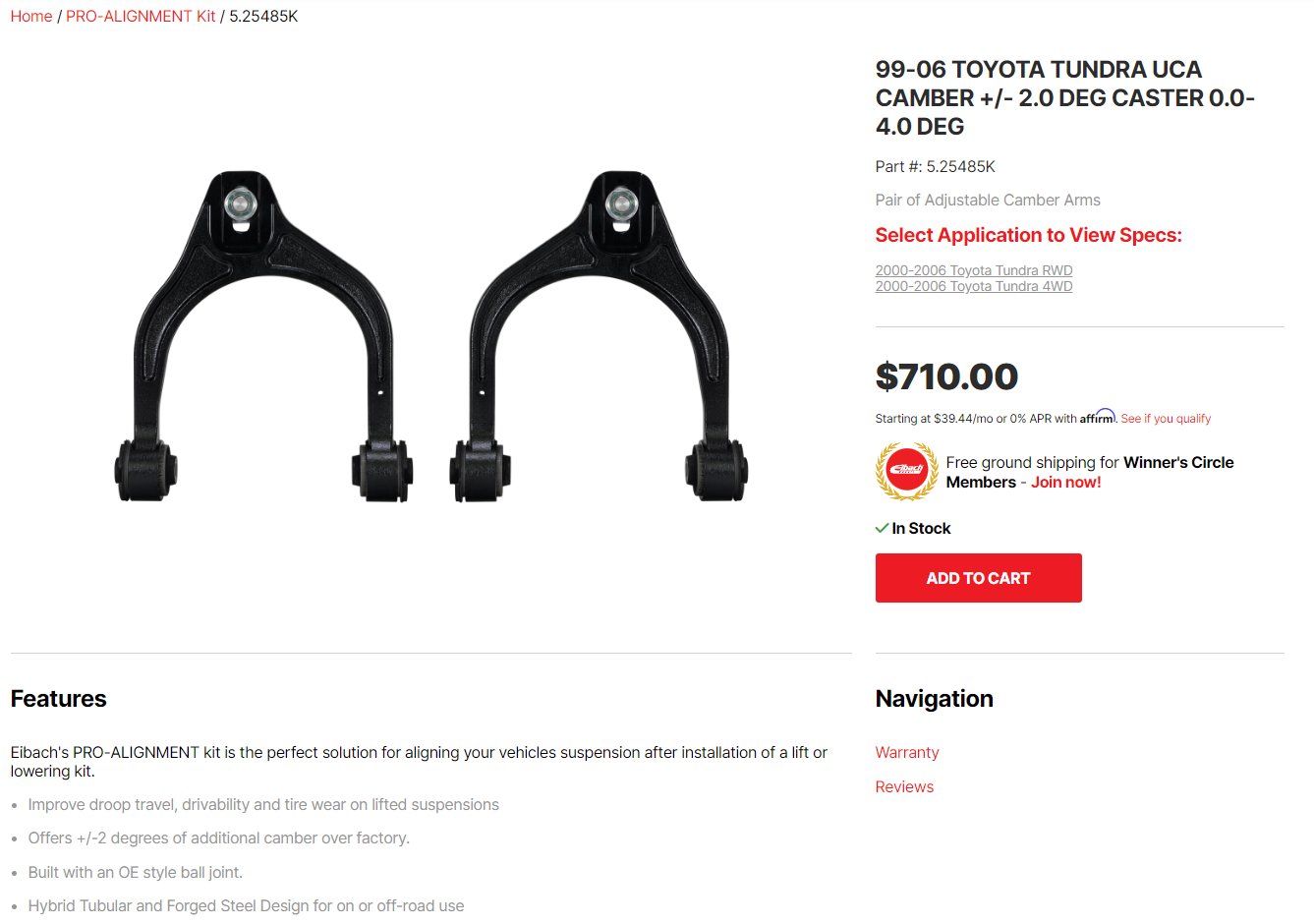

    Yeah, that's weird and neither looks right. But then again, even Eibach's page has been updated to show a different arm under that part number, so who knows.
  18. Mar 6, 2024 at 7:40 AM
    shifty`
    shifty` Smooth, like a hot comb on nappy-ass hair
    Jun 20, 2020
    #48239
    31,063
    ATL
    '06 AC Limited V8/4WD
    Note even on Eibach's page, they say "forged and tubular steel design". You see any tubular steel here, or any poly bushings? Right, IOW, their stock photo is wrong. This entire part in the picture is forged steel.
    Clearly it's still slotted, but Eibach's photos aren't accurate to the description. And I personally bought this EXACT kit, it was SPC.

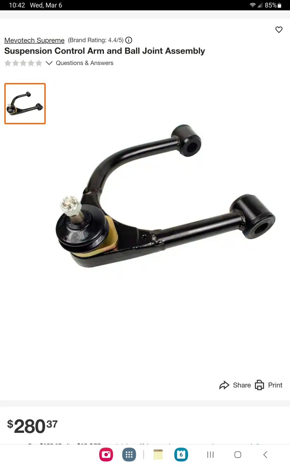

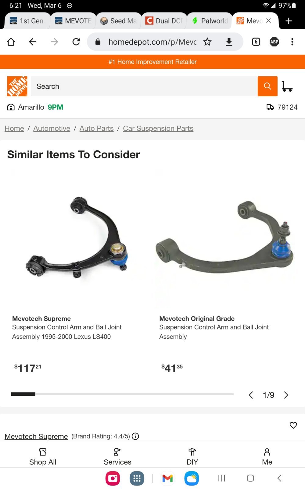

    They have em, I just left it at the top to get the home depot logo. Guess I coulda posted the link.
    https://www.homedepot.com/p/Mevotec...m-and-Ball-Joint-Assembly-CMS861202/311616324
