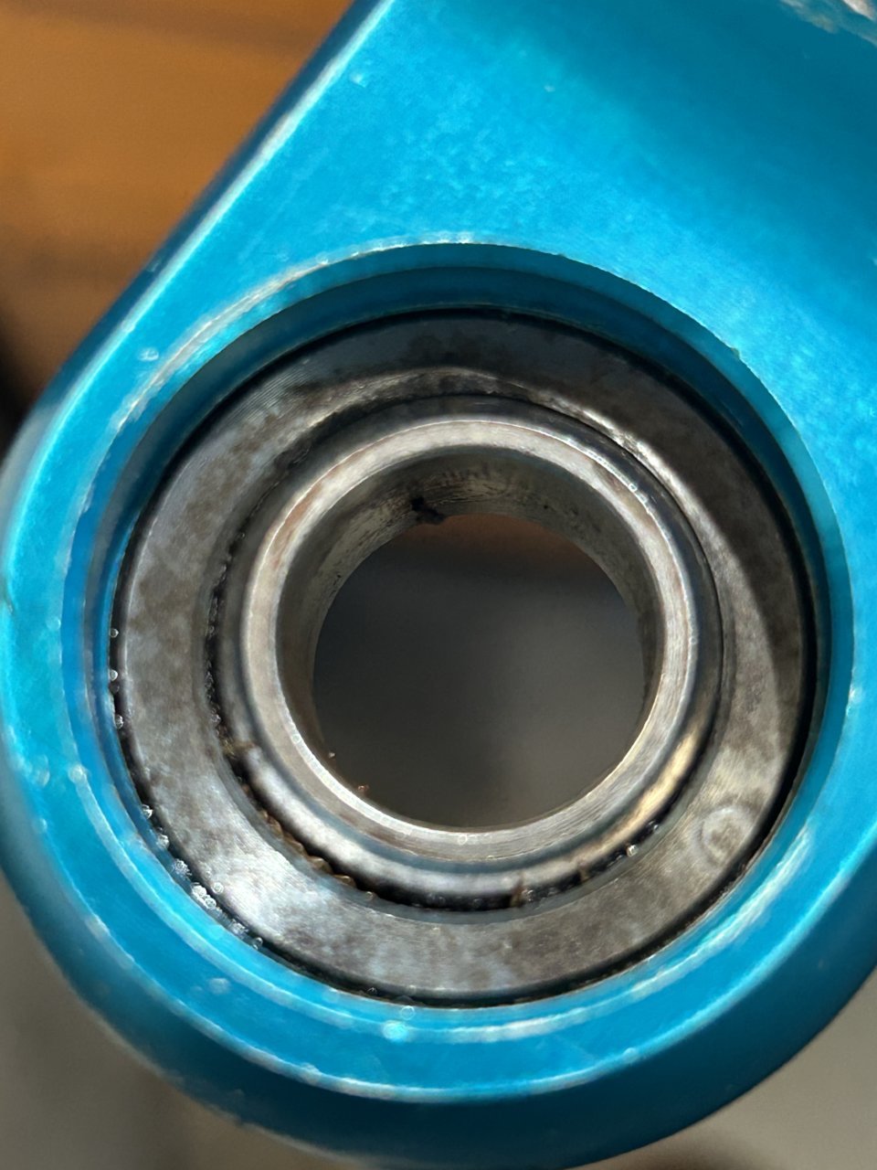

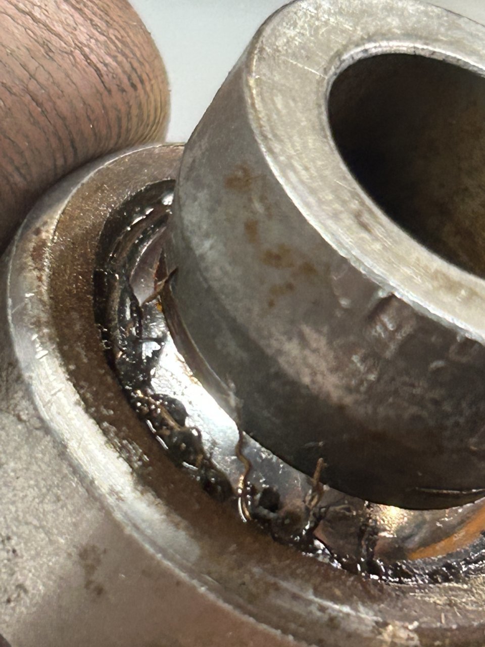

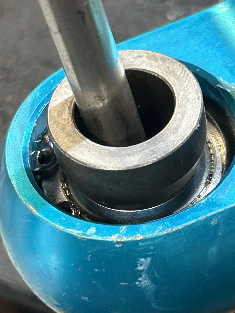

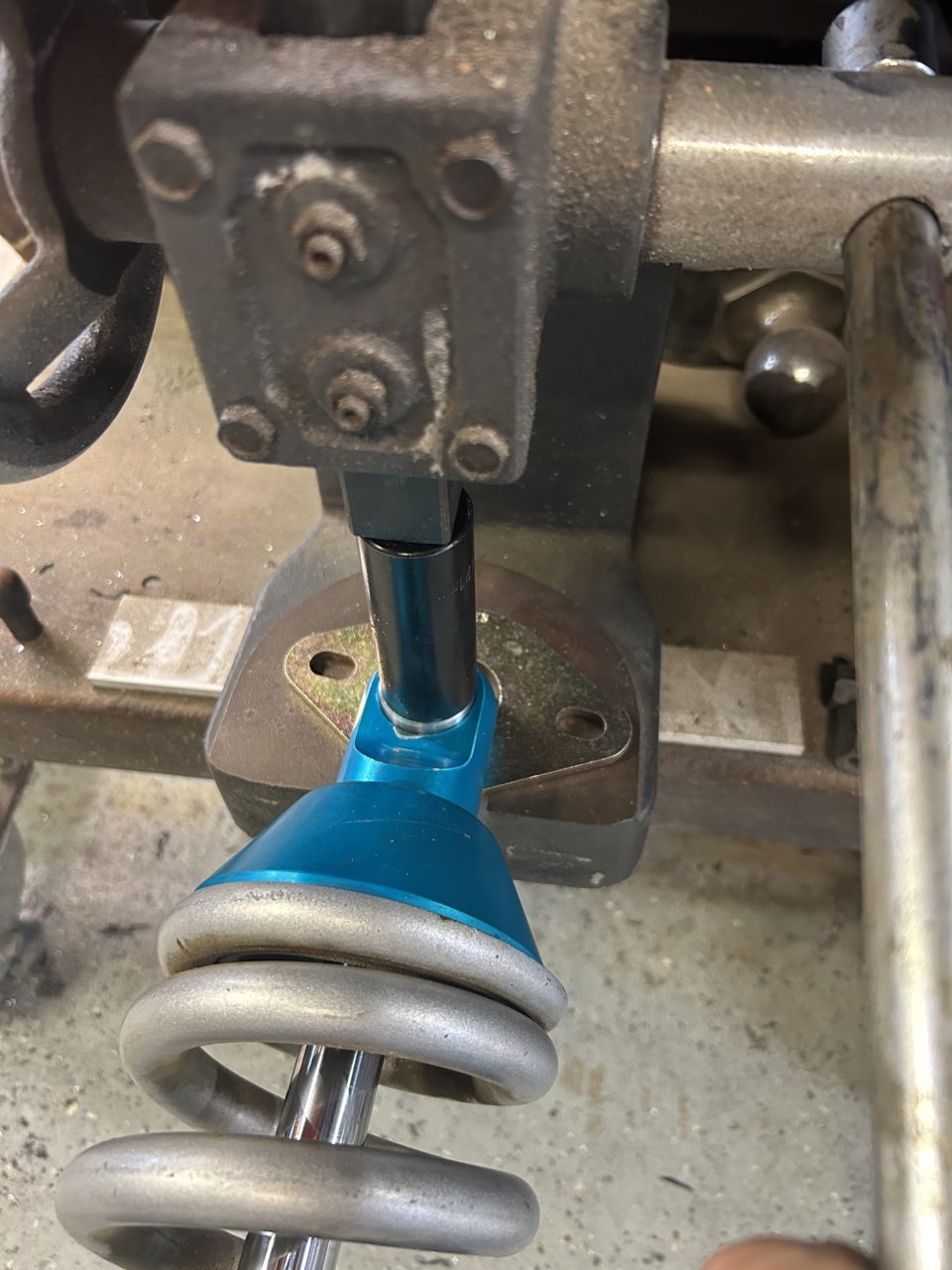

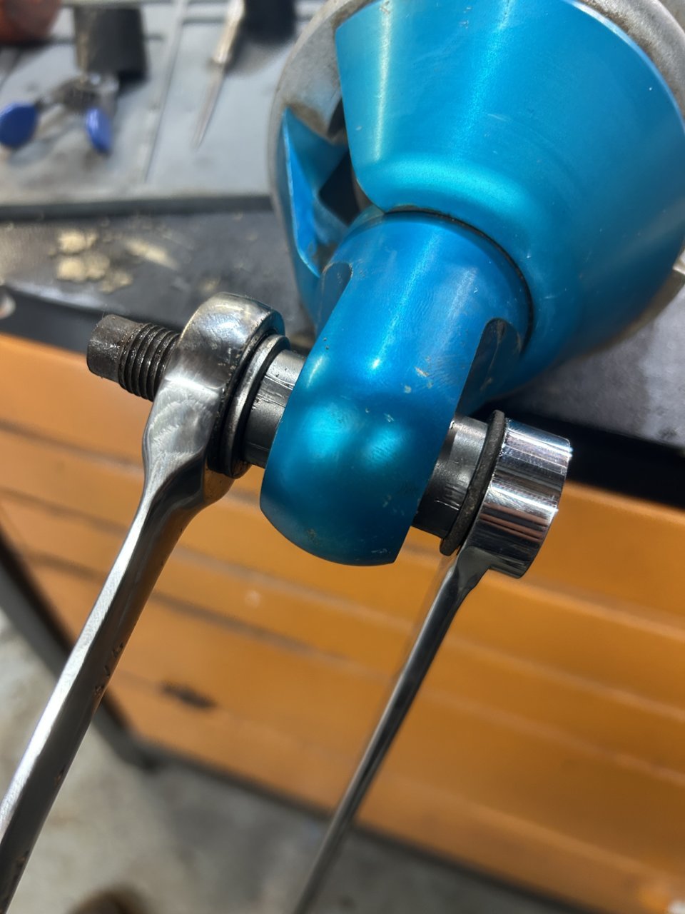

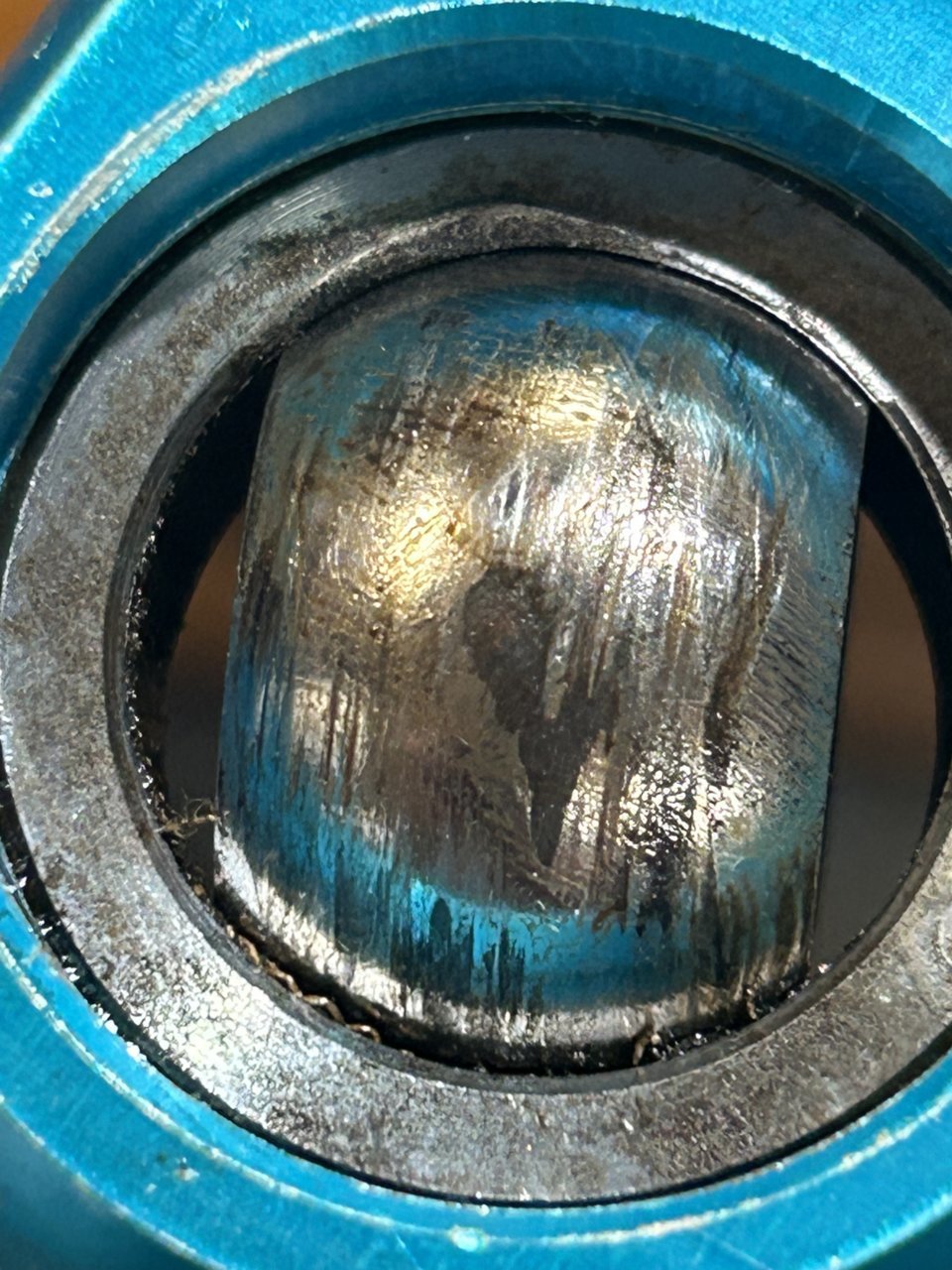

    It's good
    DC074DE2-BE7A-4A77-888A-B1C5BCCE7A7E.jpg DA26EC27-FCF3-45B6-98AA-2B352868D54F.jpg FBEEB7CF-C892-47DB-AD5C-6FAE6C4AD97B.jpg 30997744-2632-4971-9D23-CC3EED595B60.jpg
    Half ton press is fine. Gotta push a bit. I’m sure a larger vice would work as well. Or a home made bolt puller. Last spacers didn’t really want to go in so I used the bottom shock bolt to keep them aligned and ease them in.
