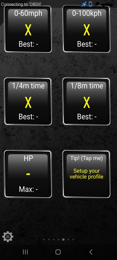

    Haven't done that yet, no. I've got the Torque Pro app which can measure different benchmarks. May try to find someplace flat to try it.

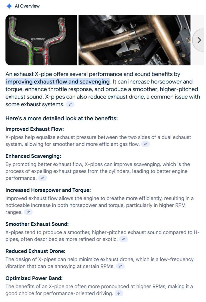

    I've seen the X-pipe on quite a few videos/YT channels I watch, never knew the benefits or reasons for it.... until right now.

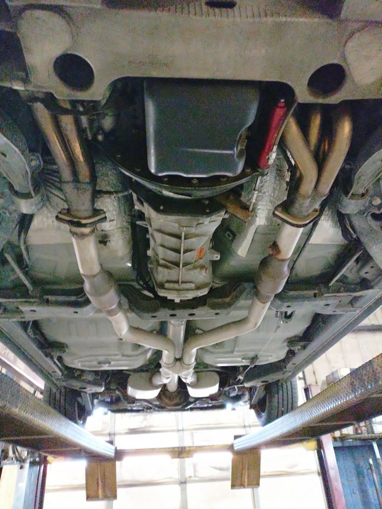

    Donut has headers, "cats", an x-pipe, mustang mufflers, and resonators right before the exit. Sounds good.

    That's pretty :rolleyes:
    I see the abandoned O2s hahaha.
    How does the ECM manage AF mixture, by engine temp?
    No rust on her belly.... :thumbsup:

    The O2s are up in the collectors. You can juuuuust see it on the drivers side. Funny thing is, They're Bosch wide bands for a VW Tiguan.
