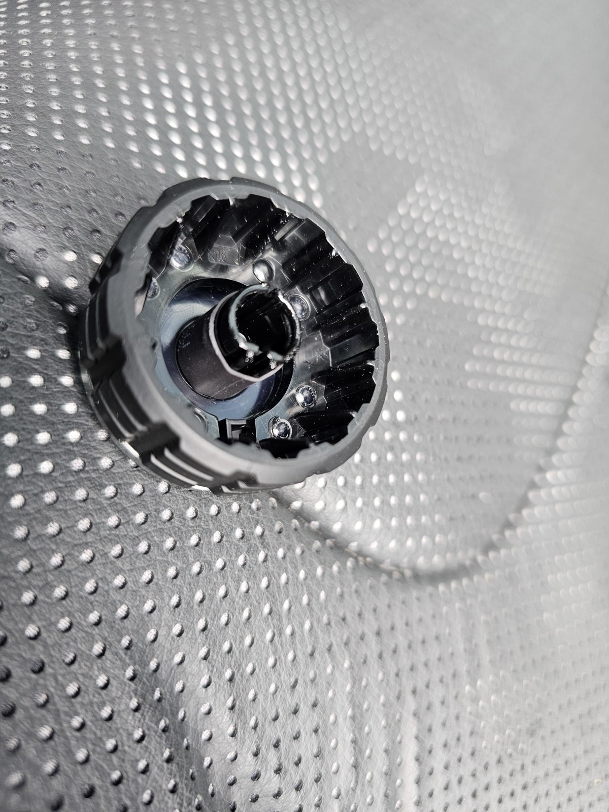

    I guess we can come up with something but its a semi circle with a flat side that grabs the knob

    I broke 2 within the first 3 months of ownership. Even with really careful use making sure I wasn't tweaking it to one side or accidentally bumping it, the second one only lasted a month. For now, I just resorted to dabbing some gorilla glue on the inside of the knob and that has seemed to hold so far (just over a month since last break)

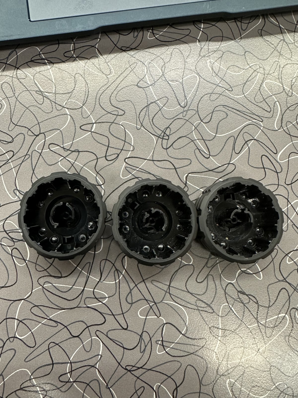

    i got a bigger collection!!!!!

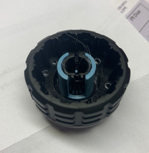

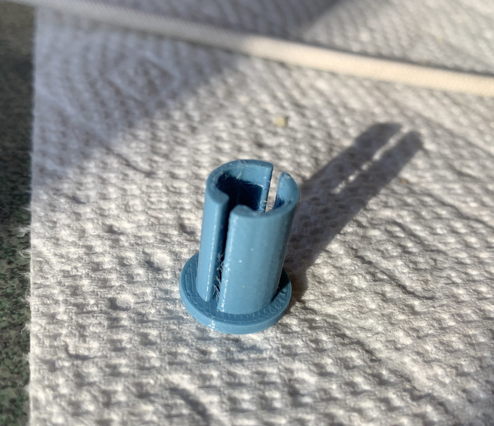

    Another update for you guys whose knobs haven't broken or if you haven't squandered your $200 yet ... I designed a little reinforcing sleeve that you can slide over and glue on the wings in the OEM knob to strengthen it. You can probably do this with glue alone, but the plastic provides a nice scaffold for the glue in addition to extra strength and stiffness. My OEM radio volume knob was still intact and looked OK, but I gave it the treatment anyway. If you do this just don't go crazy with the glue and smear it in the base of the knob and onto the translucent ring for the IP light. Just a little glue on the wings is sufficient. Use PETG, ABS or some other strong material. Photo below was before glue.
    It would also be fairly easy to design something like this that could replace the broken pieces to repair a trashed OEM knob. Just take the shaft gripper from my replacement knob and add a disc at the end to glue into the base of the knob. But I don't have a totally broken one to play with.
    https://www.thingiverse.com/thing:6229088

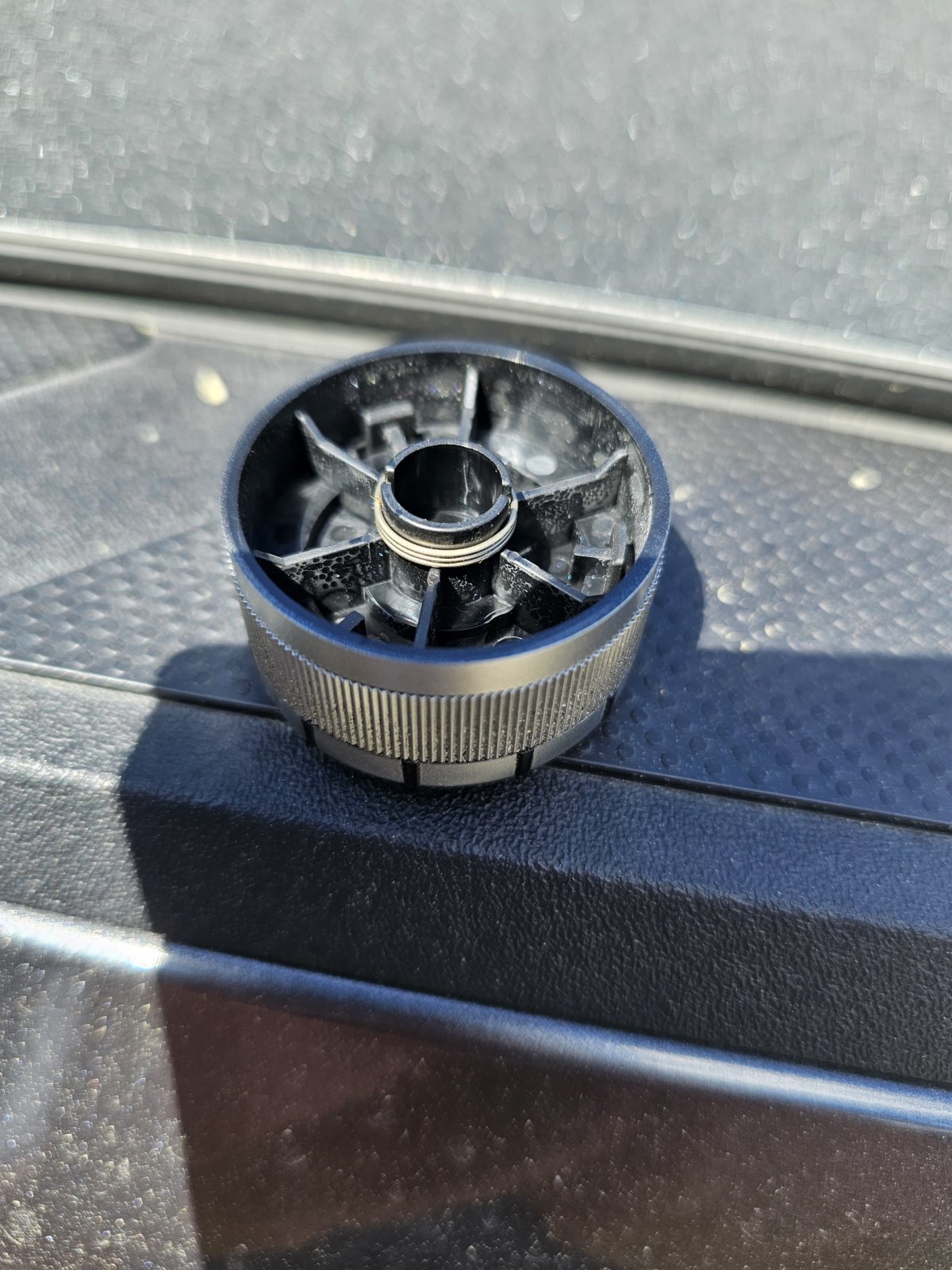

    Yet another update... I pulled out the part of the 3D print knob design that grips the radio shaft and made a stand alone part to repair your broken OEM knob. Just take a Dremel and cut or grind out the broken pieces in your OEM knob, sand the surface smooth, and glue in the repair part. Look for the file with "repair" in its name. Let me know how it fits and works. I don't have a broken OEM knob to test it myself.
    2022+ Toyota Tundra radio knob for 14" system by raylo32 - Thingiverse

    Brass sleave looks like it should have been used on the original one.
    Probably could get away with using any type of tubing the fits the OD of the shaft in a nice snug way.

    New part installed. Here is a pic with shrink wrap reinforcement in place. Time will tell if it makes a difference.
    I'll add that the replacement I ordered appears to have a attachment prong made of two halves, where the broken piece was four, so hopefully that makes it a little stronger on its own.

    What do you change the scaling to? I printed one based off your file with no changes and it came out huge! nice design just huge lol

    No scaling needed. Is your slicer set on inches instead of mm??
