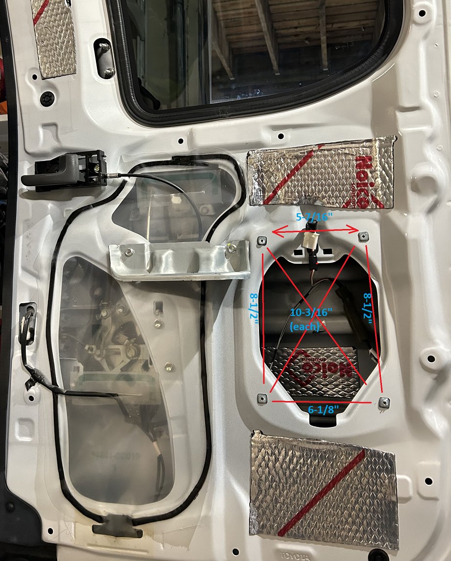

    I was absoluteyl thinking about this myself. I'd previously asked a couple other members to take measurements but never heard back. So when I had my rear door panels off recently to replace the vent window hinges and strategically sound deaden, this is what I found:
    • OEM baffle pael fires the rear 6.5s downward at ~30°
    • The plastic grid inside the door panel appeared form-fitting to line up somewhat with the speaker protrusion
    • It looks like there's enough depth inside the door to support a shallower-mounted driver, but stupidass me, it's the one thing I failed to measure (I'm still kicking myself), and it may require a little metal trimming at the top of the hole, I didn't have a 6x9 on-hand to test that theory
    • Otherwise, the measurements center-to-center* of the holes came out in this ballpark ( I concede possibliity of ~1/16" deviation here), which makes me think you could either cut a plate out of ABS and reinforce it, drill to fit there with your 6x9, or cut the OEM plastic piece to fit a 6x9...
    • ... but even if you did, the opening in the door panel itself is only ~7", and aiming the sound downwards so if you're using a coaxial/triaxial speaker, and that's center-posted, the door panel design may nerf the sound (If I can find a pair of donot panels, I plan to tinker)
    • Hope this helps!

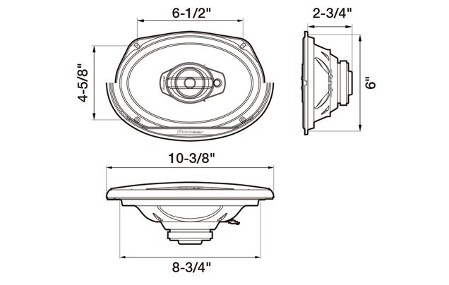

    And just to put that into context, here are some very, very generic measurements on a 6x9 speaker ... the main measure I'd be worried about, but you could work around, is how much the driver protrudes:

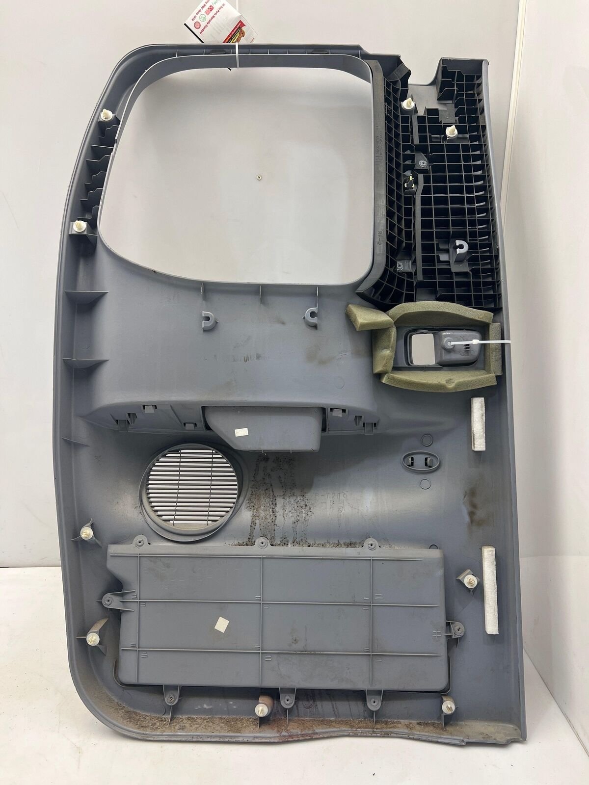

    And here's the back of the door panel, taken from eBay:

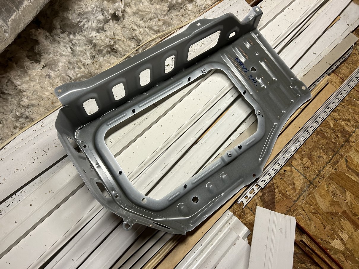

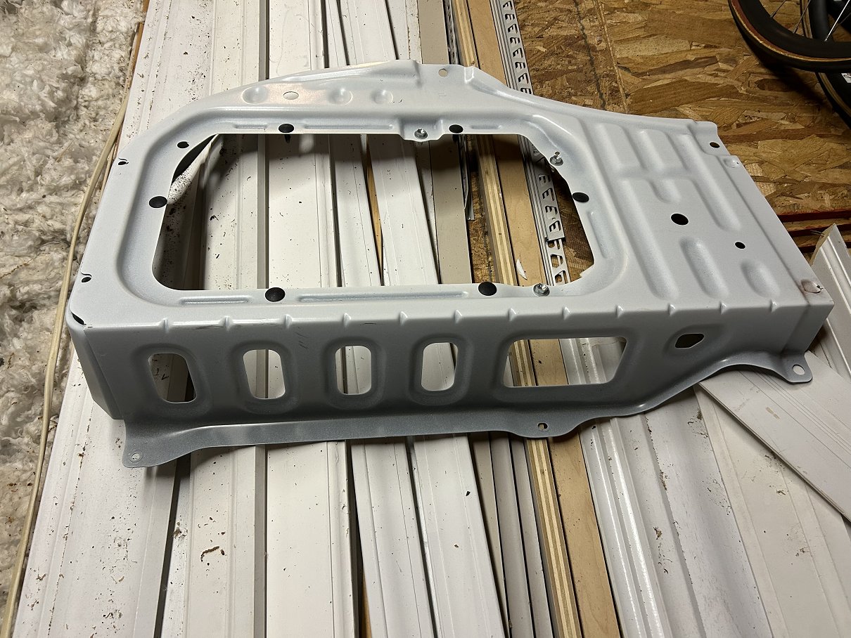

    Oh, here are pics of what your under-passenger-rear-seat cage looks like after you peel the carpet back, if it gives you any ideas for a design. It is extremly thin metal, like the door skins on these trucks (if not thinner), so it's not providing much structure per se. I wish someone made a plastic bladder you could blow into this bastard while it was installed, then use that as a mold to make an enclosure.
