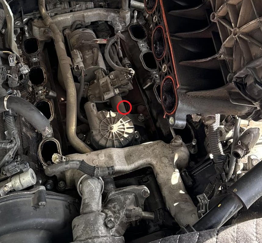

    40
    Where is the knock sensor located?

    Sucks! I need to get off my ass and do it too, but I've been wanting to look up the OEM part number for the harness and see how painful it is to replace with new. And I'd want to wrap it with rodent-deterrent tape before install. I basically want to refresh everything - sensor, that last segment of harness, I just don't want to need to go back under the manifold again. Hell, I'd be tempted to replace the SAI pump too!
    The sensor you're hunting is going to be in this spot where the red circle is but with the SAI pump and all the extra clutter in the '05-'06 trucks you can't see it. So I'm also posting another pic below this one of @bmf4069's earlier-year truck without the emissions crap to highlight its position.
    I bet the connector is loose, tab broke, or one of the wires pulled back. I'm sure it's just something stupid like that. IIRC, the computer sets the P0328 code specifically if it loses connection with the sensor for more than 1-2 seconds.
    And here is BMF's, you can see the bank 2/passenger knock sensor under the coolant crossover pipe in this pic too. But you're interested in bank 1, circled in red.

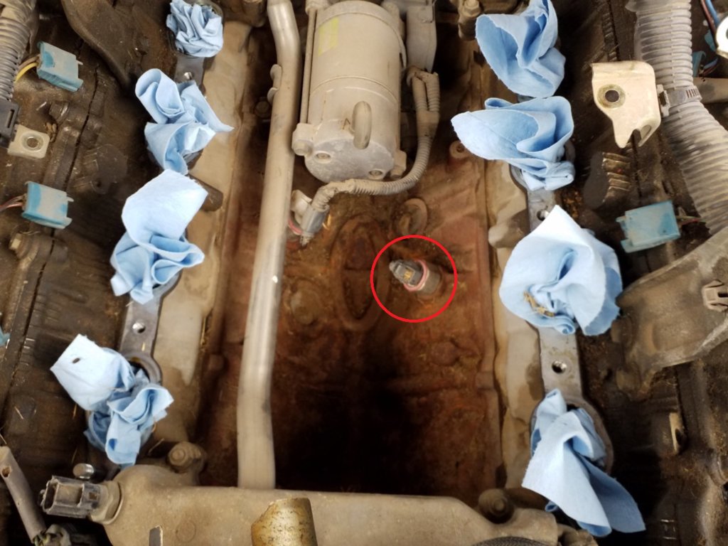

  10. Sep 19, 2024 at 1:17 PM
    #40
    Cthur
    Cthur [OP] New Member
    May 1, 2023
    #96406
    40

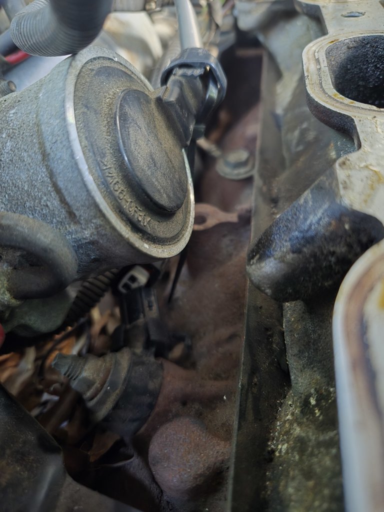

    11 mins off
    This plug was tucked out of sight and just completly not plugged in

  11. Sep 19, 2024 at 2:16 PM
    #41
    bfunke
    bfunke Tundra Curmudgeon
    Oct 13, 2019
    #37321
    2,701
    South Carolina
    2018 SR-5 CM 5.7, 2000 SR-5 AC 4.7L
    That looks like SAIS pump

    Nah look below still unplugged in pic
    Still have a p0051 code though everything seems to be comnect at o2 sensors, bank 2 sensor one( i assume is passenger side closest to header) do i just replace this sensor to fix that code? Wouldnit go bad from sittong for 18 months?

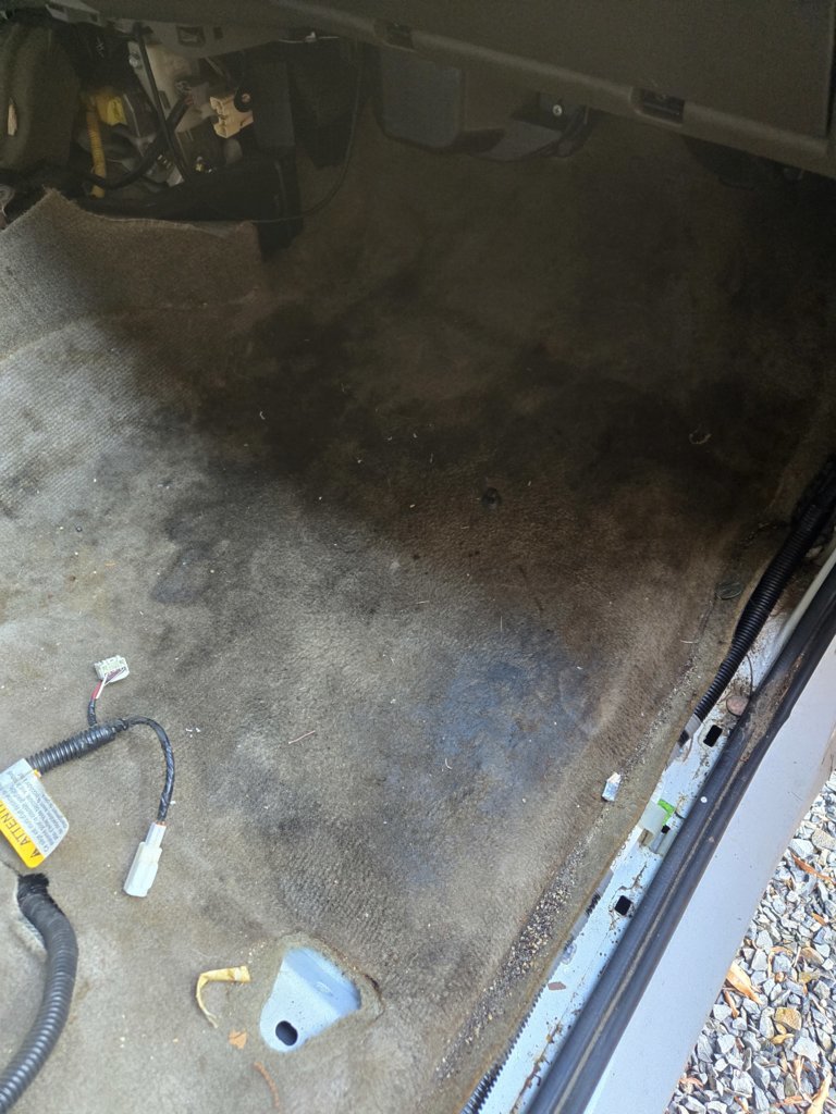

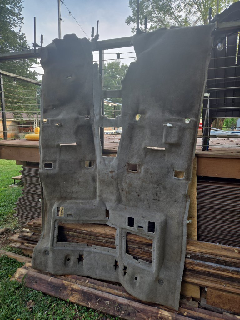

    Dirrrttty carpet from last 3 owners

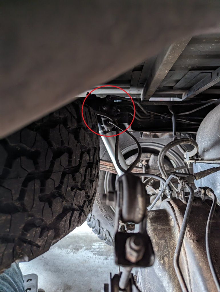

    I think the big thing for you will be re-bleeding the LSPV. Then dialing in the adjuster until the rear drums are basically barely dragging should get you there.

    Yeah i did lift truck 2" in front and 1.5" in rear as well. I just looked under and it def has that lspv still factory positioning

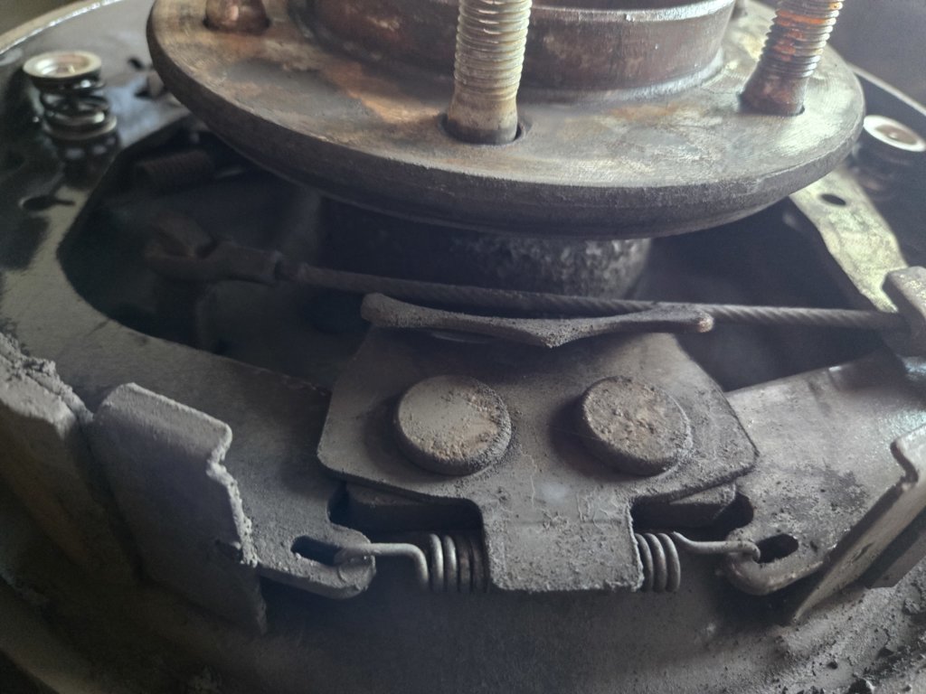

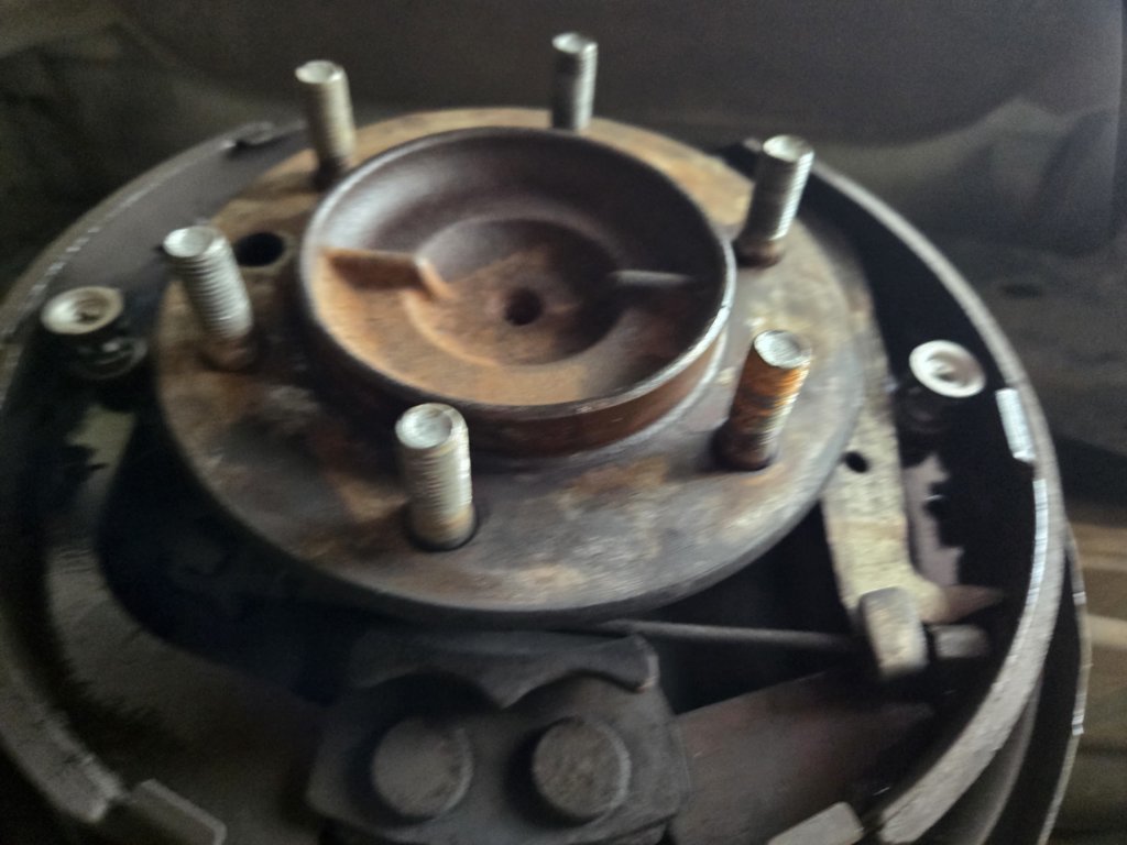

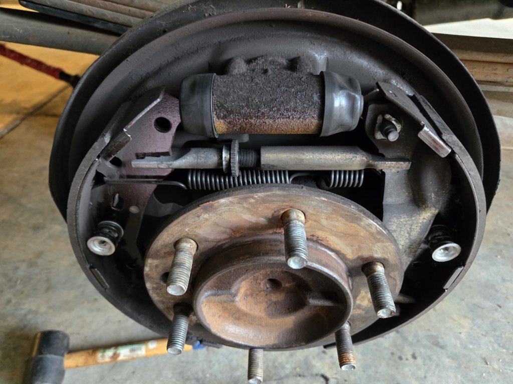

    Well i did remove calipers, dont see any issue there, it was grinding cause no material left. My rear brakes arnt doing anything.
    Just removed my drums and i dont see any thing installed incorrectly. It was very hard to remove drums but they didnt seem to be dragging at all when spinning in neutral in the air.
    Going to tighten them till they drag and then adjust the lspv

  27. Apr 4, 2025 at 4:06 PM
    #57
    Cthur
    May 1, 2023
    #96406
    40
    See pics

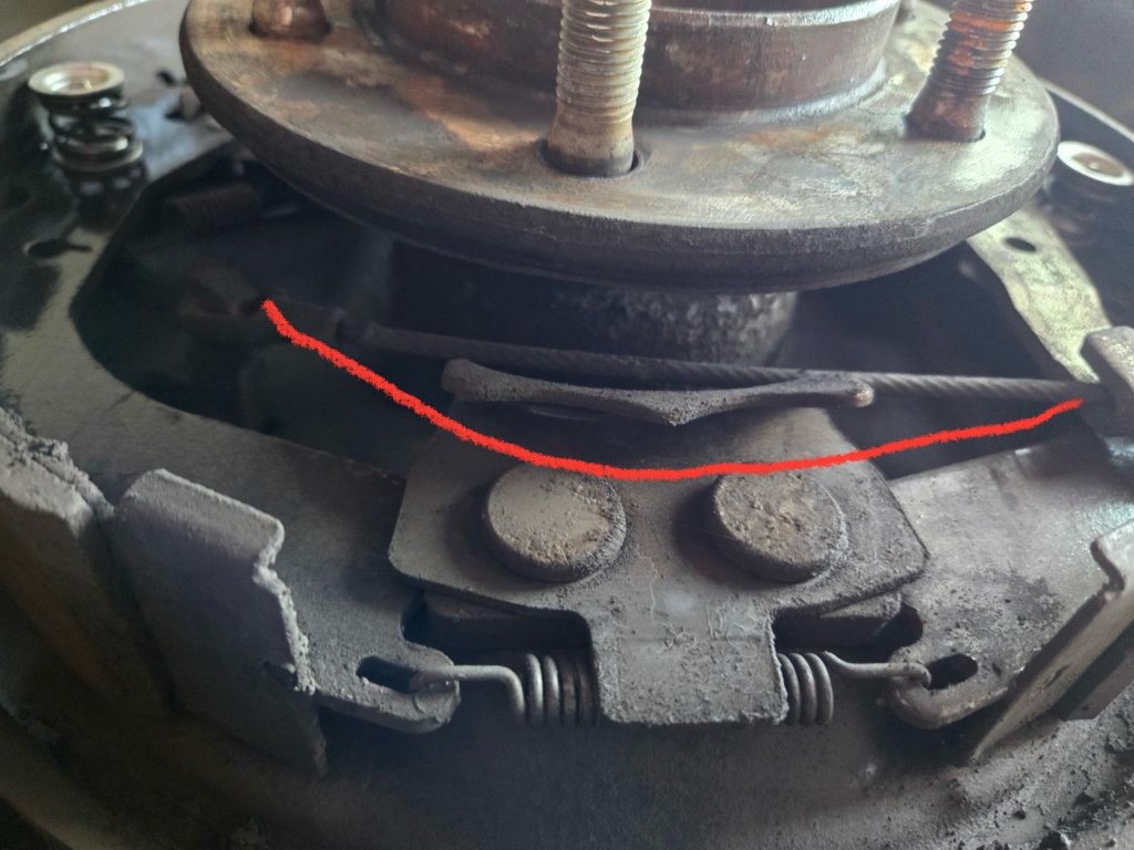

    Am I crazy or isn’t this cable supposed to be going inside the guide? That’s one problem I can see in this tiny ass phone screen. And that adjuster looks super far out to me considering how much shoe material you have left (tons). Also is that adjuster seated correctly? I can’t tell on my tiny screen. Is this passenger side or driver, can’t tell. I’m assuming the adjuster isn’t installed backwards. Is the wheel cylinder ok? The boot looks janky dry and twisted.
    Sirfive and The Black Mamba like this.
  29. Apr 4, 2025 at 6:05 PM
    #59
    Cthur
    May 1, 2023
    #96406
    40
    Okay well maybe it isn't correct, does anyone have a diaghram on how it should be positioned, that is passenger side.
    Should i just buy all new and start fresh?;
  30. Apr 5, 2025 at 7:48 AM
    #60
    shifty`
    Jun 20, 2020
    #48239
    31,487
    ATL
    '06 AC Limited V8/4WD
    I would start by trying to get things correctly installed, first and foremost. I wouldn't proceed until you're certain the brakes are assembled correctly. Maybe the video below will help you with getting that sorted? Note also where to apply grease, between the shoes and backing plate. I like Sil-Glyde for that.
    This thread has a lot of info in it on rear drum brakes and a couple of peculiar adjustments some folks have trouble with. Read it in full: https://www.tundras.com/threads/rear-brake-adjustment-theory-and-practice.99575/
    Also note, if you're lifted in the rear, and you haven't installed an LSPV relocation bracket, there's a solid chance your rears aren't even grabbing, or not as much as they should, but until you get them at least installed properly, with all routing correct, there's no point touching that stuff.
    I'd personally install a new Aisin wheel cylinder while you're at it, this is the part you need, one for both sides. Summit doesn't have in stock rn, I bet RockAuto has it. You'll need to bleed the rears (and LSPV) after.
