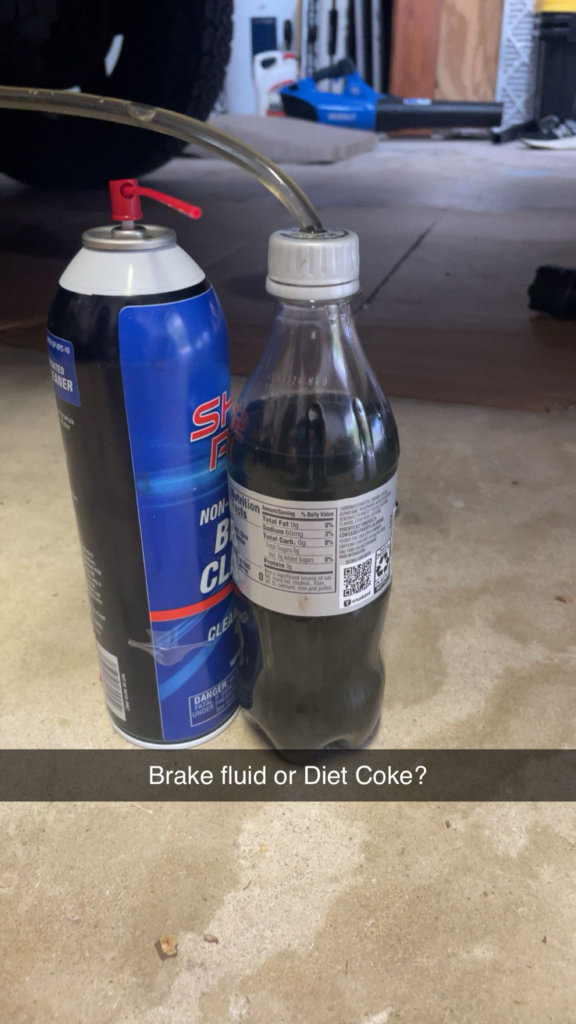

    Looking back on it the only stupid thing I did was let this go through the entire system…

    Ehhhh mine looked like that

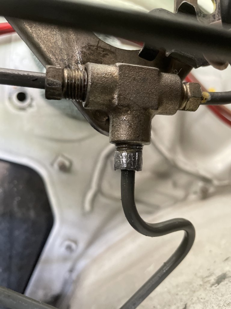

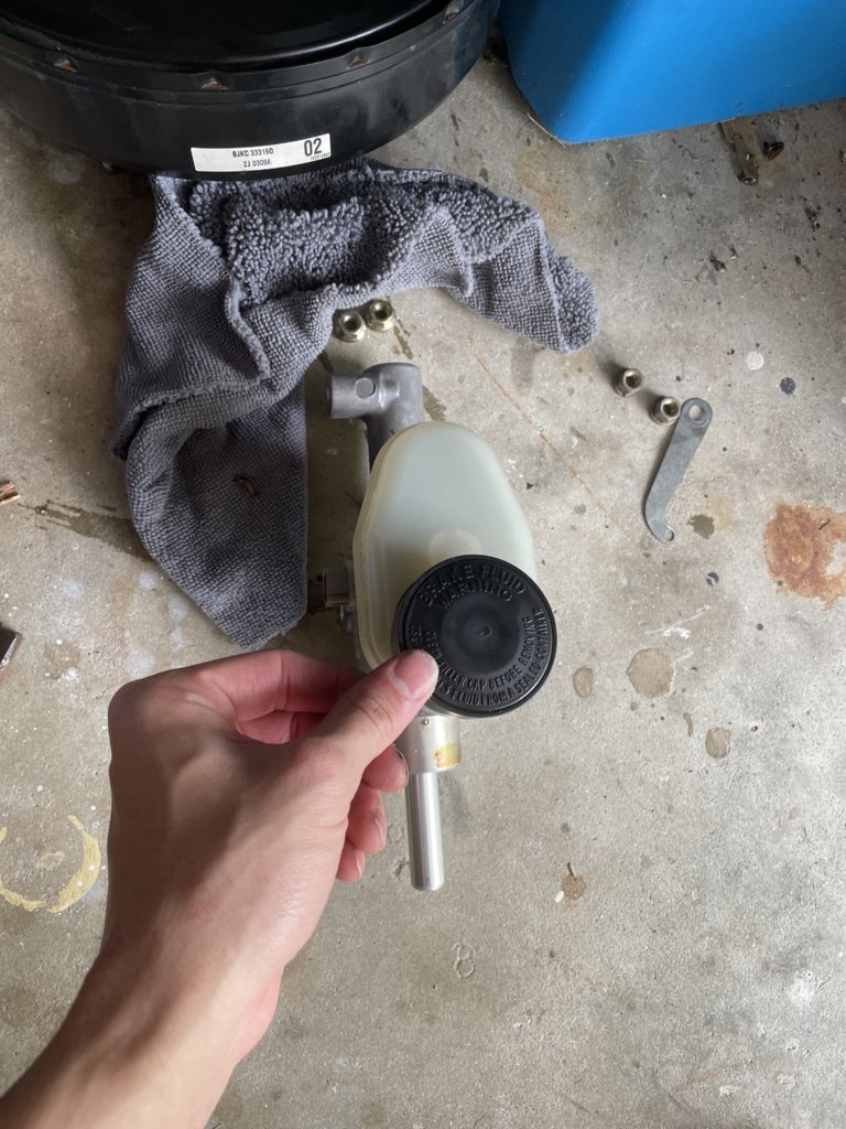

    So I took out the MC along with the Brake Booster and I’m pretty sure the MC is the issue. When I first took the MC, the piston was stuck in its depressed state. When I pulled it out, brake fluid was only coming out of the closest porthole out of the two. It was a relatively steady stream, but the other farthest porthole was not releasing liquid. I’m assuming that one porthole is intake other is outtake so I’d assume that’s normal.
    There was no leaks but the piston was stuck, so I’ll get another MC. I’m debating on whether or not to replace the booster as well since I have it out
    I also might have to replace a brake line since one of the bolts that holds it in place is stripped pretty bad, but I’m just going to keep track of it for now since it’s still on and see if it leaks when I finish up.

    Sounds like you just learned the hard way what we're always warning people about with 2-man brake bleeding: Don't mash the pedal to the floor.
    Slap your helper, then let them slap you, and move on.
