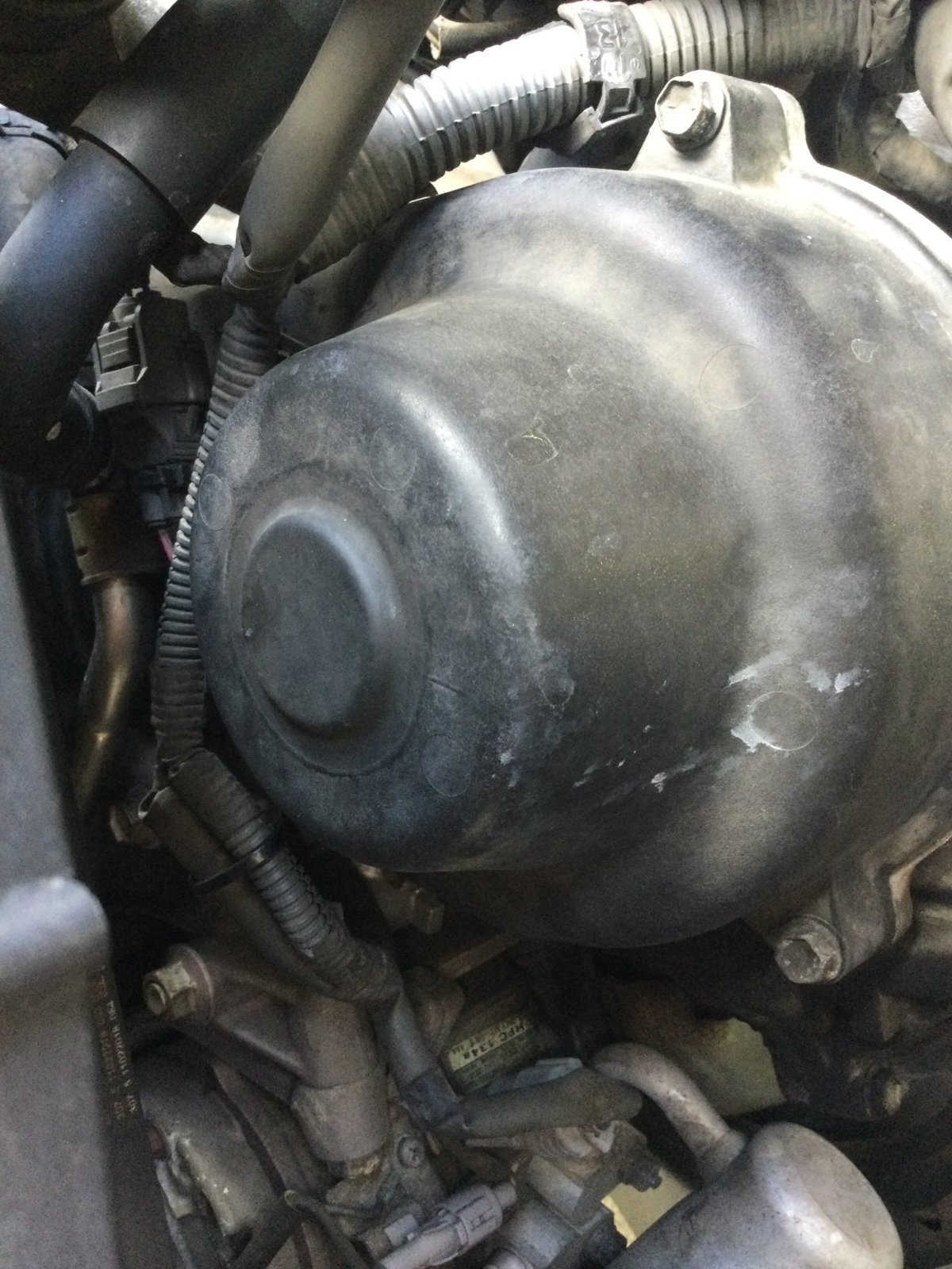

    I just picked up my '05 Tundra and found out the original owner has NEVER replaced the timing belt. The truck has 216K on it. So... it's either doing really well... or a time bomb ready to snap. Ugh. So... I'm trying to find the best bang for buck and quality service to get it changed. I watched a Youtube video last night on how to do it, and that's a job I don't have the time or patience for. lol

    It's the latter, a time bomb that will literally destroy the engine if it snaps. FWIW, mine has no service record of having it done when I looked it up at Toyota Owners website and at CarFax. But it has the service sticker and belt looks healthy, so someone musta done it?
    First thing I'd do is pop off whichever timing cover is easier and inspect the belt to see how bad it is. I'd use that info to decide whether I want to drive it or tow it for service. Unless you're comfortable with wrenching, there are several videos on YouTube for 2UZ-FE timing belt change. Order the Aisin kit with TB & WP here. RockAuto is a family owned business and a vendor on the forum, they give discounts to forum members (code is around here somewhere).
    You'll be pulling out the radiator for this service - now would be a good time to replace that also if never done before. Be sure to refill with Toyota red coolant, unless a PO f'ed up and put another color in there already, don't want to mix, flush first and then put the Toyota red in.

    I appreciate your information and feedback. I don't see any sticker in the engine compartment, and there's no mention of it ever being done in the Carfax report. I know the previous owner did not touch the engine as he said "I don't know to fix them, I always pay someone else to do them". So yes, I will have to find the easiest way to take a peek under the hood and timing cover to see what the belt looks like.
    I don't want to wrench it myself. I honestly don't have the time to do it, and would rather have someone else do it. One of the local Utah forum guys said he could do it for around $750. I called the dealer and they said it would be $1400. I know I can buy the belt and water pump for around $250. So... I'll have to figure this one out.

    Timing cover is only held on by four or five 10mm bolts and requires nothing special to back a couple off, then pull back the cover. Easiest way to look.
    $1,400 at a stealership is actually not that bad. A lot of that is them upcharging for OEM parts. My nearby stealership was a couple (few?) hundred more. Be sure to look carefully at your crank position sensor harness after to make sure it was tucked away properly and won't get tapped by a pulley or belt after the work is done.
    Cheapest I've found at a shop with actual Toyota techs who know the 2UZ inside and out is $1150. I think anything in the $950-$1150 range that's guaranteed work, that's worth it. Knowing the cost to replace the engine if not done properly by someone that you have legal recourse against ... I'm OK with paying a couple hundred extra.

    I would 100% do it if I were you. If you read back on my older posts here, mine snapped. The guy I bought it from said it had another 40k miles before it'd need replacing. Listening to him was a big mistake. Mine snapped on the way back to SD from LA in the left lane of a big highway. That was interesting. Had to replace the engine and that's never fun. Definitely do it ha

    I found a Toyota certified guy here in the greater Salt Lake area who offered to do it for me. $250 in parts is better than the $500+ in parts from the Toyota dealer. Much appreciated for him offering to squeeze me into his schedule.

    Timing belt and water pump completed, as well as cam seals, spark plugs, and new fluids. He says rear seal looks good. Serpentine belt and radiator (and hoses) were done last year. So hopefully I'm good for awhile engine wise. :). Has new shocks all around, new tires and rims, but brakes are a little soft. I might need to pads and/or rotors.
