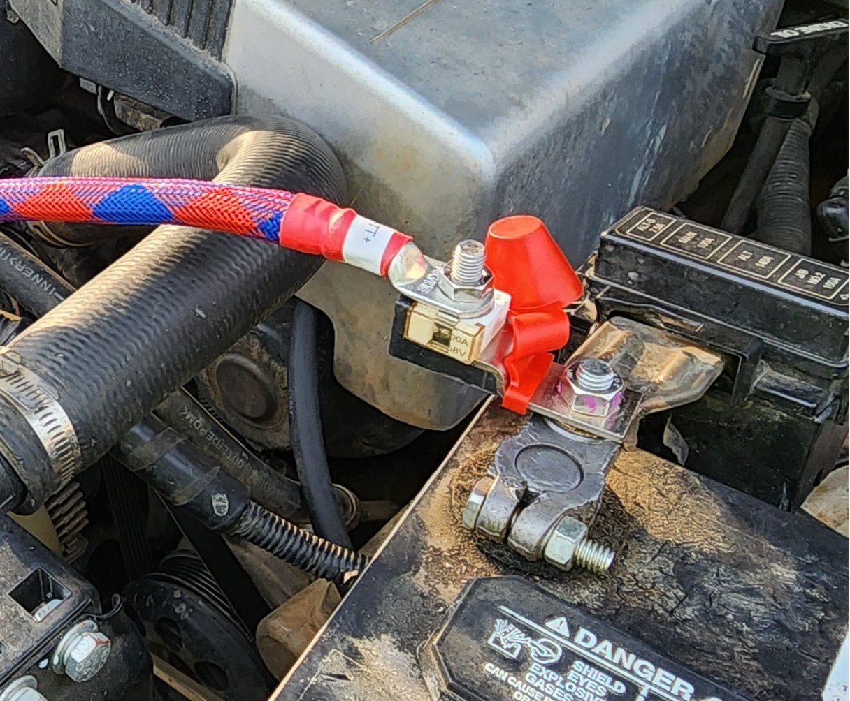

    Gentlemen and Ladies....Please Fuse all your positive cables..always..
    This is for when you skip the Factory Alternator to Fuse box to Battery + cabling and Wire straight from Alternator to Battery + terminal
    the above Post where you are not using any fuse for the cable going from your positive line Alternator to Battery Pos...it is a Bad bad bad thing waiting to happen. The reason you use a fuse is so that you stop any shorts from happening and causing a Fire... what happens if you get into an Front end accident and your NON fused Positive Alt-2-Battery wire broke and now touches the vehicle frame or anywhere on to ground?? ---> Answer is this creates a "Short" casing the wire to heat up and eventually i.e. in seconds heat up and start a fire. Also hope the fuel lines didn't get damage in this accident.. Ok thats a bad scenario.. This is EXACTLY the reason to FUSE this positive Alt-2-Battery + cable.
    Additionally where would you fuse it? as close to the battery + terminal as possible. I did a big 4 upgrade on my Land cruiser (130A Alt) and I had a MRBF fuse right on top of the battery. Here's how my fuse is setup shown below.

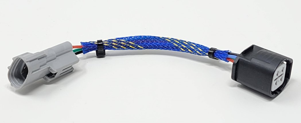

    Self plug - For those who are looking for a easy 3-to-4 pin Alternator Upgrade connector I sell one... 3-to-4 pin connector Please ping me on here and I can ship one out...at the price on the link.
    BTW Mod's if this is not allowed please remove this post.

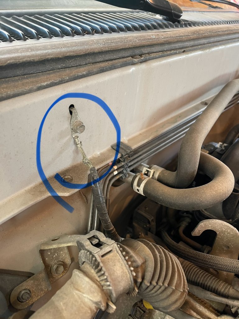

    Anyone that has done this upgrade or knows the location, would you confirm where the motor is block is grounded to the chassis?
    Only thing I’m seeing is this on the back of engine bay.

    Yea, i'd have expected a large braided ground, but i just saw this wire connected to the rear of the pass side head. 2002, dunno about gen 1.5's.

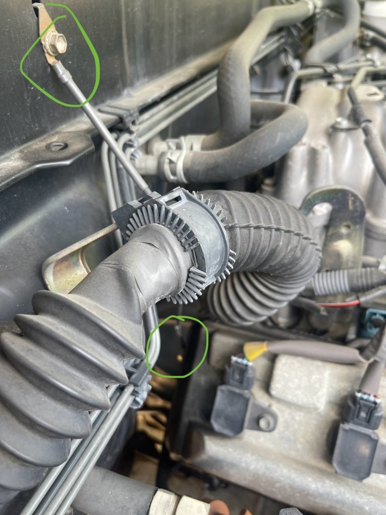

    There's another ground (at least one) that laps from the battery, around the front of the engine, I think? And one from the battery to the fender wall. Maybe one more?

    I upgraded the battery to fender wall. Need to look and see if there is one coming off the front of the engine.

    Someone posted a graphic of the engine bay grounds. I swear there's 4, maybe 3. Hell if I can find it now. Maybe it's in the EWDs that are linked in the 'so you just bought a 1st gen tundra' sticky thread?
