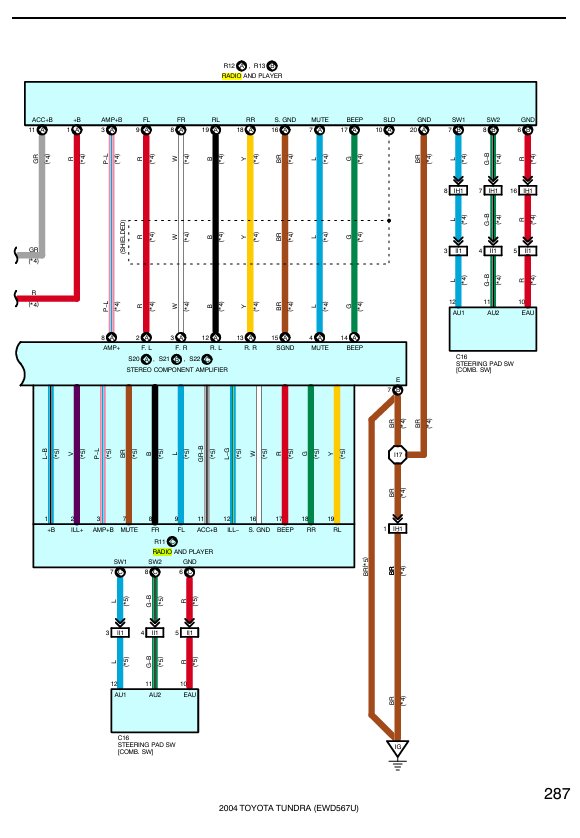

    Anyone got the color code/pinout for an 04 SR5? I can find ot for almost every year but mine.

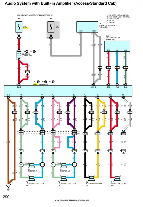

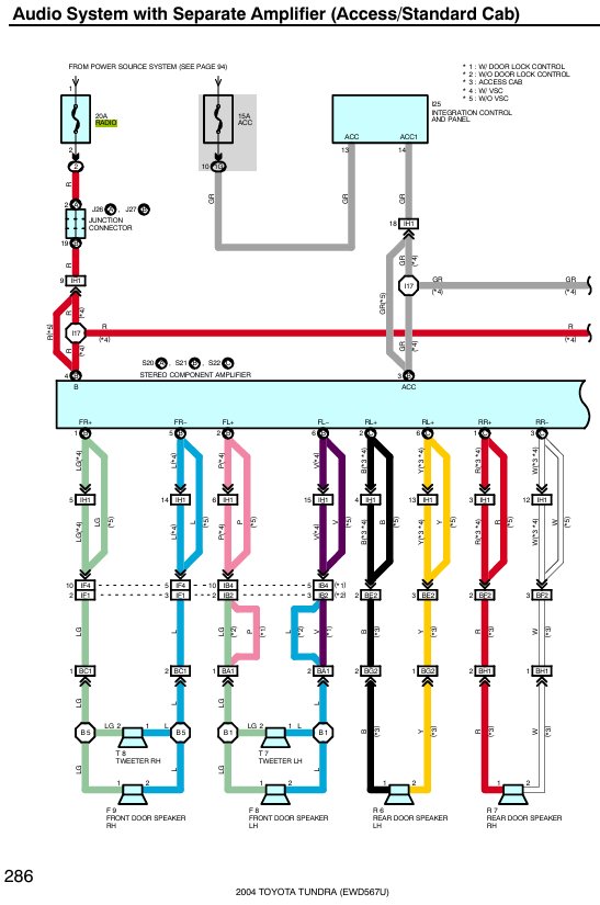

    @D.doherty377 everything you need is linked from this thread, service manuals and wiring diagrams are a few sentences in: https://www.tundras.com/threads/so-you-wanna-buy-just-bought-a-1st-gen-tundra-eh.115928/
    TRUST ME ON THIS:
    You're going to want to read the "Audio, audio upgrades and cameras..." section in the 1st reply of that thread, I'll link it again for you: https://www.tundras.com/threads/so-you-wanna-buy-just-bought-a-1st-gen-tundra-eh.115928/
    The fact you're asking for "SR5 model" and ignoring there are wildly different installations for access cab, regular cab, and double cab alone, forget about the fact your access cab has no less than two possible variations that use totally different pinouts...
    Seriously. Read that section of that thread. BEFORE you start cutting wires. BEFORE you order things you can't use. BEFORE you even think about getting started. We've seen too much stupid shit at this forum!

    Main reason I point out the cab thing and I'm taking a minute to warn you:
    • You need to figure out if you have an OEM amp BEFORE you try to update audio, unless you like surprises/headaches
    • Not all 1st gens use OEM amplifier, so figuring out if you have one before you unplug anything is important
    • OEM amp location varies (if present):
      • Earlier years and regular cabs: It's in the dash
      • Later years acces cab: It's under back seat, passenger side (if so equipped)
      • Later years double cab: It's behind back wall cover, driver side (if so equipped)
    • Amp brand varies (JBL or Fujitsu), and each brand has its own harness
    • The JBL-equipped trucks use 6 channels, 2ohm per channel, which can fry aftermarket head units (this is one of a couple "AHA! Gotcha!" pitfalls to these trucks)
    • OEM amp needs to be bypassed (ideal) or adapted/ported (not ideal) if the vehicle has it
    • If you choose to adapt/port the app, depending on your kit, you need to "prep" the OEM amp (for JBL systems), like the PAC brand kit wants you to pre-set the radio to 3/4 volume with key ON before you turn OFF the car and install their kit
    Look dude. I'm not telling you this for my health. I'm giving you fair warning to not make dumbass mistakes we've seen other people make on here.
    And that's my last word on it, take it or leave it. Seriously, if you have questions, ask. We can save you a shitload of hurtin'.
    PS - Whatever you choose to do, adapter harnesses for any of the three system variations outlined above - i.e. no amp, JBL amp, Fujitsu amp - only cost $8-15 depending whether you go w/ Scosche or Metra. We've seen more than one person come through here asking for wiring diagrams because they intend to cut the factory harnesses to install their aftermarket stereo. That kind of behavior is reserved for assholes, hacks and cheapskates, knowing how cheap the adapters are, if that's the current plan of action and reason behind wanting the EWD for your truck ... dude, don't be that guy.
