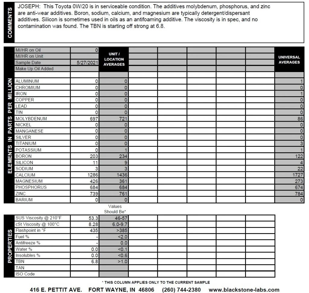

    5k OCI vs 10k OCI isn’t so much about metal wear IMO - it’s about sludge. If you think oil with a flashpoint of 380 is doing great - I don’t know what I can say. You didn’t get a TBN to determine how much, if any, life that oil had left.

    What's the flashpoint of new oil?

    It’ll depend on the manufacturer and weight but should be in the 400s. Mobil1 5w-30 came back at 480.

    I found a virgin oil analysis of Toyota 0-20 for comparison.
