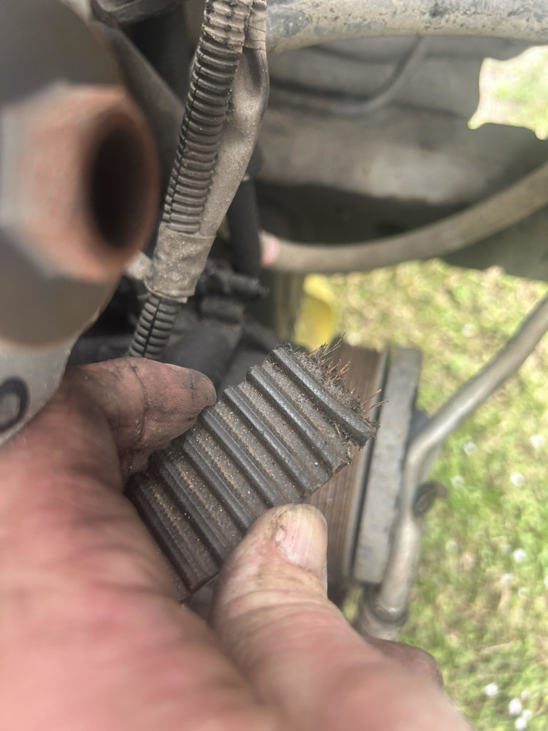

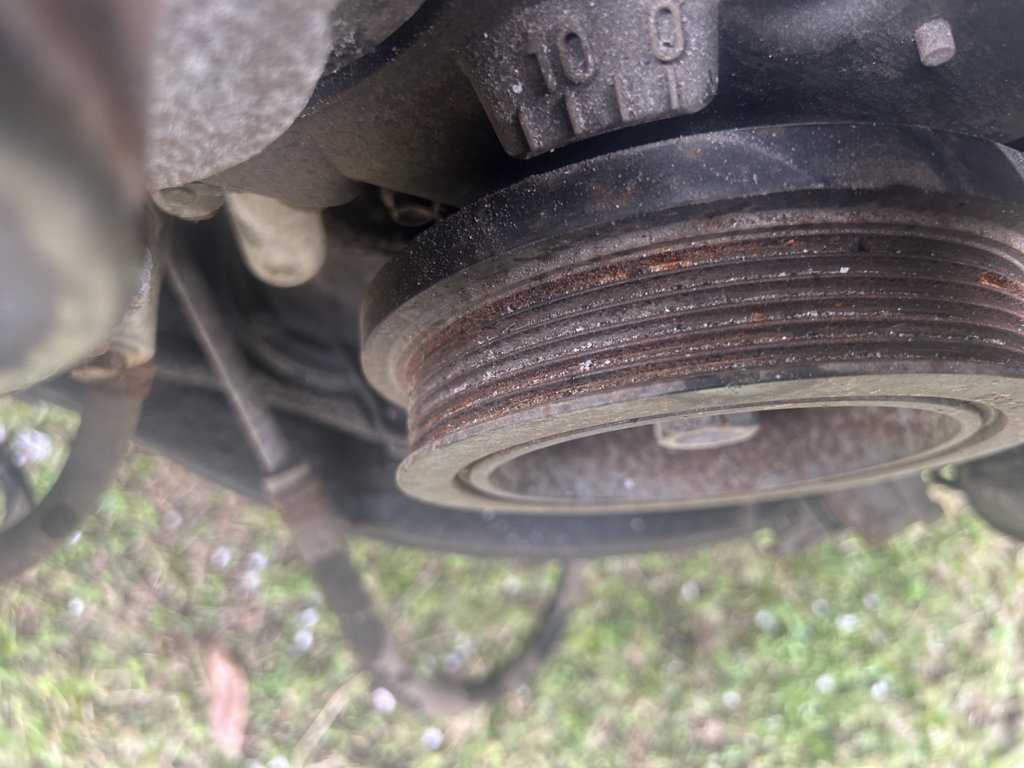

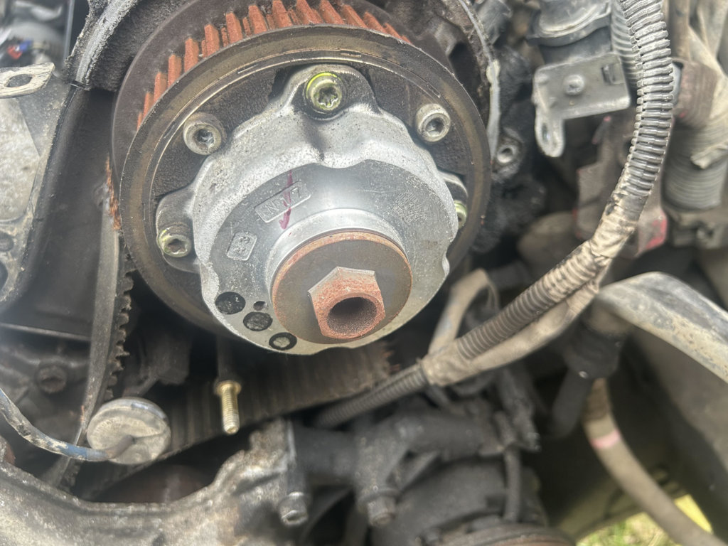

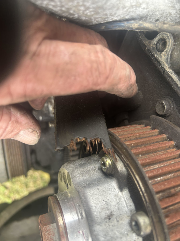

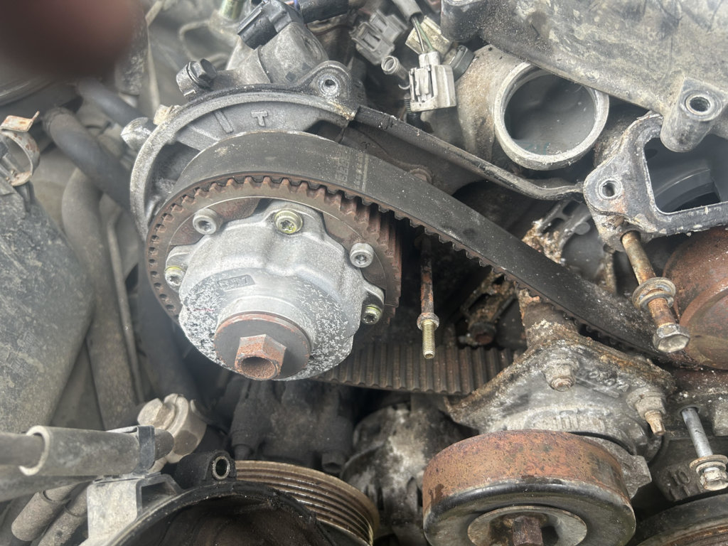

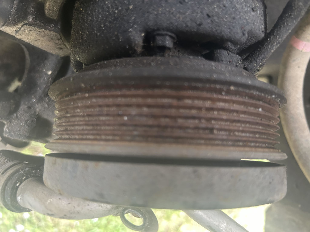

    I took the front apart today, radiator, fan, WP, covers, etc. Found the belt. It was still on the pass side cam. Looks like it ripped a piece off on the drivers side cam. I brought the crank up to TDC. Turned DS cam to timing mark. Turned PS cam and stopped dead. UT OH!! push a little hard on it and SNAP! I guess a valve was stuck. Turned it to timing mark. I'm not sure on this. I'm having second thoughts. The drivers side cam, the only marks I could find were VERY faint. I think what Im seeing is the mark, but I'm not 100%. There is no indentation or line or dimple anywhere. Pass side has a indented line, so I know thats right. I'm gonna go ahead and order this kit, but I need a little guidance on setting this thing up. Should I turn these cams over a couple times, to make sure their free???

  29. Dec 30, 2024 at 2:24 PM
