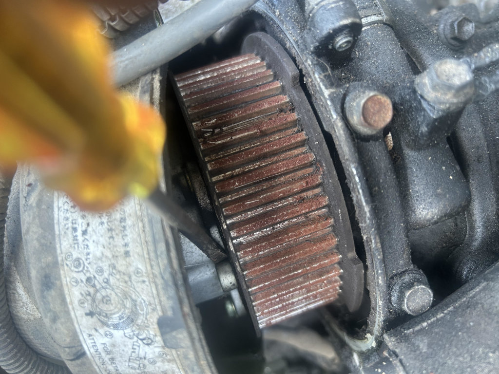

    I went out first this this morning and removed the drivers side cam cover. This is what I found.toy20.jpgAin't looking good for the home team. What's my next move? Is there a way to see if engine imploded without a complete teardown? Or should I just look for another engine?

    Ohhhhh F!

    Gotta get the heads off and see if it played whack a valve. You could still get lucky if it wasn't turned over

    Id get a cheap bore scope, snake it around the plug holes and take a look at the pistons and valves. A lot less work than pulling the heads.

    so this being an interference engine, the valves are the only thing that could be damaged? Or is there something else that could of took a hit??? And pistons of course?

    The valves can be bent, the pistons can be scarred, cracked or broken. The rods can also be bent, which can in turn damage the crank as well. Most common is bent valves and scarred pistons. Bent valves won’t operate properly and cause loss of compression. Scarred pistons can get hot spots at the damaged areas and lead to cracking and breakage of the pistons. Could also cause scarring of the cylinder walls if any material breaks loose.

    This is the most likely reason it wont turn over, there are valves touching a piston, so the piston cant get back to TDC to allow the engine to roll over. The new starter you bought wont do anything. You would be smart to get a bore scope and look and see what the insides of the cylinders look like, you might get lucky and roll the cam gear back and get the valves off the piston and then be able to manually roll the engine over to confirm its not locked up. You might get super lucky and put it back in time, put a belt on it, prime the oil up and it fire right up. AND you might also get unlucky and have a boat anchor.

    Timing belt isn't a ton of $$$ to buy, it's just time to install and get the timing right, and see what you're up against. We've had people pop a timing belt in this very forum and the engine survived enough to operate.
    If for nothing more than shits and giggles, I'd be tempted to get a timing belt and new tensioner (since rewinding the old one is tedious and you don't know its state, if it caused the snap) and install it. If you're ONLY installing the belt ant tensioner, you're only looking at 3-4 hours work, IMHO, to pop on the new belt and tensioner then set correct timing (use that thread I gave as a reference), and see if it runs. And that may save you a solid thousand or two on an engine.
    Given you have no f'ing clue how many times someone tried to turn it over or what they did, there's a solid chance the engine is toast and if it does run, it won't function properly. But miracles happen, and if I were dropping money into anything, knowing you could simply pull those parts back off afterward and use for your next t-belt change, it seems like a no-brainer. You don't even need to use Aisin brand parts (OEM), you can use the cheapest you can find if only to test, knowing you'll want to change everything later. There's also a chance it runs, and runs properly, if the engine wasn't turned over excessively while the cams weren't moving.
    That said, if you need and/or want to just forgo all the BS and swap a new engine in, there are some tidbits you need to know. Consult with the forum before you go that route. For trucks 00-04 you need to stick with 04 or earlier motor. On many of the earlier years, there are pins to swap over for the throttle body assembly, if I recall, which will give you grief unless you swap your throttle body assembly over and use your truck's harness. On the 05-06 you just shop in the same year range, it's pretty cut and dry, but if you're pulling the donor engine from a Sequoia '05-'07, there are considerations there too ...
    Anyway, yeah, this is why I was warning you about checking the timing belt very, very early on in this thread. It's the one thing that would motivate someone to sell in a no-run condition, where they could feel safe to claim ignorance later.
