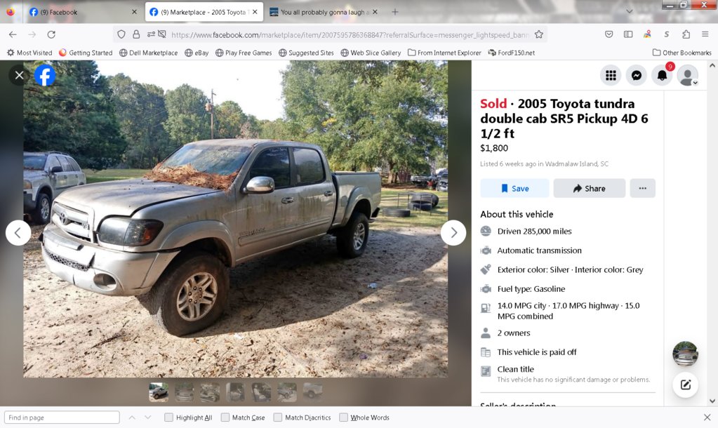

    does that help any?

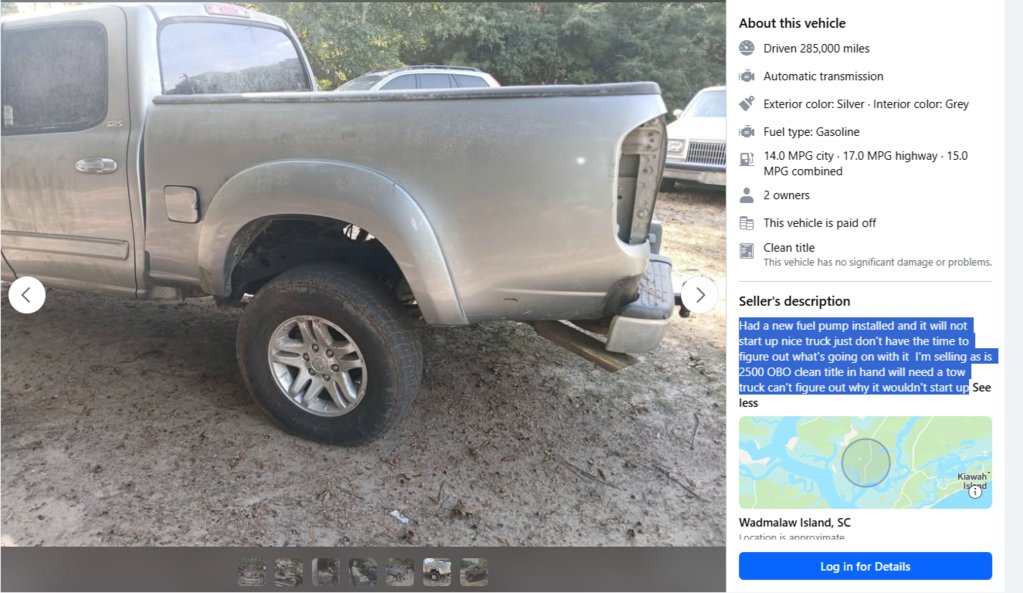

    Here's the link to save y'all some effort:
    Seller: "Had a new fuel pump installed and it will not start up nice truck just don't have the time to figure out what's going on with it I'm selling as is 2500 OBO clean title in hand will need a tow truck can't figure out why it wouldn't start up"​
    Yeah, you know damn well why it wouldn't start up :rofl:
    Goddamn thing got flooded out.

    What the hell is up with the bed on the driver's side? Did he pop the bed off to change the fuel pump and not set it back down right instead of dropping the tank?!

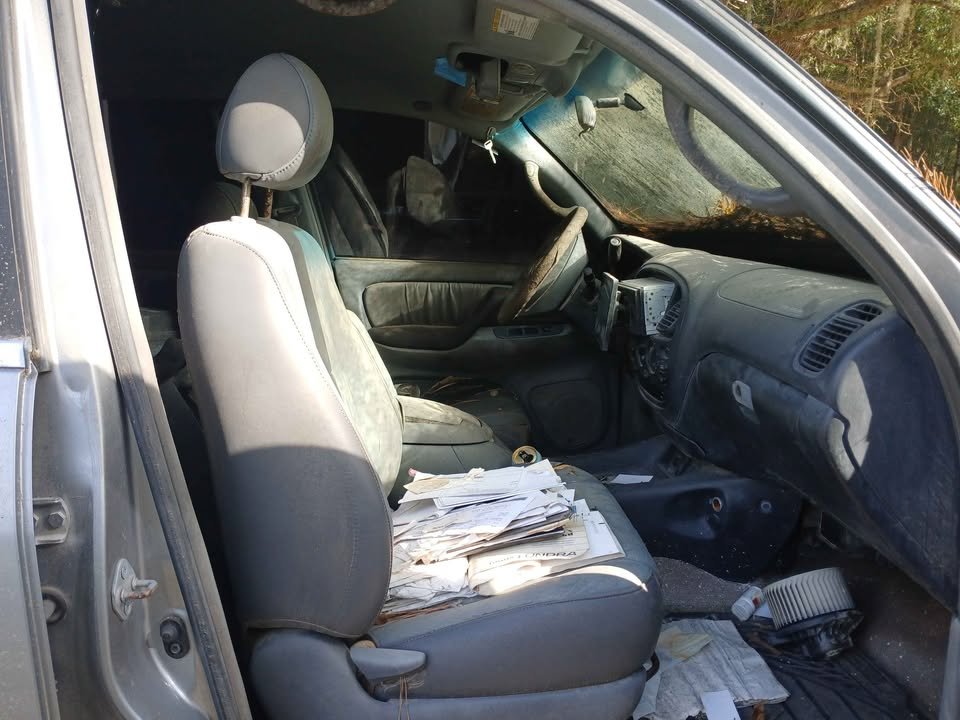

    I will say, that's a mighty fine stack of maintenance records in the seat... Why is the ead unit halfway out, and the blower motor on the floor?!

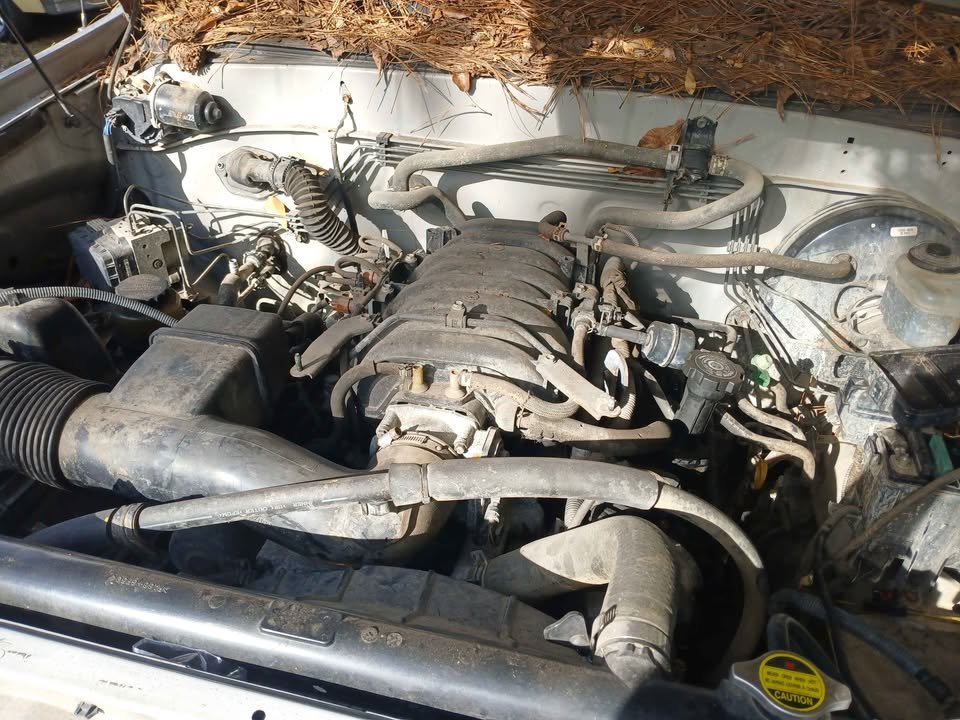

    No water in the brake MC rez is a good sign. No obvious rusty clamps in the engine bay is another really good sign. Wonder what details the air filter would share with us?

    I also noticed from your Facebook link that the cigarette lighter port is rusted so it may just have been exposed to the elements.
    Worst case, OP could easily get his money back parting out the truck. A good frame will easily go for $1000-$1500.

    This is a good point, but if it took a temporary dive in the water/ditch/boat ramp/high tide, you're not going to see a ton of mud in the floorboards

    All rational points. I'd add that yes, a short submersion at a boat ramp wouldn't cause mud accumulation, but also likely wouldn't cause the rusting/corrosion of the interior/cab parts. I'm leaning toward the OPs suspicion that it was left with windows down for months or years.

    If it did get left with windows down for a prolonged period or otherwise picked up relatively clean water devoid of debris or dirt... Then it was surely closed up, while still wet, possibly in warm weather, to get THAT much corrosion (and mold) on different bits and pieces throughout.

    Yes
    bed off, typical fashion of how you do a GM
    i dont know anybody that drops the tanks......
    At least they pulled the bed off and didnt cut a hole in the floor, seen that plenty of times too
    You can see in the color of the drivers front window vs the drivers rear window. The green algae that grows on vehicle paint when they sit out under trees or in the elements for a long time is hard to hide, notice the whole truck including drivers rear window is covered in green algae from age but the drivers front window is cleaner. That truck had the front drivers window left down which is why the seats are covered in the algae from humidity over and over and rain and everything else.
