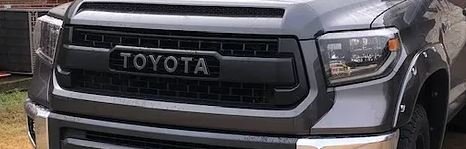

    I've hunted through the forum, I've checked the links, I'm still hopeless. At this point, I don't care if its OEM. I'm just looking to update the "face" to a TRD style grill with a paint matched surround. I can have it painted locally, but would rather just cut a check and it appear on my doorstep in a week or so. I've attached a snippet of what the goal is.
    Can someone shoot me a link to what I need?

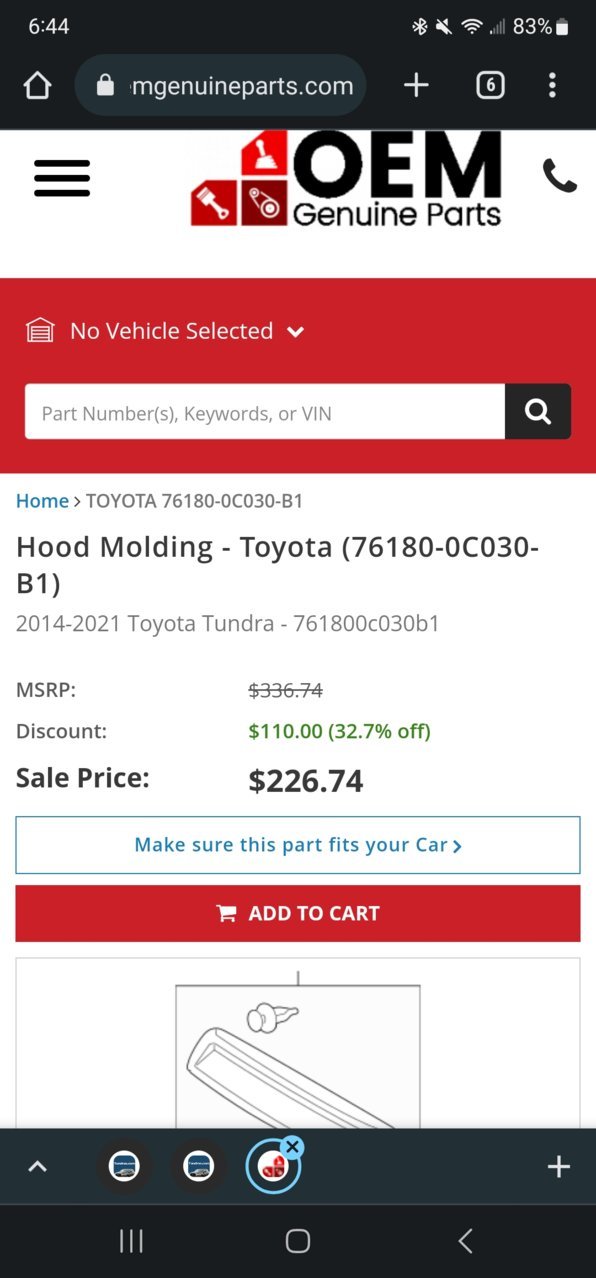

    Alot of them
    So you need the part number for that older style grille and the hood bulge in MGM color code?

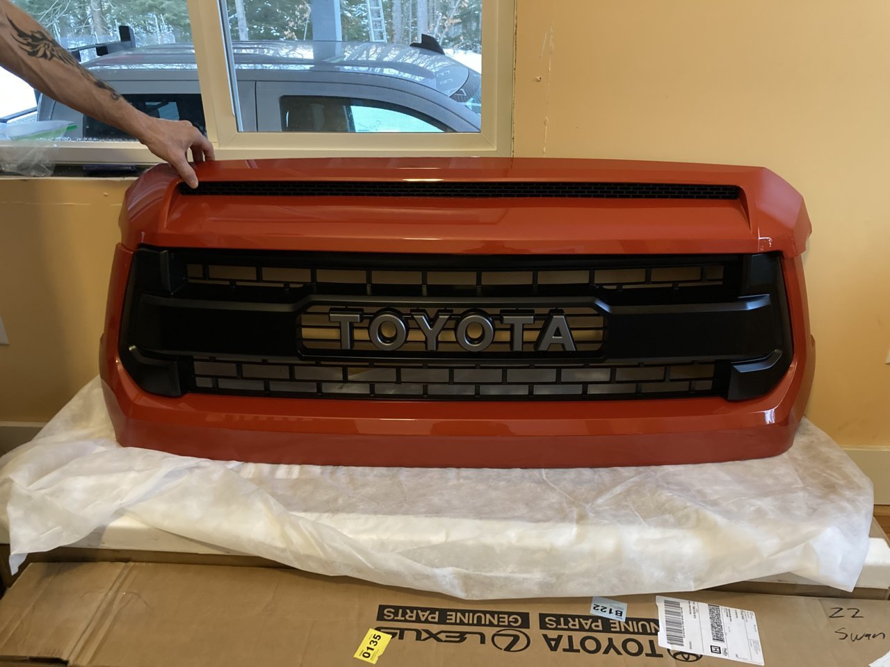

    Ordered the color matched surround, hood bulge, and pre 18 pro grill from Sparks. Showed up in less than a week (I think.. it was a couple yrs ago)

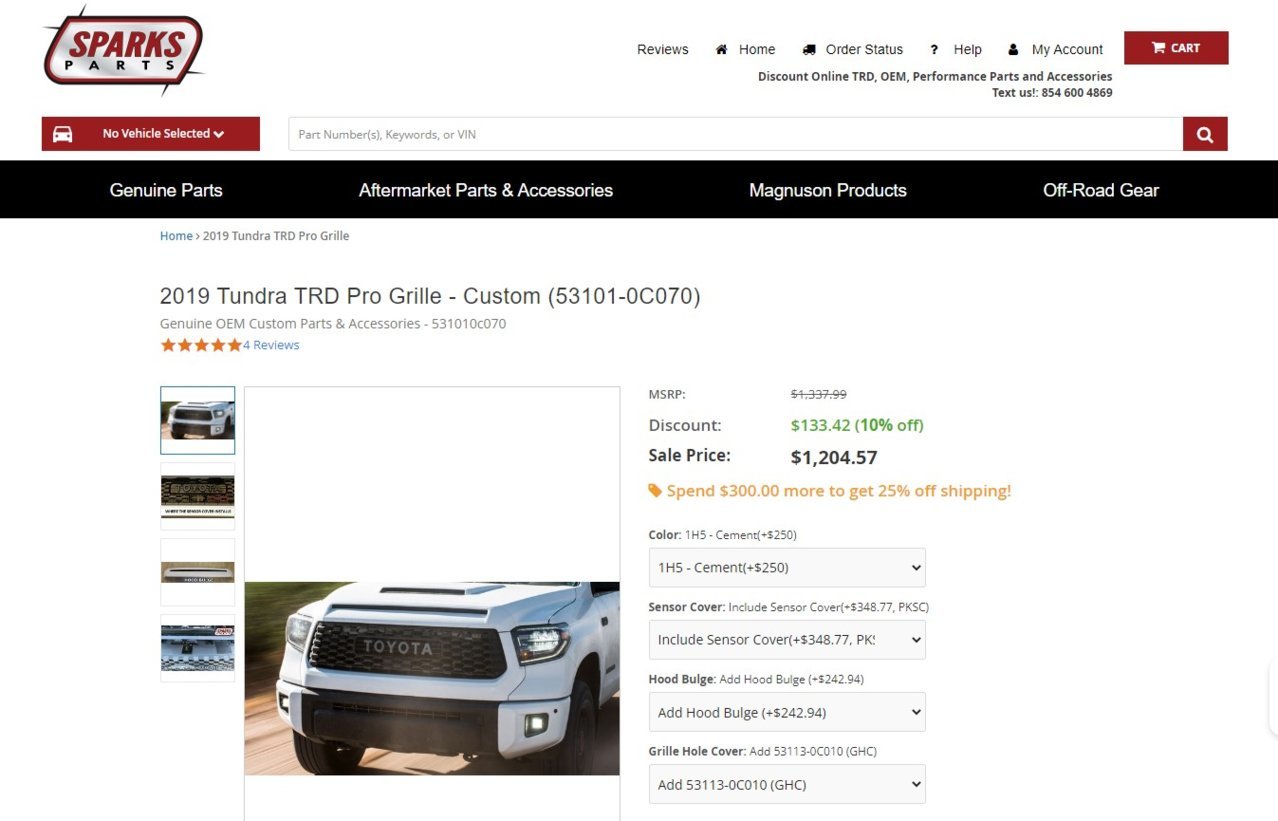

    What would be needed for the front sensor? I have a 2018 with the front TSS sensor I believe and looking to do the same, I found a grill send up on spark's but doesn't seem to have the front sensor location. Sorry I'm very new to the tundras, first time tundra owner.

    Is this the grill that you are looking at?

    Isnt there a front sensor cover and hole insert that needs to be there? Again this is all new to me for the tundra

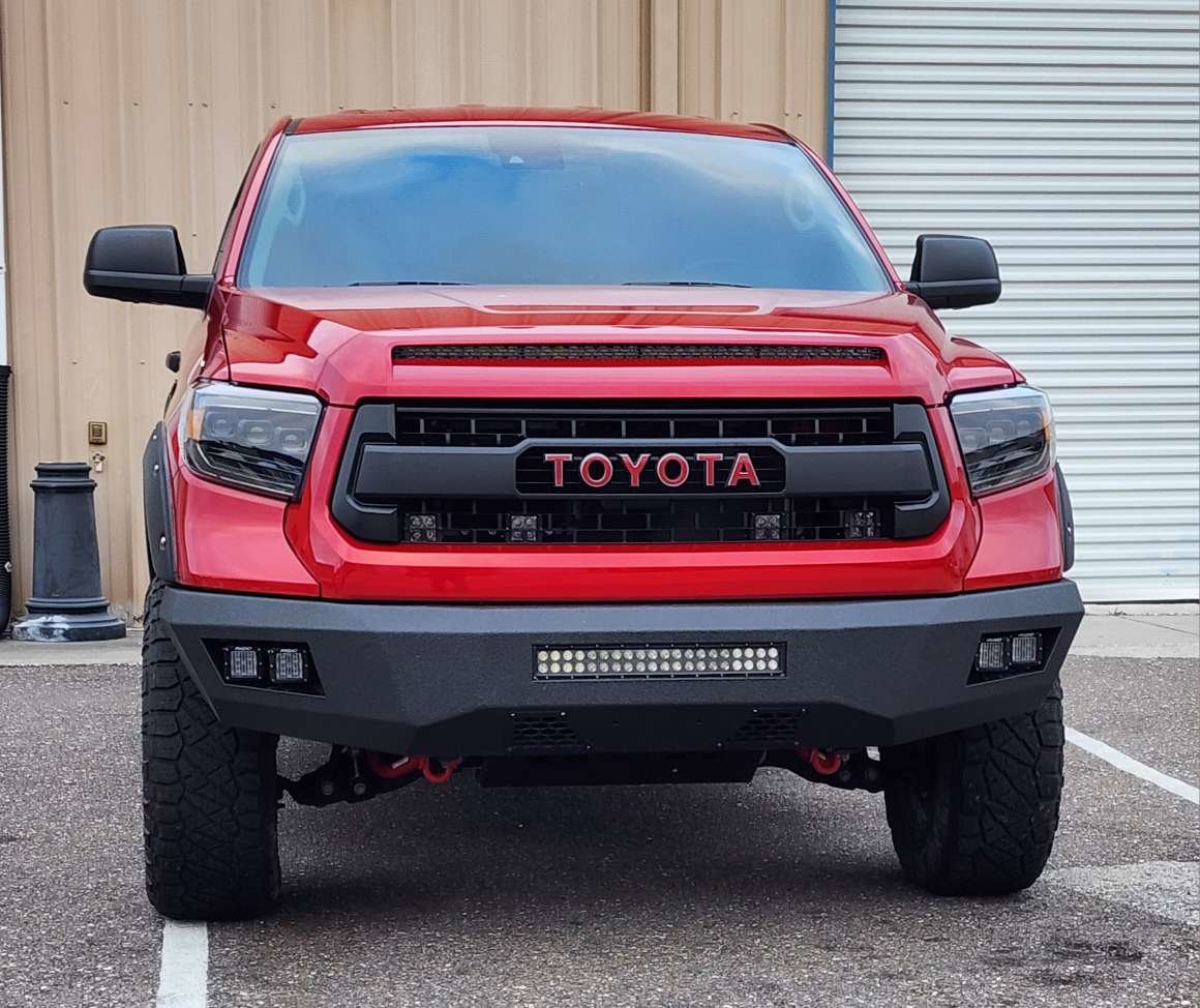

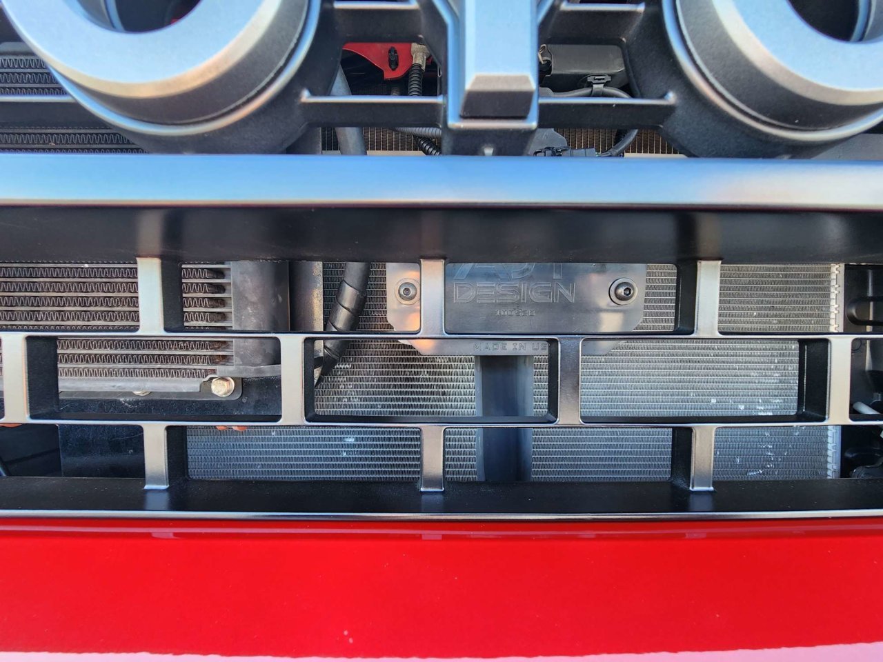

    So there are 2 different Pro grilles and either one can be used. The one like I have is listed for the 2014-17. It uses a bracket mount made by AJT and is only for that style grill. https://www.ajtdesign-llc.com/online-store/TSS-Relocation-Bracket-10052B-p194252238

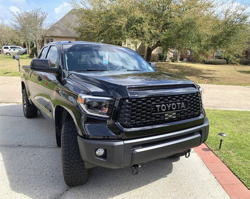

    There is a newer style Pro grille (black truck) listed for the 18-21. This grill has the sensor mounted to the front of the grill with a cover (known as a garnish) over it. Which grille are you looking at before we get into the additional info needed?

    That grille will fit yours. You just need the AJT bracket. I'll send you a PM. That red truck is mine.

    They are both Pro. There are 2 styles. The one on the black truck will require the additional garnish that is $340. The one on the red truck requires a relocation kit which is $50.

    The black one is the one I am looking for. What is the garnish?

    Ok the black on is the new style. That silver looking printed cover in the bottom center is the garnish. Your sensor will mount in that spot and then that garnish covers it. You can get an aftermarket garnish cheap but most people have issues with them not working and giving sensor errors. The Toyota garnish is $340. My grill has a different kit being the grill that mounts to the radiator support.
