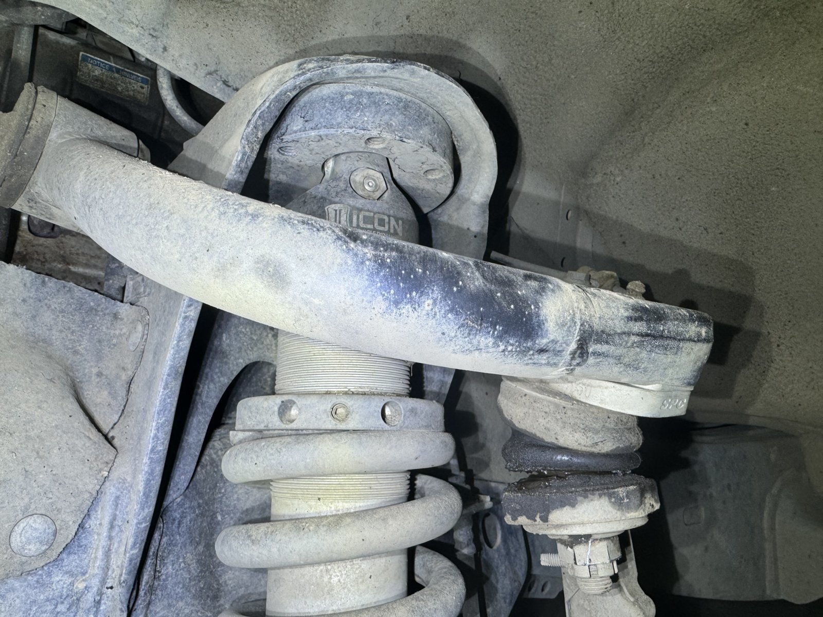

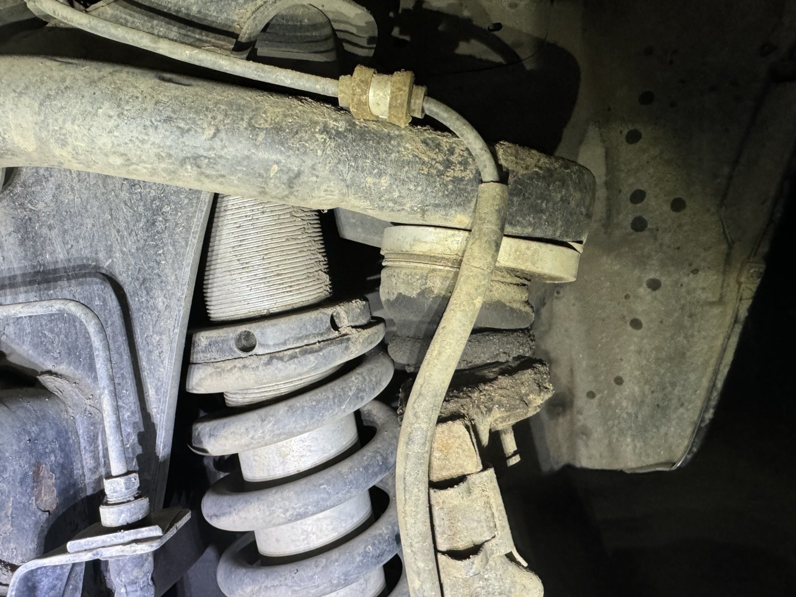

    Am I missing something?
    Been chasing a clunk on the girlfriend’s Sequoia. While doing a tire rotation I found it. Driver side balljoint has 3/8” play, and passenger side has about 1/8”. Play is in the ball socket. Pretty Fawking scary.
    I’m running Icon Mid Travel coil-overs. Are SPC’s maxed out at normal travel? Both boots are torn.
    I torque everything to spec all the time, I have 5 various 1st gens, and maintain them heavily.

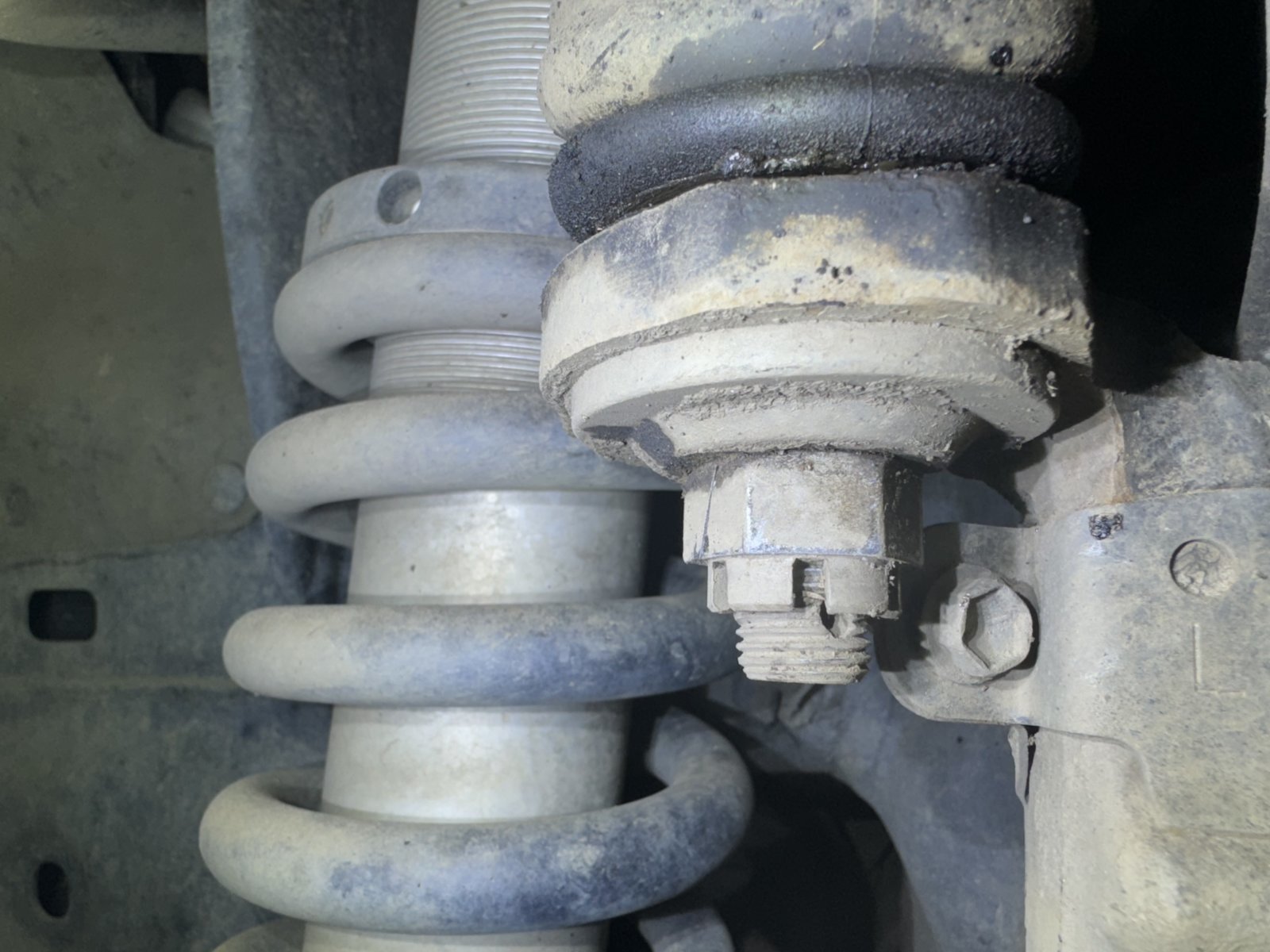

    I noticed when I installed these they sat very deep in the seat, and on the driver side the nut was higher than the cotter pin hole. Did I botch the instal? Side note, I have 3 rigs in the driveway running SPC’s.
    Pics are at full droop.
    Cotter Pin removed as I tried to tighten.
    Angle at full droop. Doesn’t look too crazy?

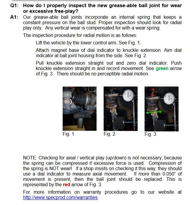

    FWIW, the grease-able ones (not sure about their non-greaseable) should have some up and down play, but your play sounds excess and different from this.

    https://www.spcalignment.com/partFAQ/25001_FAQ.pdf

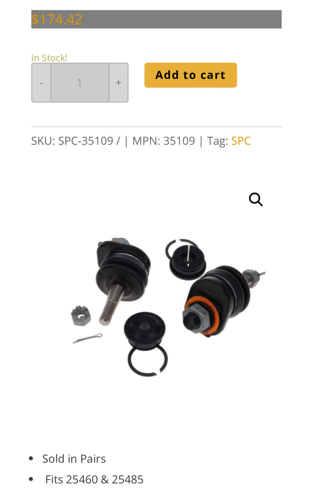

    There are/were 3 diff't UBJ for our 1st gen Tundra/Sequoia SPC uppers (SPC UCA p/n 25485). One greasable/zerked, which most of us probably have currently installed b/c our arms came with them preinstalled, two ungreasable/no zerk. One w/o zerk is discontinued because of some issue with an internal spring that was bothersome for inspection stations (??!).
    SPC shows that here in the red box (screencap below). And here is our current replacement option, SPC p/n 35109. The original zerked UBJ was SPC p/n 25001 and may be NLA in the near future. I've seen it with anodized-looking finish as shown below, and a grey/matte cast finish. According to @Desert Dog (from the future), [for one or more of the other non-zerk'd UBJ] per SPC tech-support, they can be converted to greaseable w/SPC p/n 25477.
