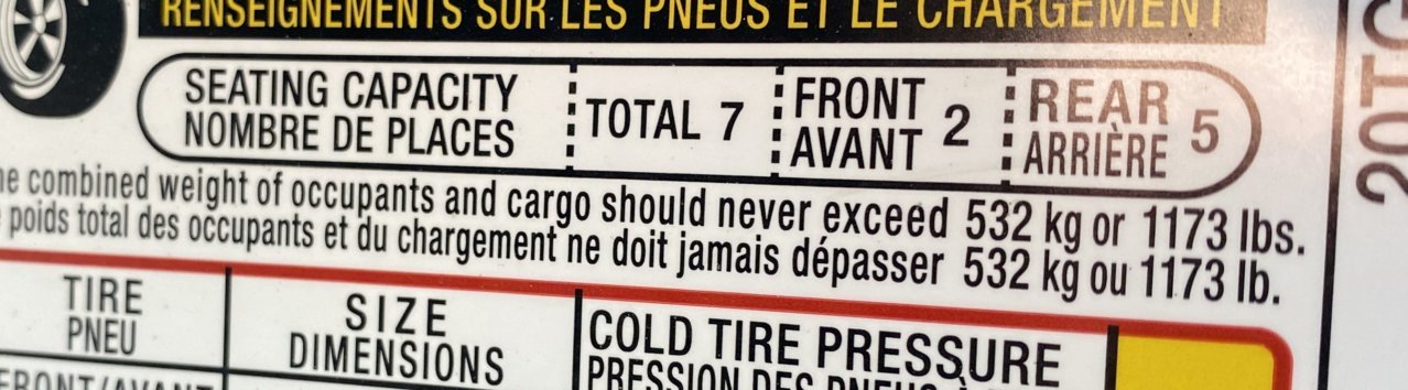

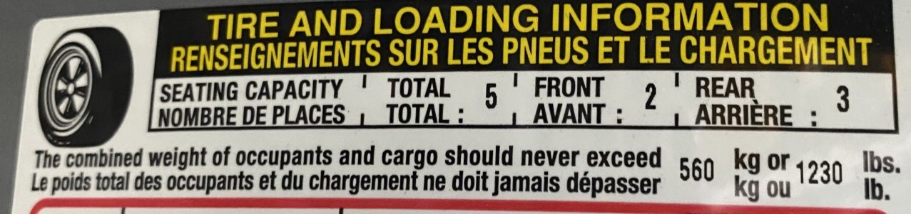

    Just add some fun:
    Which one is the 2018 Crewmax and which is the 2016 Honda Pilot Touring (loaded up with every available option and dual sunroofs)?

    #89
    34,186
    18" TRD Off Road Wheels
    Seating capacity gives it away... and you're an asshole. :rofl:
