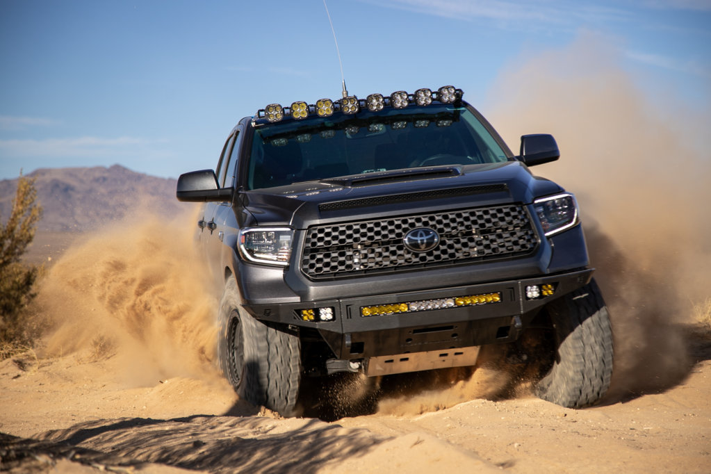

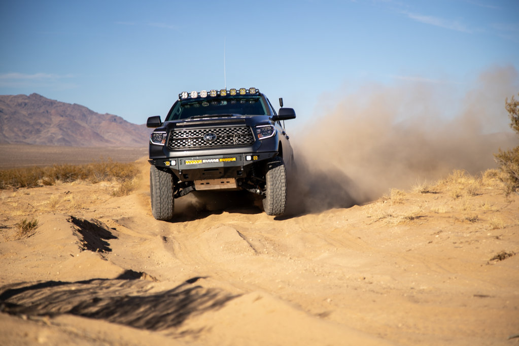

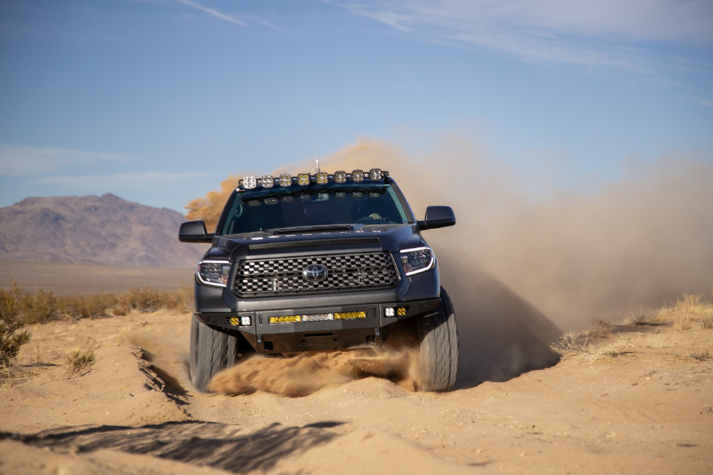

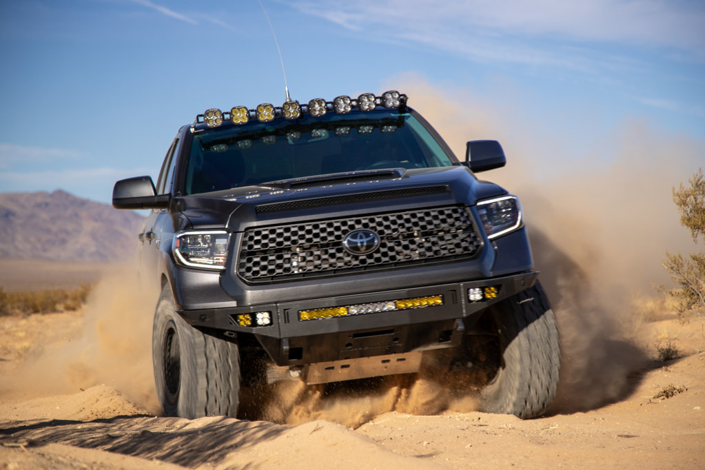

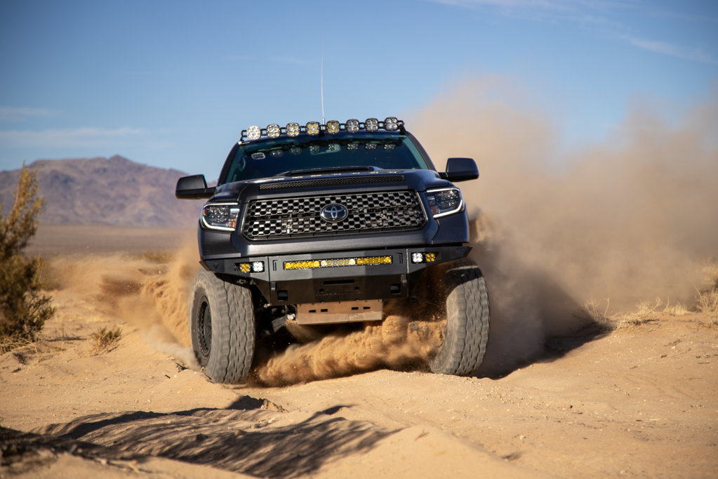

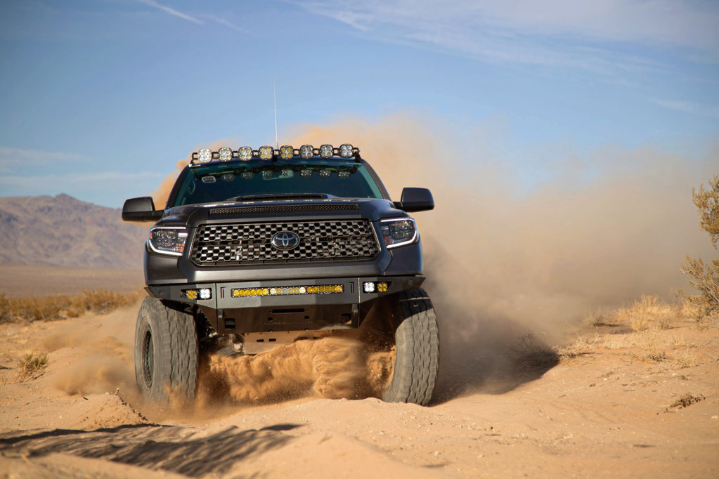

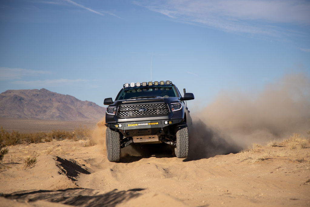

    Couple more shots from KOH

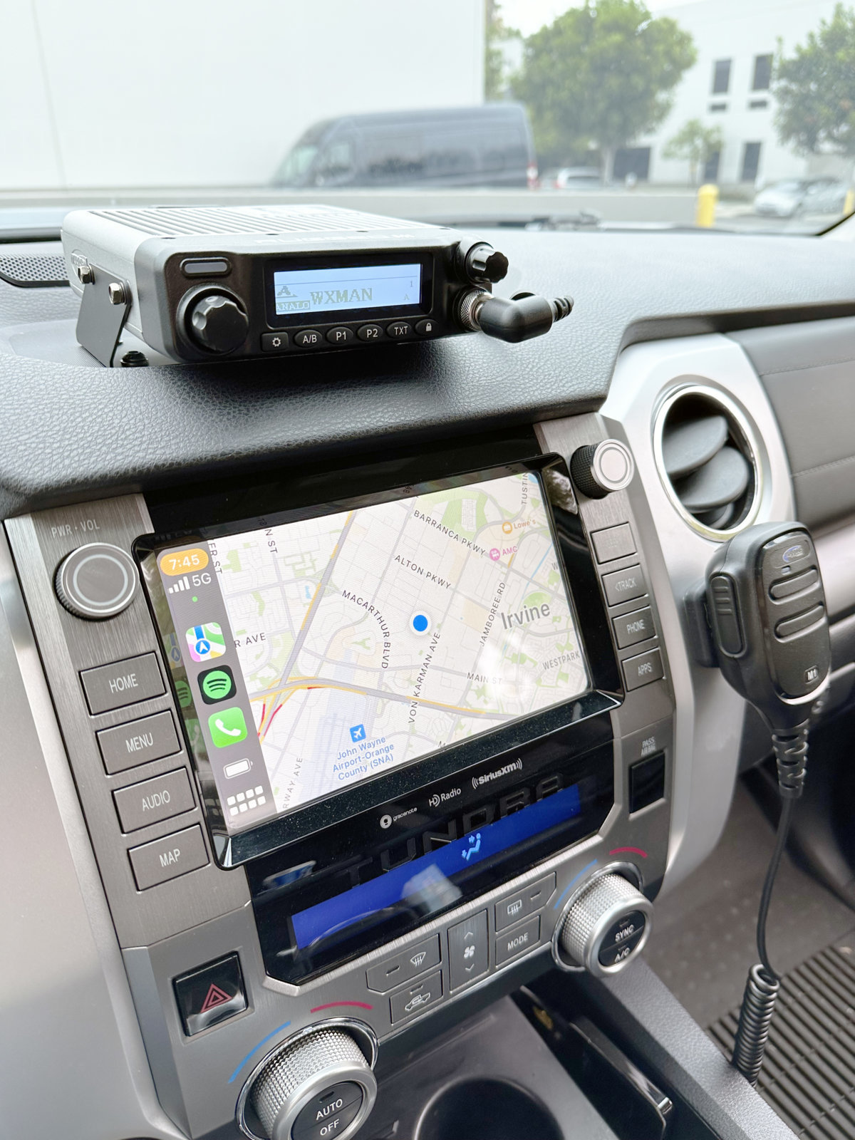

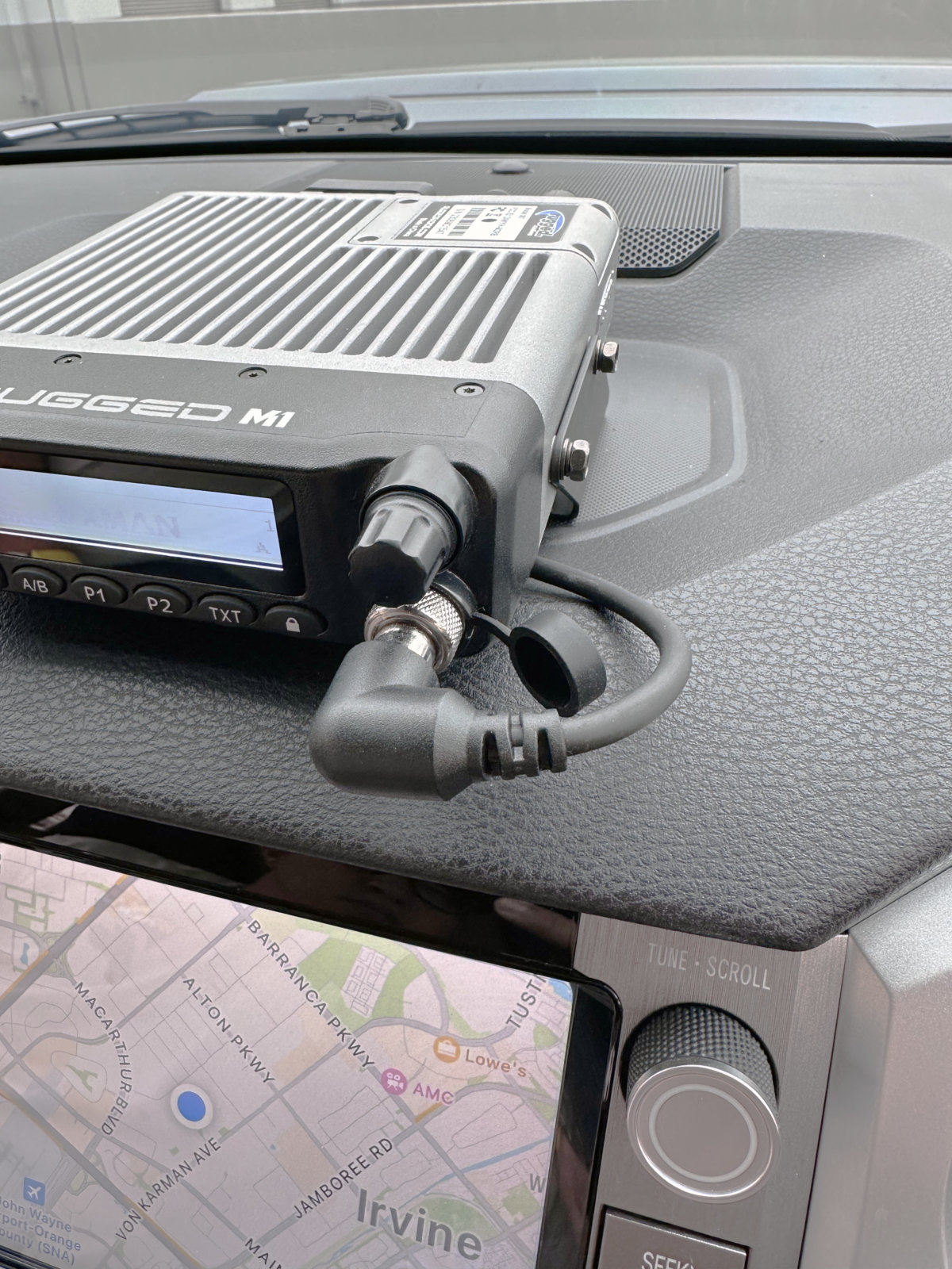

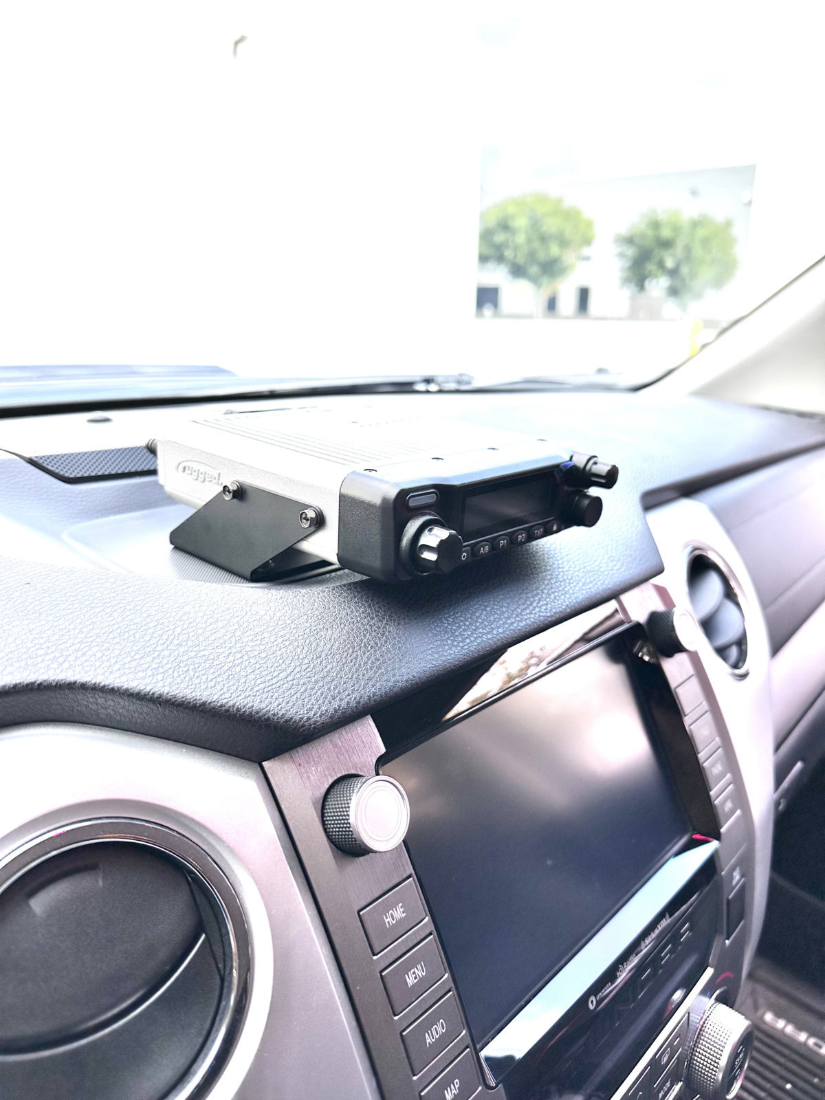

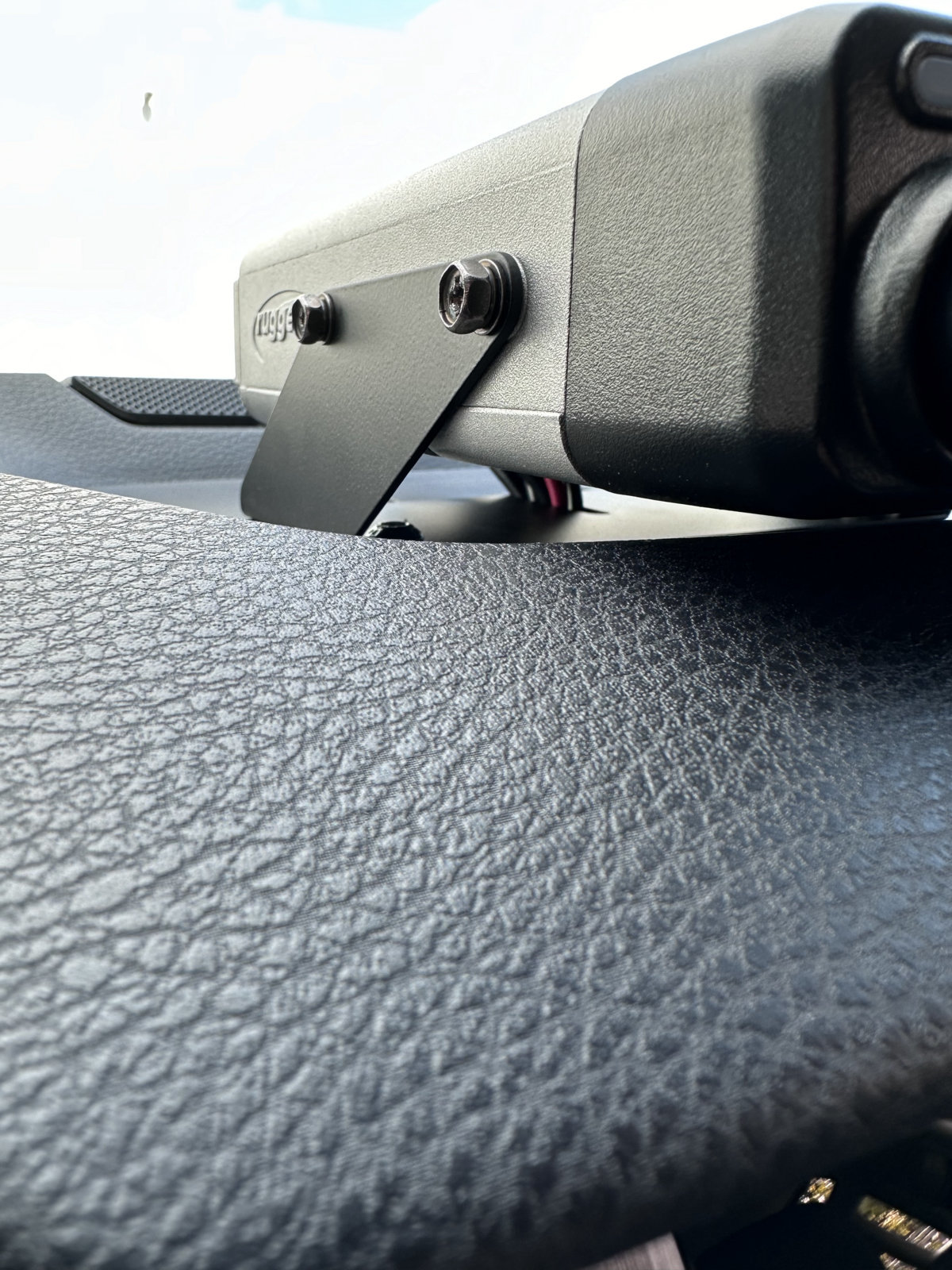

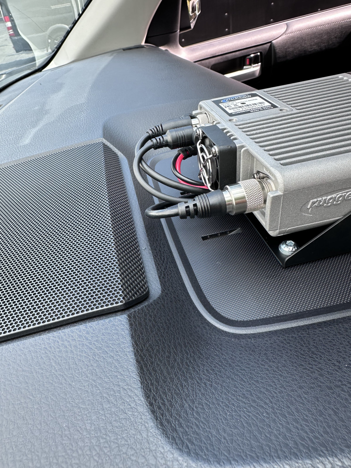

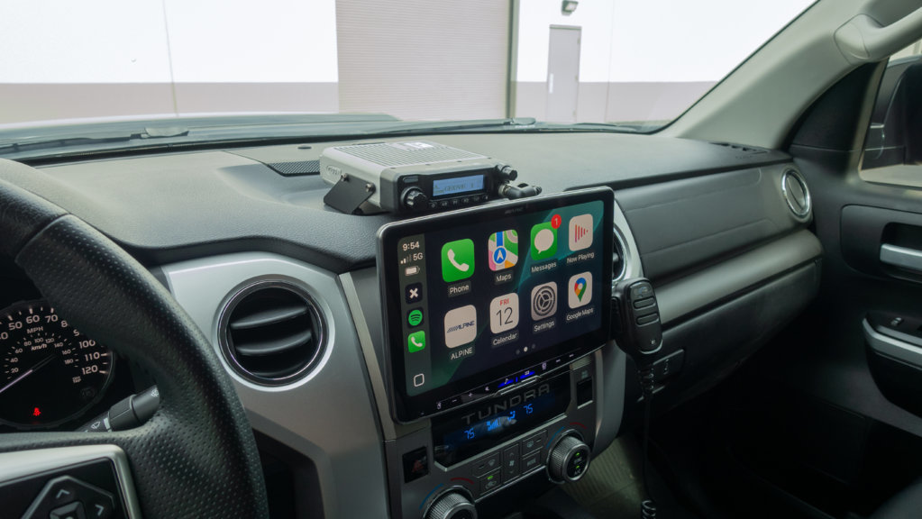

    Picked up a Rugged Radios M1 Chase Radio, but wasn't very happy with the available mounts so I developed my own solution.
    This is a lasercut & CNC bent powdercoated steel bracket that positions the radio in the center recess on the dash. It's offset to bring the radio towards the driver for easy access to all the controls. It also has a pass-through slot in the base to keep all the wires tidy and maintain airflow for effective cooling. When used with a mic cord extension, this will keep the front of the dash completely clutter-free with flexible mic mounting on either side of the center console.
    Mounts with four M6 screws and requires drilling a 3/4" hole for the wires and connectors. The 3/4" hole is covered up by the pass-through slot. Radio is mounted super solid and works perfectly.

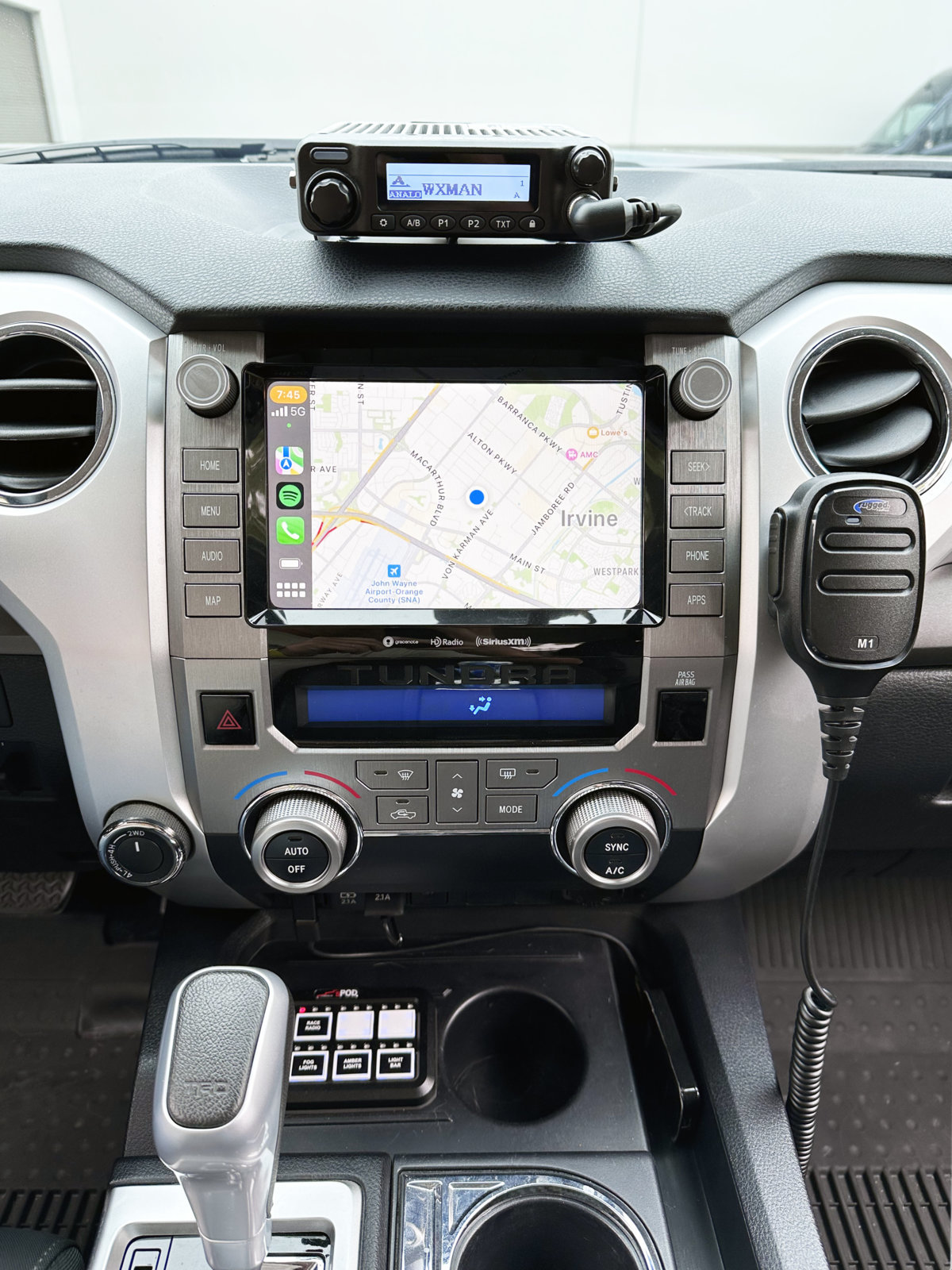

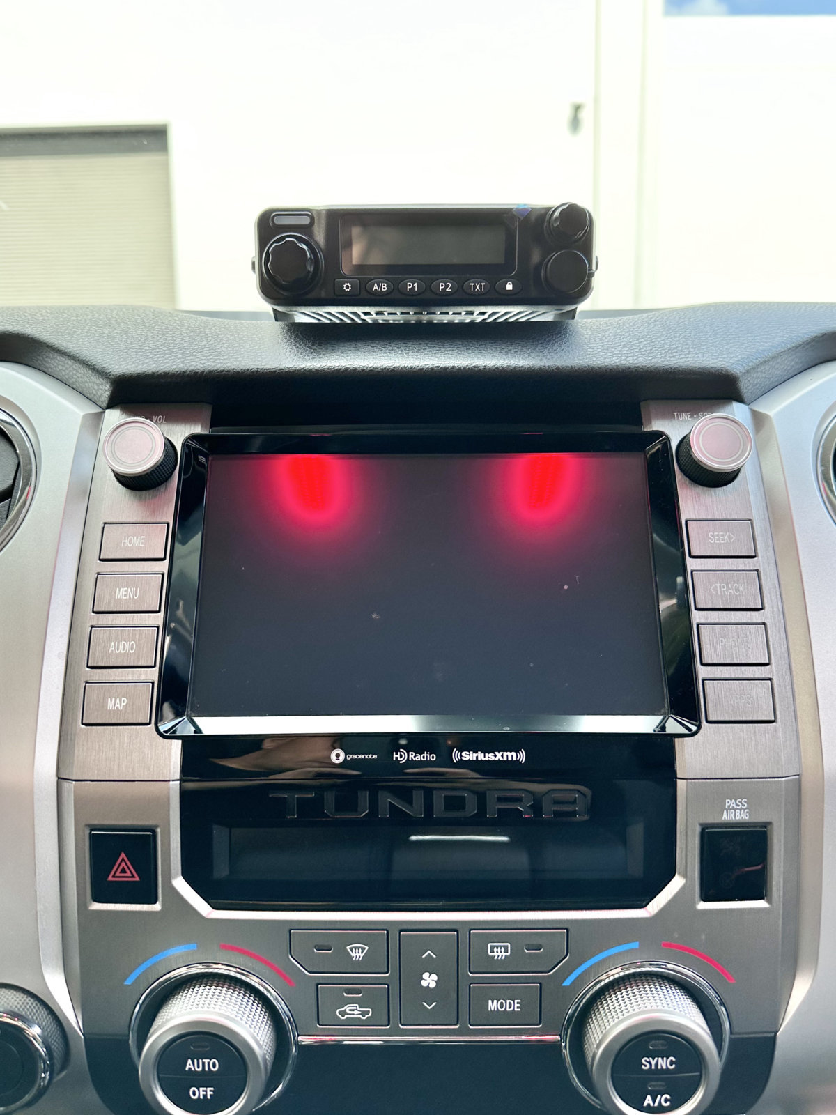

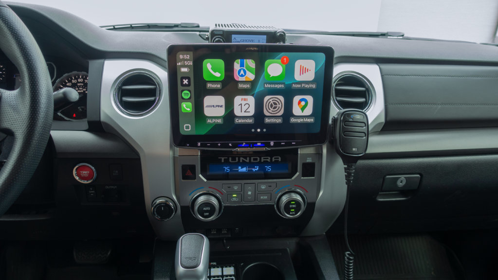

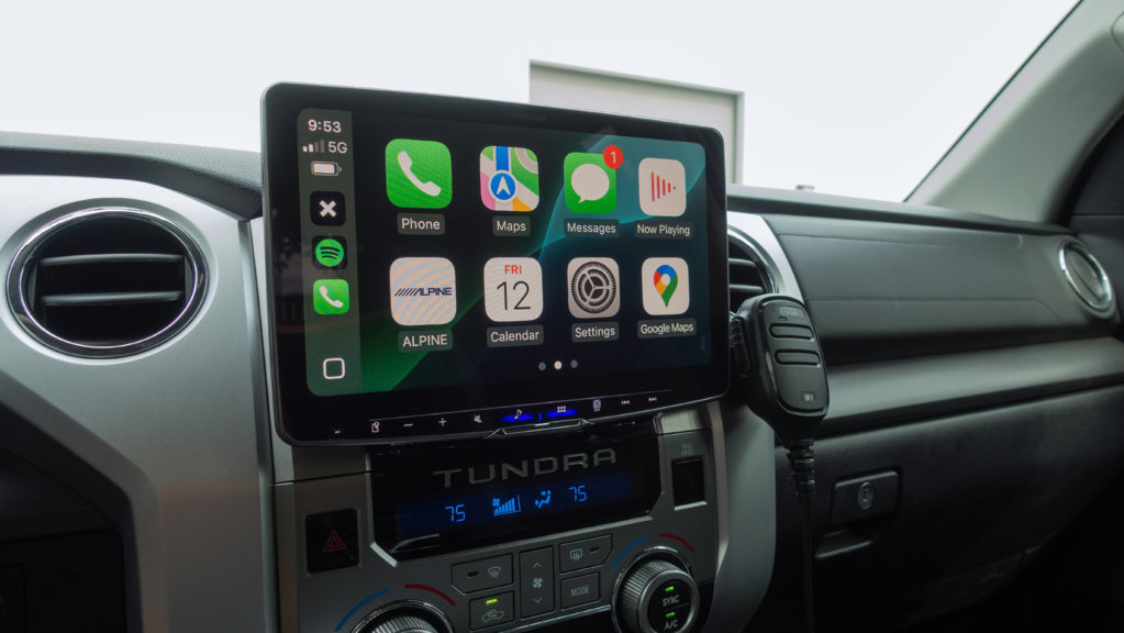

    Completed install of the M1, with the WSDMetal mounting bracket.
    Used a 90° mic cord extension and routed everything through the wire pass-through slot. The mic cord now comes out through a factory opening under the dash/center console, so it doesn't flop around and interfere with multimedia/HVAC controls.
    The mic is secured to the dash using the supplied Scosche mag mount.
    Super solid and clean with full accessibility on the go.

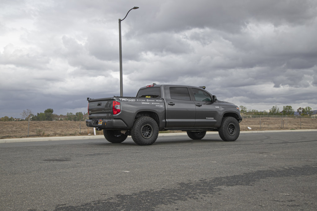

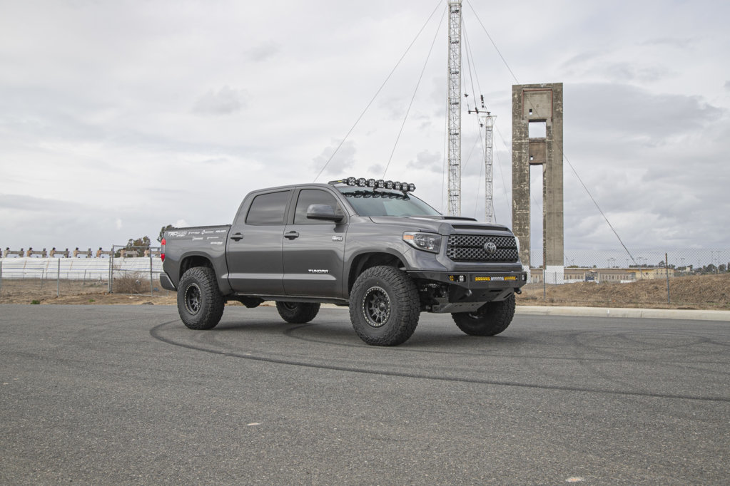

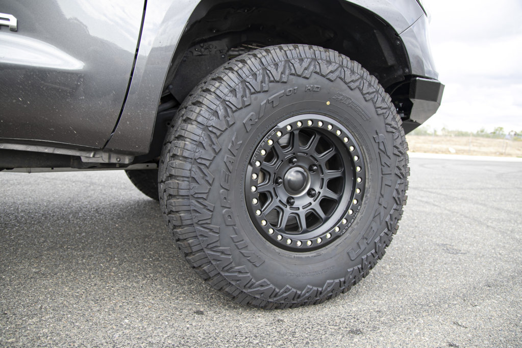

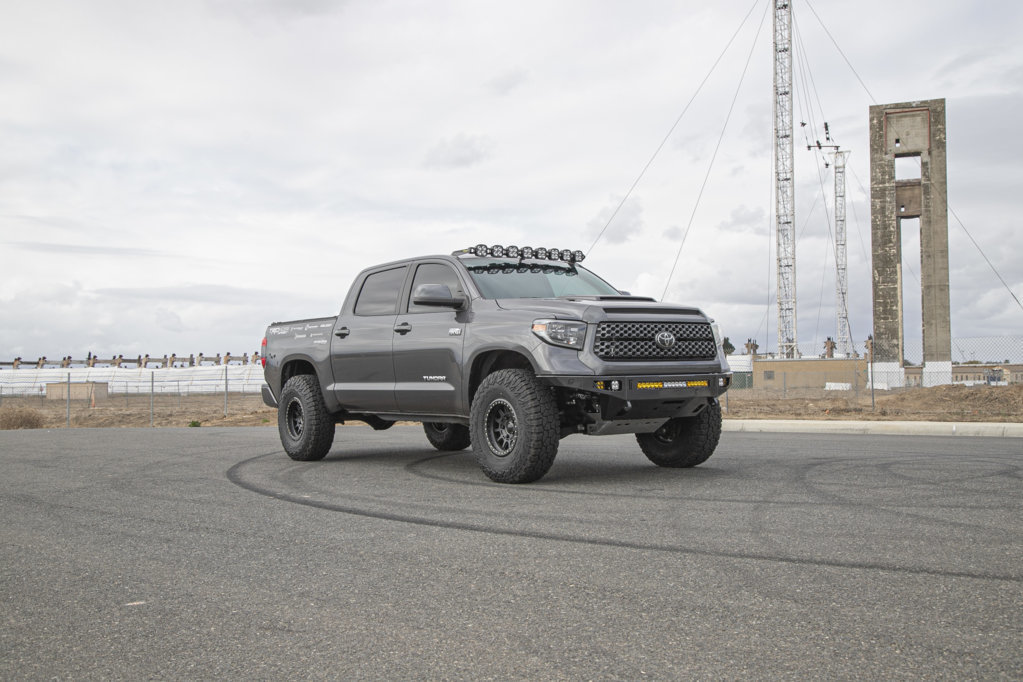

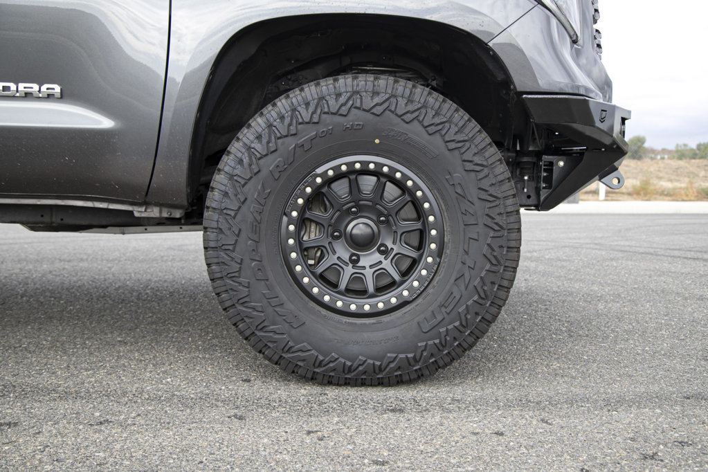

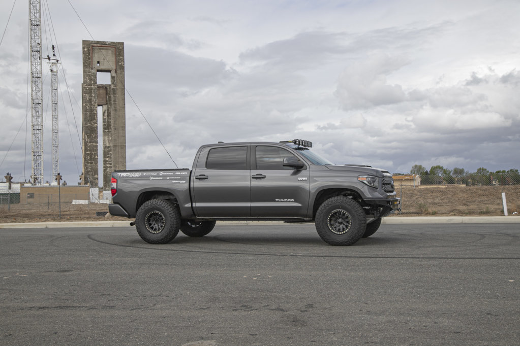

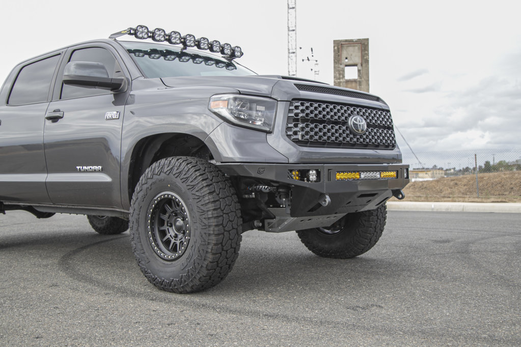

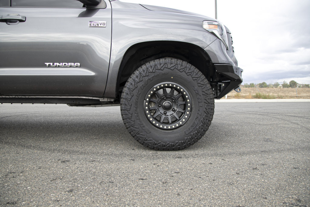

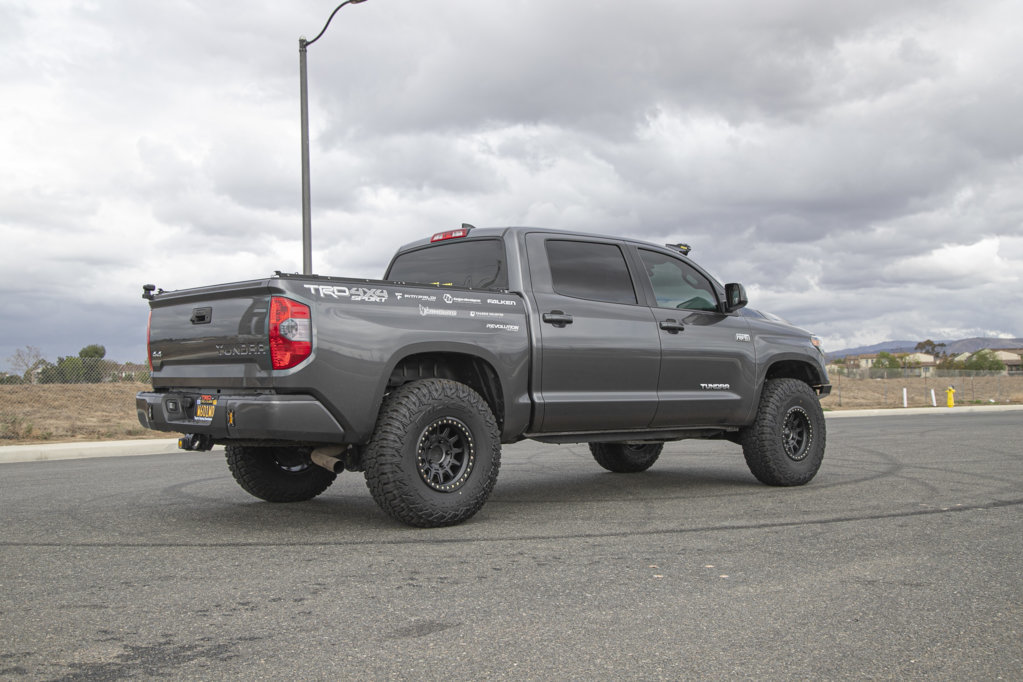

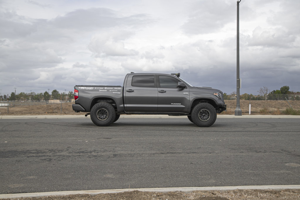

    Upgraded wheels and tires.
    Wheels: 17x9 +18 Fittipaldi Off Road FBF804 forged beadlocks
    Tires: 37x12.50R17 Falken Wildpeak R/T
    Didn't even need to balance a single wheel/tire!

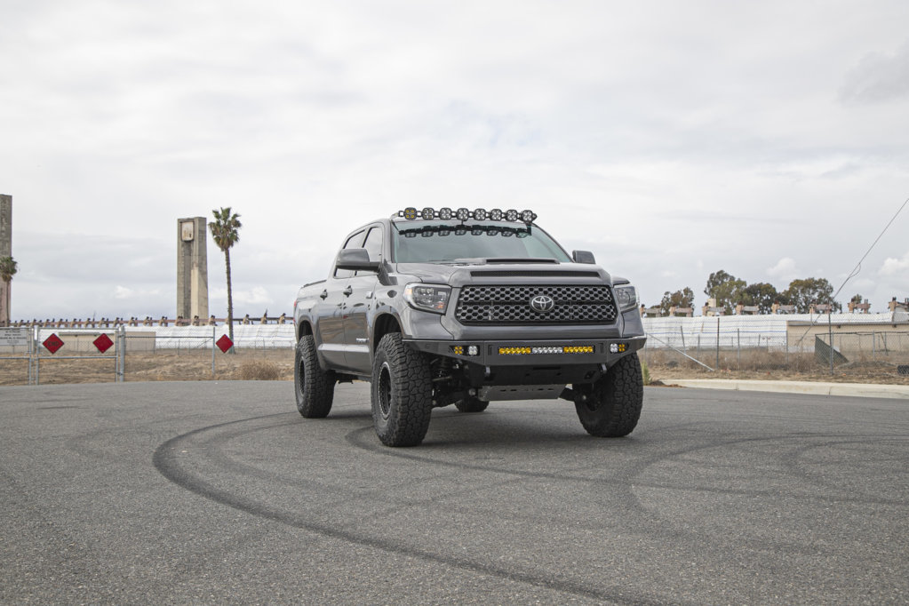

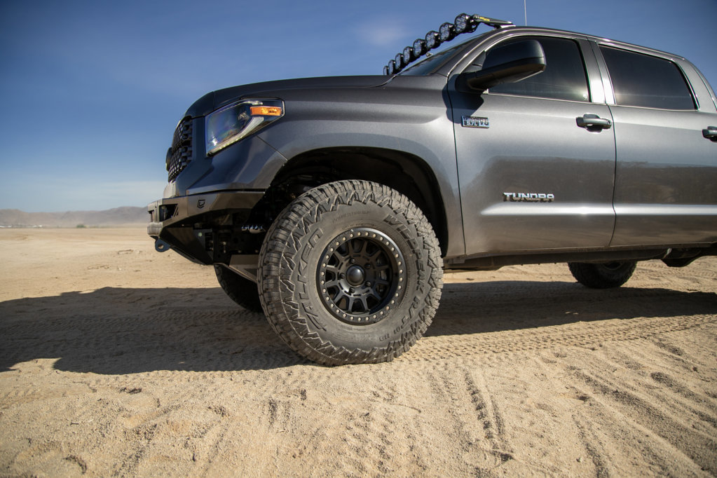

    Took her out to Johnson Valley for shakedown with the new wheels and tires. Fender liners survived, but it's clear that the 37's are trying to rip them out at bump. I have some bumpstop spacers that will limit uptravel and help the liners last a bit longer.
