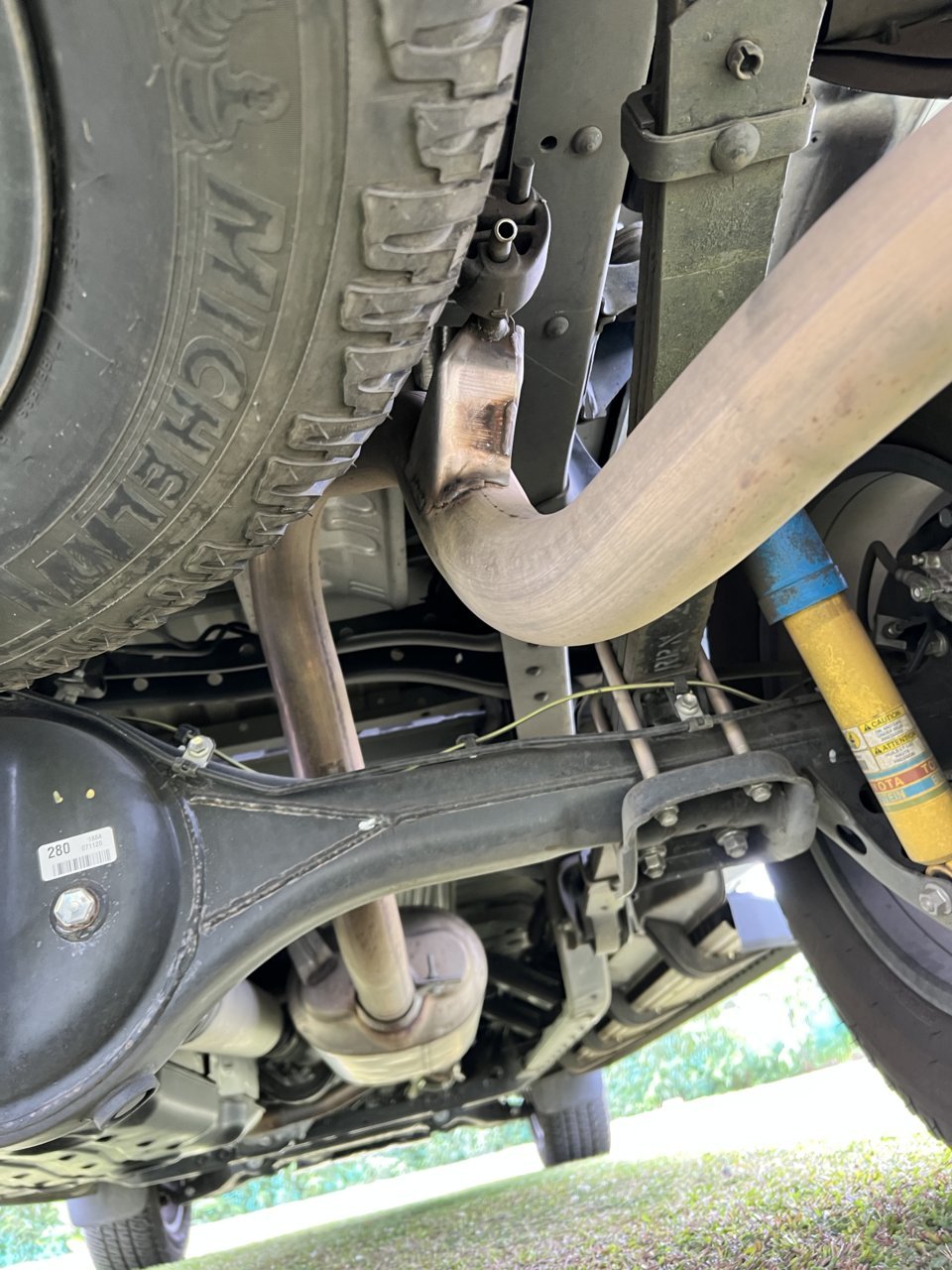

    I really can’t tell and I don’t know if this picture and video can show you. Can you see the tank in either of these?
    sorry, it won’t let me attach the video.

    Yes. What do I measure?

    The tank is on the left side of your picture with the black skid plate over it. Just measuring a rough length of it from one end to the other.

    Is this a better picture?

    Drivers or passengers side?

    Drivers side

    See if that black shield is close to 6 feet long. That is the 38 gallon.

    That is a 38 gallon fuel tank.

    I have a 2021 sr5 WITHOUT the sr5 upgrade package with a bench seat and 26 gallon tank.
    SR5 trim comes standard with a 26 gallon unless you get the sr5 upgrade package which is what gives you the center console as well.

    Also 3 gas tank straps is 38 gallon tank and 2 straps is 26 gallon
