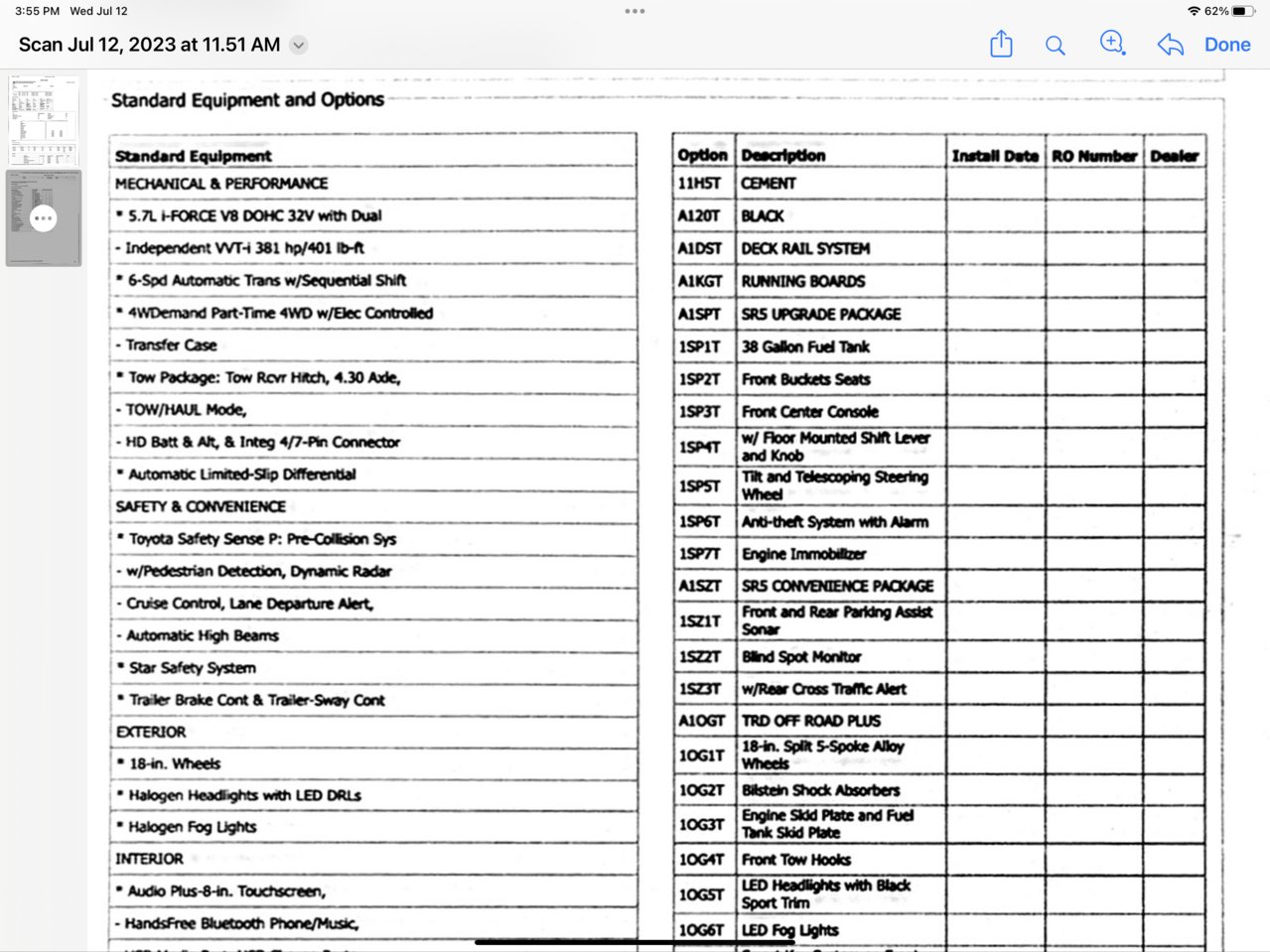

    My salesman sent me this today, which is like the window sticker. It’s the details of my truck specific to my VIN. See right column, 6th row.

    SR5 'upgrade' package is inclusive of the 38-gallon tank, so if that was part of your build then you should have a 38 gallon tank...
    Trucks with just the SR5 'convenience' package ONLY did NOT come w/the 38 gallon tank...

    Yep, and they installed a 26 gallon by mistake.

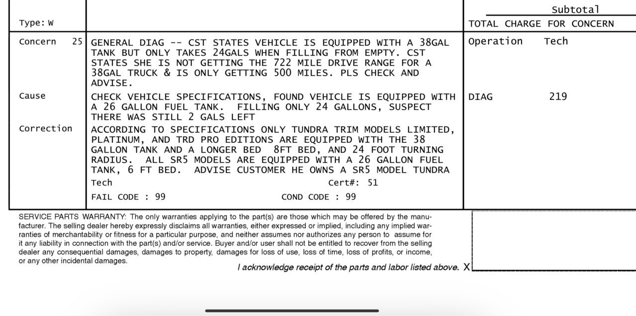

    Read the service tech’s notes from today. He really needs to go back to school and learn about Tundra’s!

    It seems like I have a 14 gallon reserve if I’m supposed to have a 38 gallon tank, which the window sticker said it had. But now to find out from the dealer that it only has a 26 gallon tank. Someone in the production of somebody screwed up.

    Dealerships are idiots. Hit the "Upload a File" button in the bottom right corner of the forum reply box and post up a picture of the underside of your truck from the driver side. The large tank is unmistakably huge.
    It is usable. You can drive well beyond the fuel light, but because the 38 gallon tank is so long (about 6 feet) you could starve the pump on an incline. To avoid this, Toyota has the gauge and light set to come on very conservatively.

    I am going to the dealership to pick up my truck today which is 60 miles away one way. When I get back home with it, I’m going to try and go underneath of it and look. However, the dealer did confirm and say there is only a 26 gallon tank installed in it. But like you said they are idiots so they probably didn’t even look and just assumed it.
