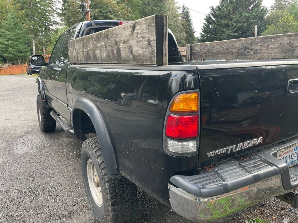

    Pics are worth 1000 words
  6. Sep 27, 2024 at 2:35 PM
    samabbott06
    samabbott06 [OP] New Member
    Sep 27, 2024
    #123531
    14
    Pics added

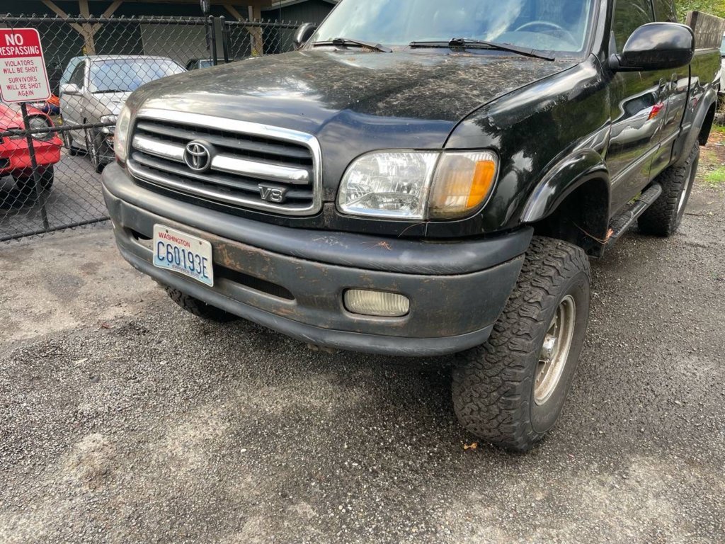

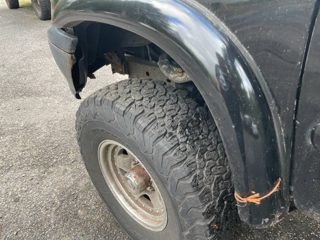

    Not the original wheel flare in the rear. I wouldn’t be surprised if it’s hiding some wheel arch body rot. Doesn’t look like it was well kept, but it’s probably a work truck. If you’re going to use it as a work truck, sure.
    Look under the rear bedliner (if there is one) to see if the pickup bed floor is rotted out with holes in it.
    Probably a cheap rough country lift with spacers to go with it as well.

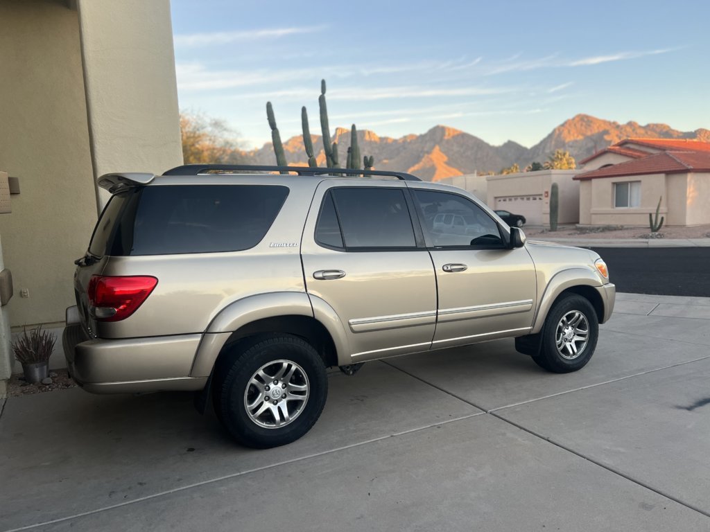

    So.Arizona
    You could do better where I’m at. I paid $5,100 out the door for this one in January. 245k then, 248k now.

    For a non-rusty “state”, I see a lot of surface rust so make sure you know how to differentiate it from rust that's penetrated the metal and started to delaminate layers of metal on the frame.

    Rode hard and put away wet! Make sure you crawl your ass underneath and check every inch of that frame.

    It looks a little rough for 4500

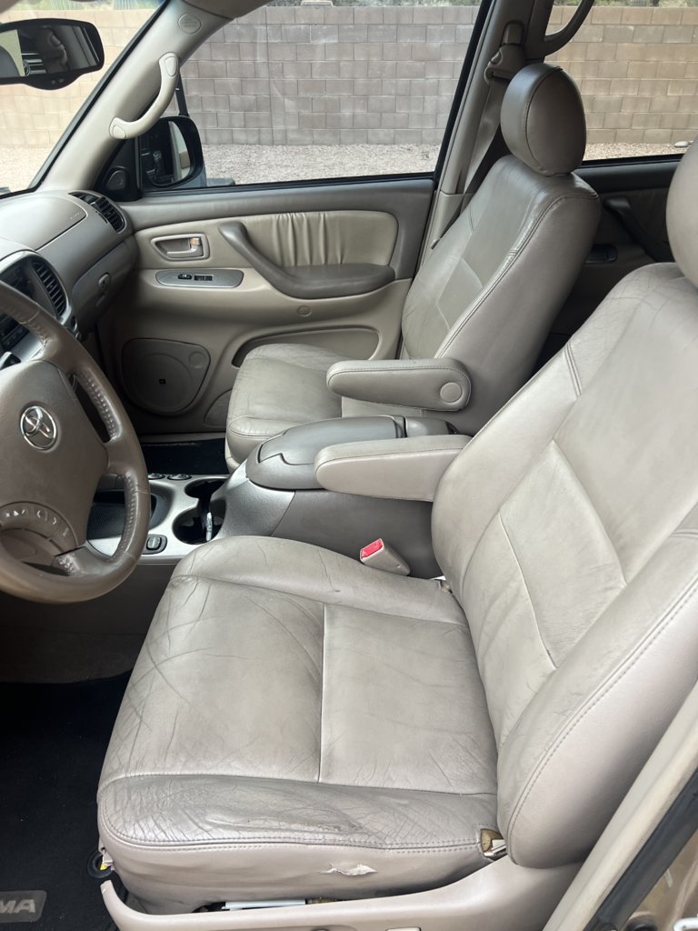

    How does the seat metal rust out?

    Walk away, that truck looks rough, it also looks as if it is going to cost you a boat load of money in the near future.

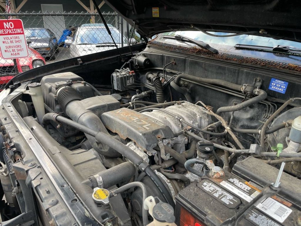

    First, blue sticker on firewall is the sticker you get with the Aisin (OEM) timing belt kit to track when the belt was changed. BUT, you can buy those stickers for like five bucks, and fudge it. A lot cheaper than changing the belt. I’d want to see proof. 10mm and a peek under either timing cover will tell you.
    But here’s the thing. We’ve looked at a LOT of 1st gen’s on here. You see how the silver intake manifold is mottled, pitted looking? Look around at the fasteners, see all that rust up under the hood? The hood latch. Positive battery cable. The clamps on hoses? Missing bolt with rust marks in its spot on the V8 cover? That’s exactly what salt belt trucks have, but southern trucks DO NOT. It’s a huge red flag. Even if the frame is solid, like, because it’s been replaced under the recall due to being so rusty, you are literally going to be fighting with every single fastener with each maintenance task you do. It may be being sold in a non-rust state, but clearly it lived or drove in one, where they salt roads, like Utah or something. Run the VIN at any free VINsearch site, see where the registration was renewed every year. The fact he didn’t send significant frame pics is potentially telling.
    But beyond that probable lie of a solid frame, 3” suspension lift with a 3” body lift requires a lot of hacking and is probably related to the ABS engagement issue that may be a shitty thing to track down, it’s either due to sensor install problem, wheel bearing or tone ring pressing issue, we get those complaints on here pretty frequently. Do you really want to inherit someone else’s project, as a student, needing RELIABLE transportation?
    I would not drive even one hour, much less 3. This dude is looking to fuck you over. Walk away. You’re looking at a can of worms here.

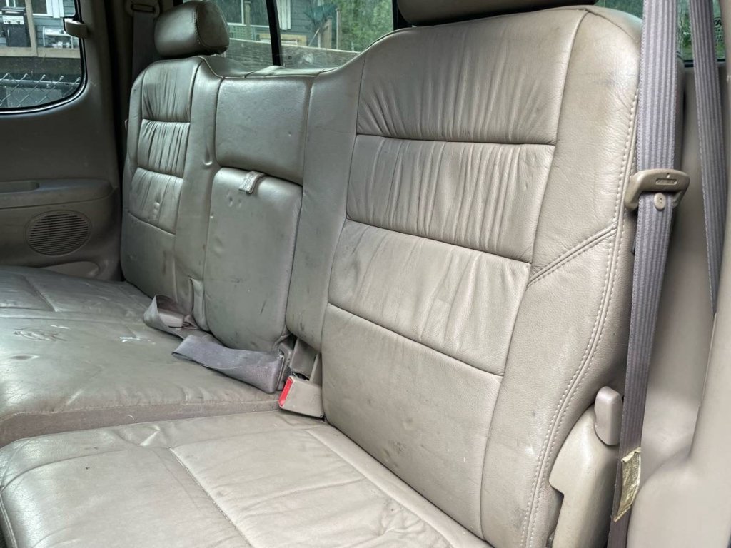

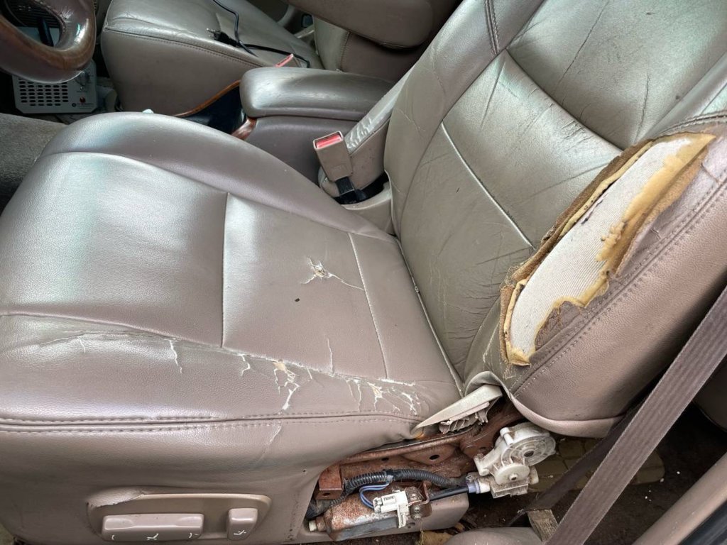

    Oh and @samabbott06 I noticed two a couple things this morning scrolling up.
    First off, the rust inside the cab, on the seat parts, as everyone said, that only happens if humidity is in the cab of the truck (water leak). Furthermore, I see evidence of mildew in the leather and in the back passenger door plastics.
    Also, I see the front driver framehorn of the truck, and the frame definitely has rust. Not outrageously so, but it's definitely seen some shit.
    But the bigger red flag is this, easy to miss. There's an ozone machine (odor killer) sitting in the front passenger floorboard in one of the pics. Dude is trying to conceal a smell, be it mildew, cigarette smoke, rodent/animals, dead body, or any/all of the above. Something not right here....
