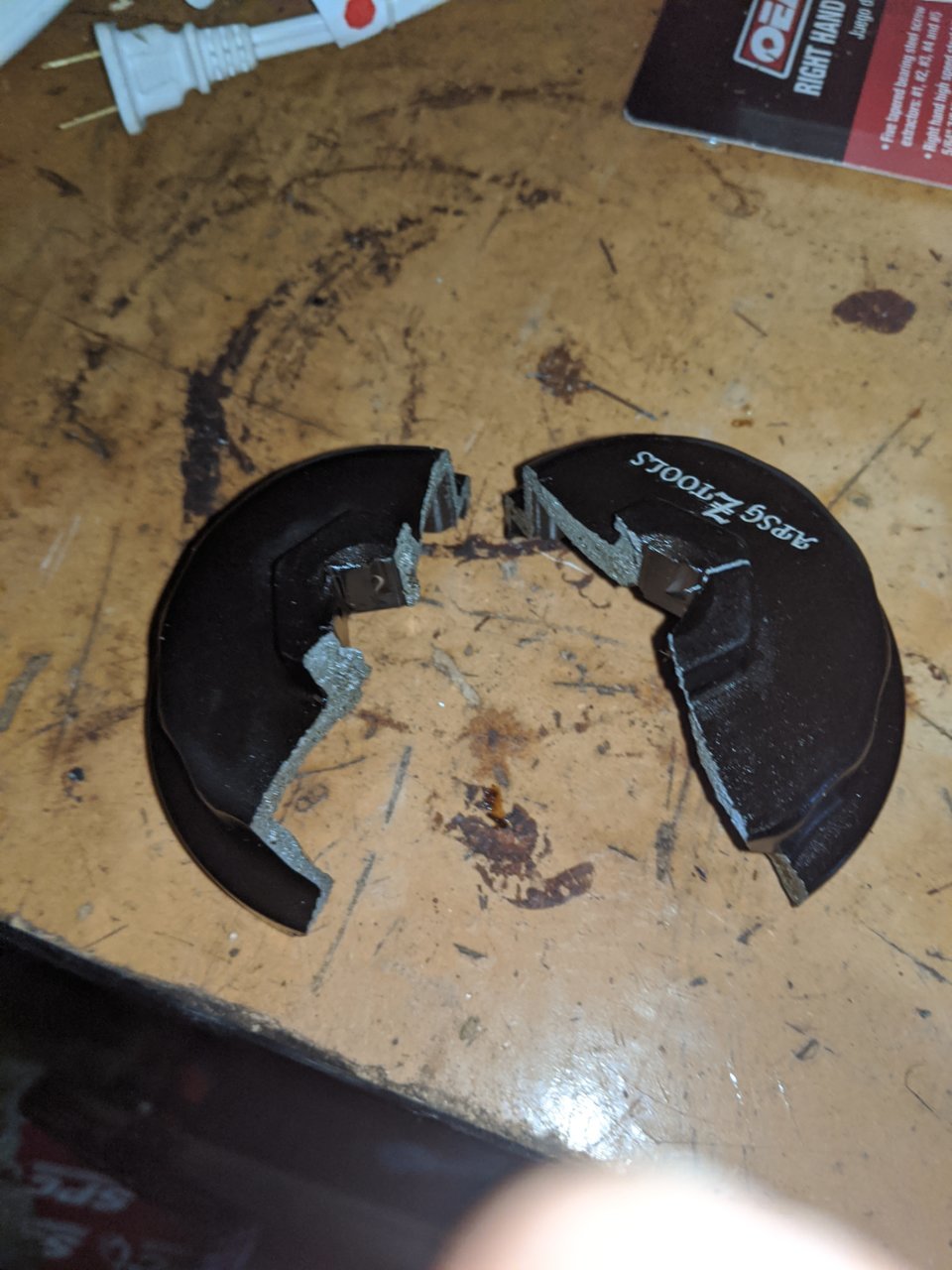

    I agree with you, had a similar experience my first attempt. Snapped my filter tool in half trying to get the housing off, was forced to leave the old filter in till next time . Did buy a aluminum housing..never had issues in my life on any other of the 8 vehicles I've owned..IMG_20200216_125348.jpg
