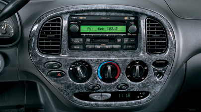

    That's pretty wild! Never seen it before. Is it hydrodipped?

    I like it!
    Too bad I like woodgrain more.

    That is pretty wild, here my wife's 04 limited Sequoia. Wasn't a fan of it at first but it's grown on me.

    Swapped over my bezel yesterday. The switches are tricky but pretty manageable if you take your time. The toughest part is circled. I think it really helped that all the parts were 85 degrees here in Florida, so nothing broke.
