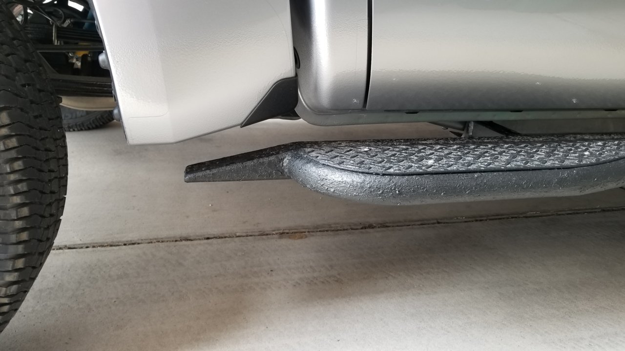

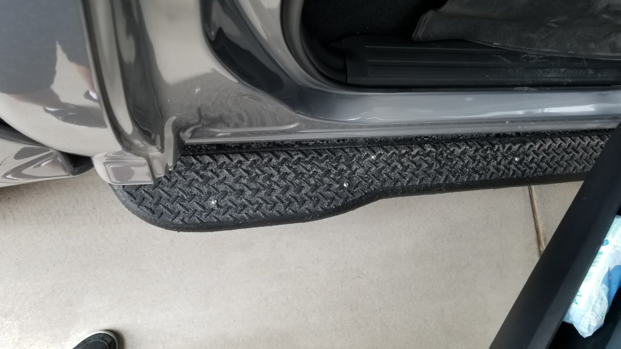

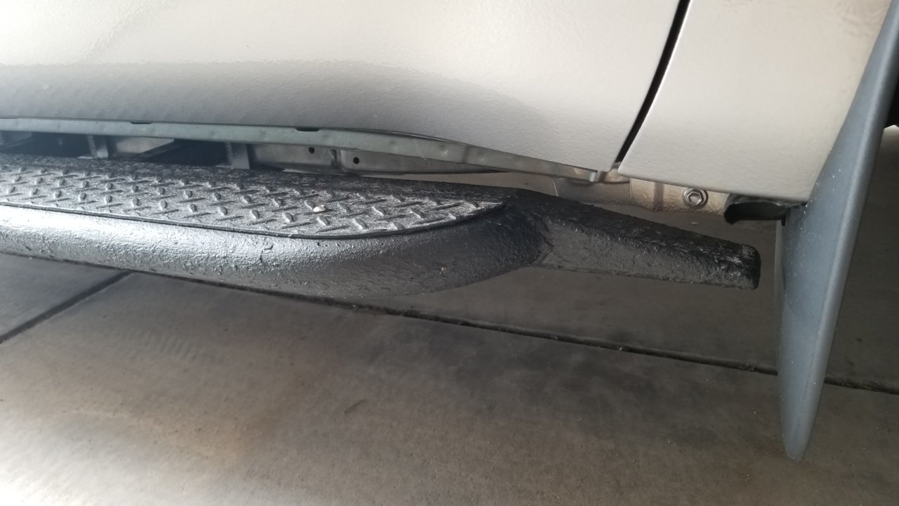

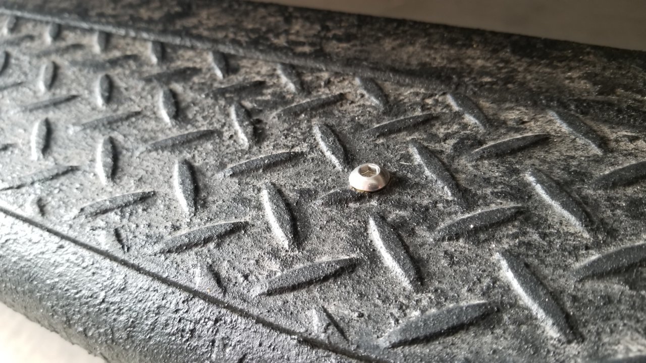

    I purchased them from NV and picked them up at their shop. They wrote off 10 percent off the price for CA taxes. All hardware is grade 8 and stainless steel. I bought them raw and cleaned with acetone and denatured alcohol followed by 3 coats of self etching primer. I then applied two coats of do it yourself bed liner (1 quart) from Autozone. I needed protection from rocks and the extra friction for the elderly parents on top so I only painted the top with the bed liner. They are solid as a rock and the feel of the frame is much tighter. No problem with the 38 gallon fuel tank just remove the plastic protector. Pictures are after off-roading so dust is visible.

    heavy duty !
