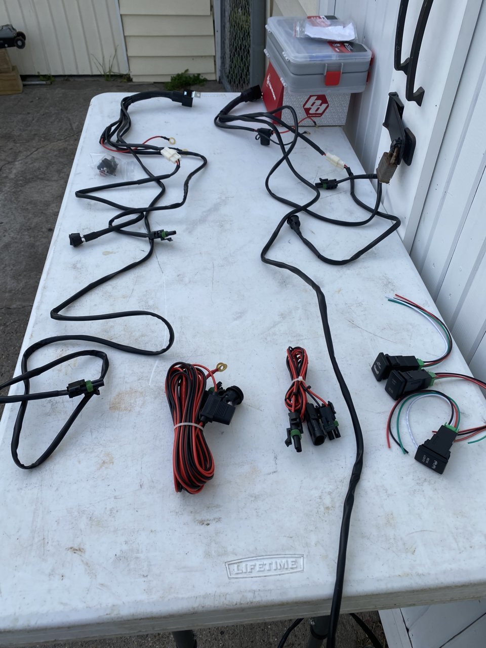

    These are the harnesses that I have currently

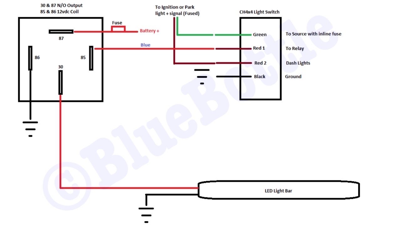

    what you are asking is pretty hard to answer unless you can show point to point of the wires on the harness. I don’t use pre made harnesses because they are meant to be stand alone and not wired the way I want.
    I made a diagram of how I would wire a light bar w the Toyota fit switches. With this config the switch would light up w park light or ignition depending on which you tap into. I recommend park light.
