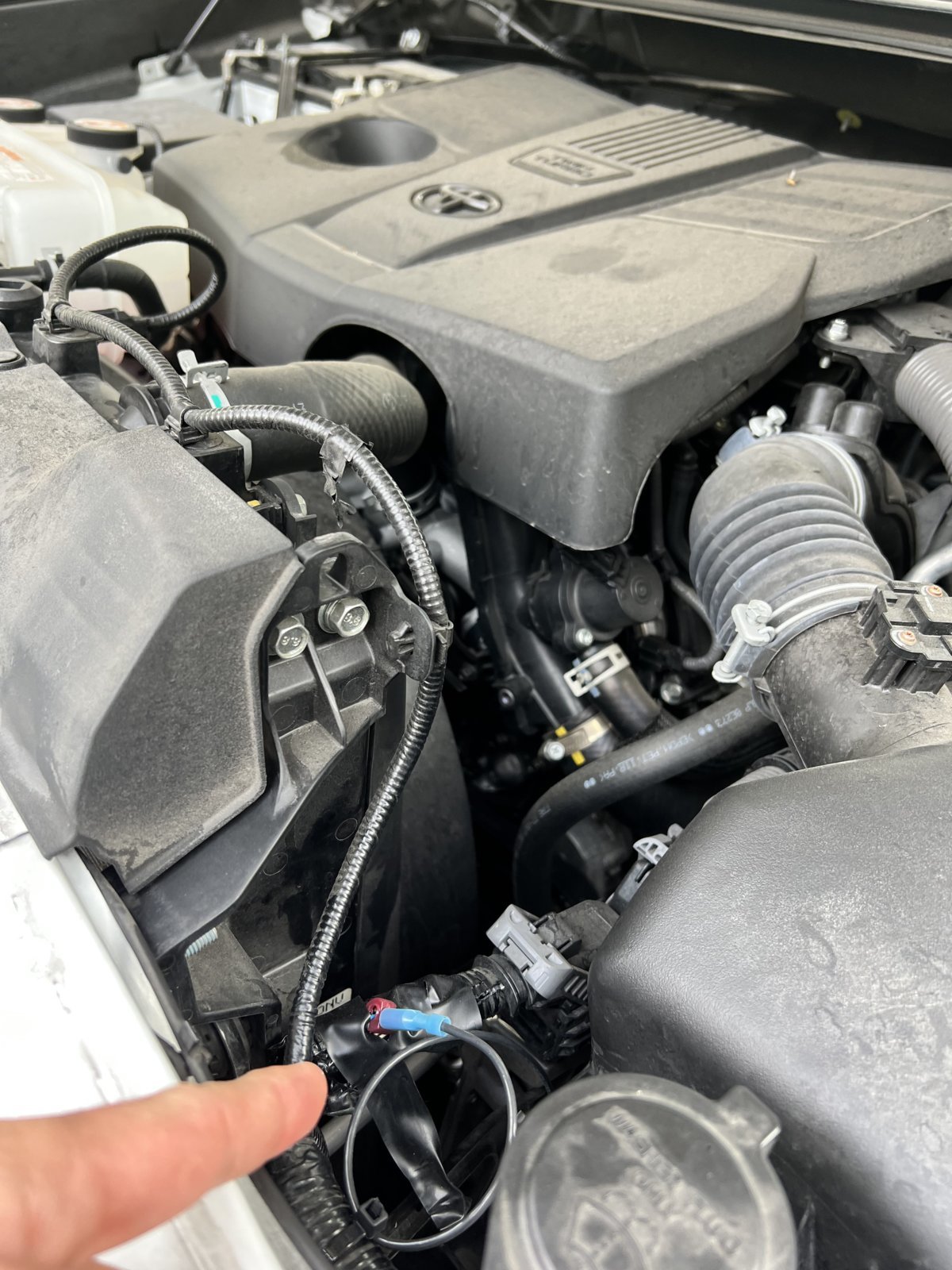

    Can anyone help me figure out the color of this cargo bed spot wire in the engine compartment? I’m trying to wire led lights inside my ARE commercial cap and it would be easier to start by the engine and run it under the truck than to start inside the cab. There was already a wire run by the cap installer for it's brake light. If the cargo light wire is in this bundle I could follow the same path.[​IMG]
