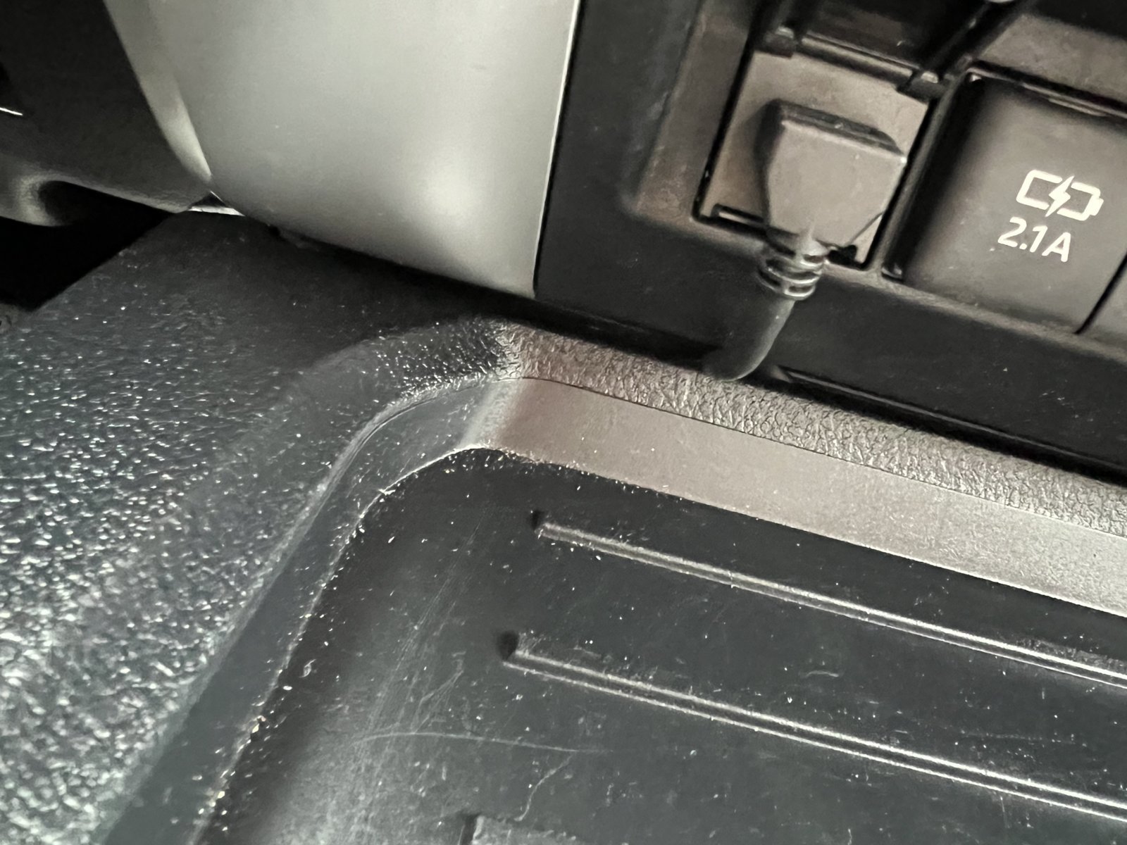

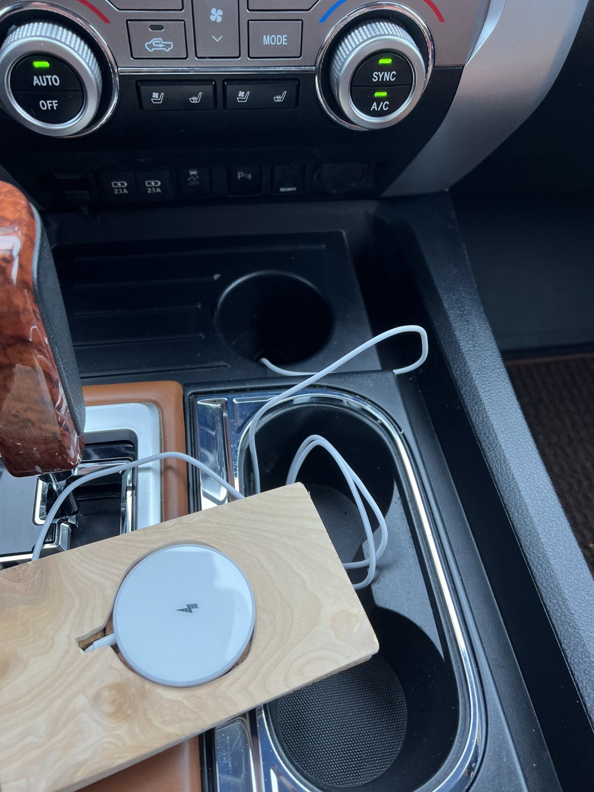

    Hello,
    just wanted to share this. Watched a few videos on removing the shifter section of trim. Whole project cost less than 100$ cnd. And took less than 1 hr. Now I have wireless Apple CarPlay and a wireless mag charger. A friend is bring a scrap of brown leather that I will wrap the wood in or I’ll urethane the top piece. Only thing I might add is a strip of Velcro to the bottom but it’s a snug fit so I likely will not need it.

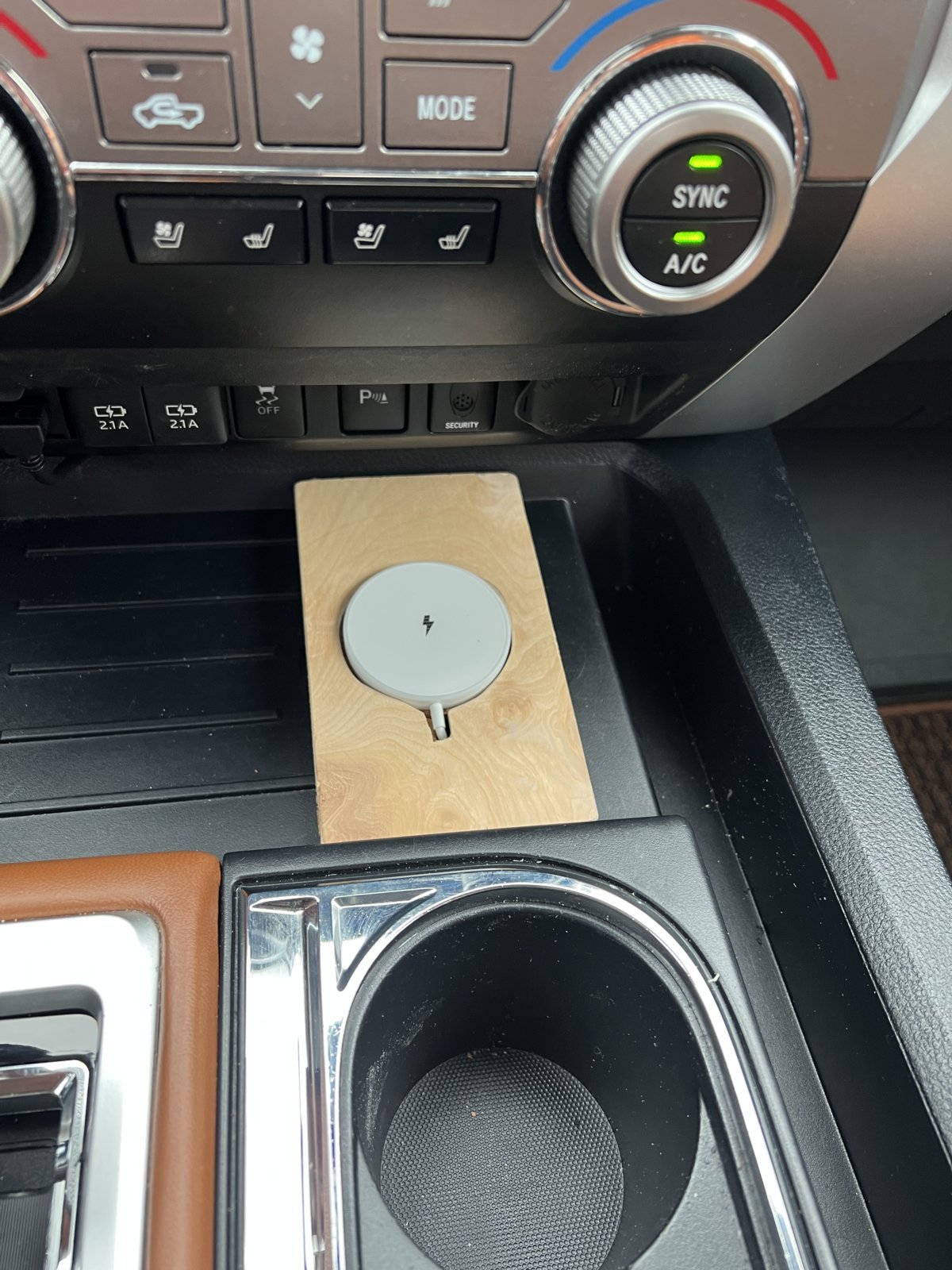

    Here is the final:

    Looks good , planning on building something like this on the armrest, what are you using to hold charger on wood?

    So I have some glue I was going to use but I wanted to test everything first. So the charger is held to the leather and the leather held to the console with double sided hanging tape. I might add a layer of cork to the middle as the charger sits high right now and I wanted more of a sunken look rather than it just sitting on top. I had to turn it that way as there is not enough clearance to the bottom if the usb area for the phone to fit.
    I looked at doing this in armrest but I open that thing all the time and the magnet is not strong enough to keep it from flying off!

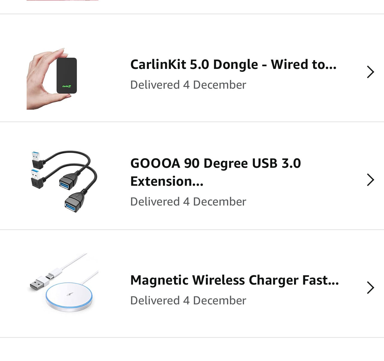

    I’m looking for something similar to this, what were the actual charger/cables you bought to make this up?

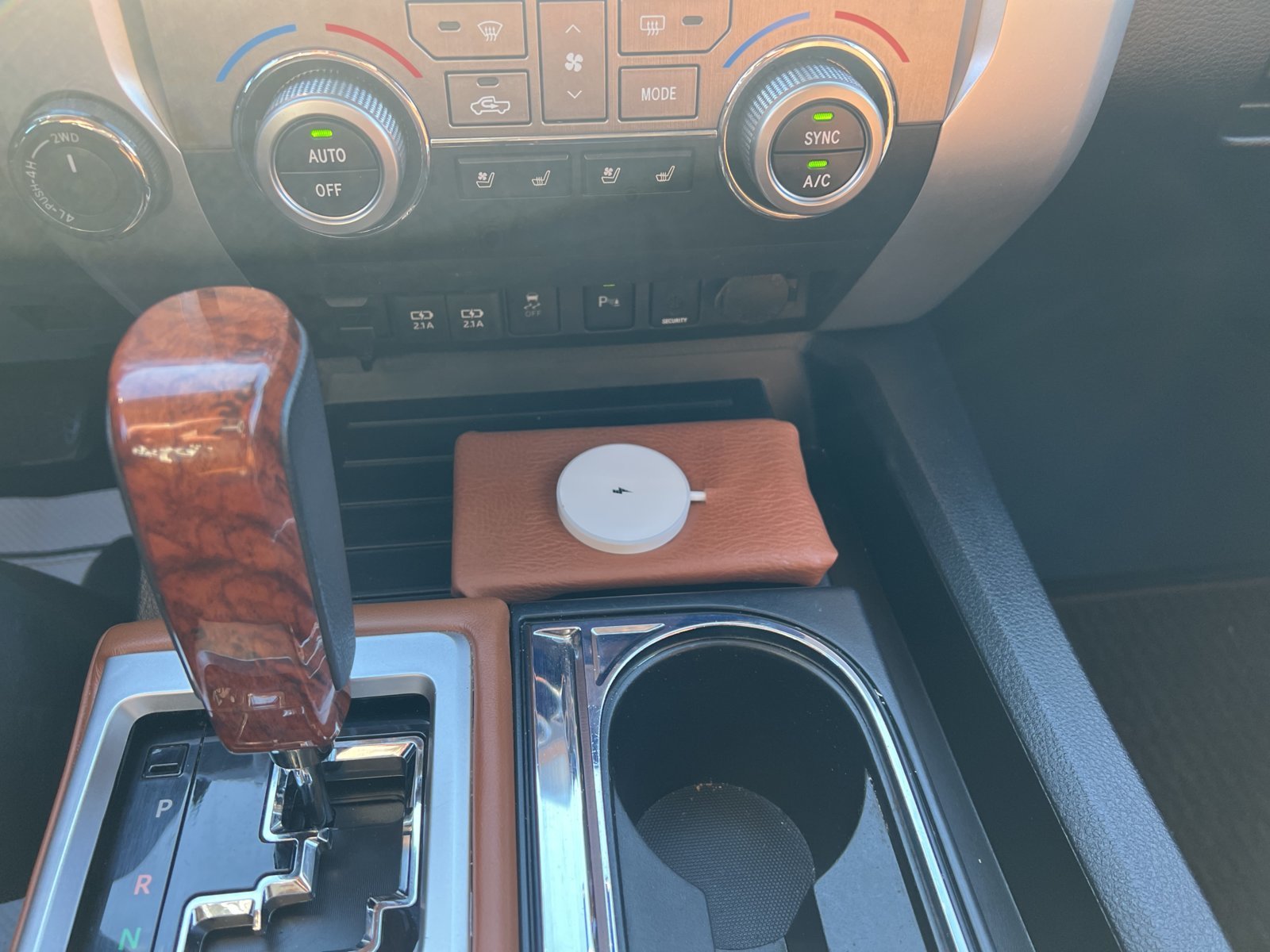

    I can post the links if you need them but here is the stuff! Been working great. Not 100% satisfied with the wrap job of the base /charger but I am picky that way

    I think there are MagSafe options for the console lid insert now too. I’ve seen some threads about them. I used an earlier version of this CarPlay adapter and the same USB adapter, console mod and it works well.

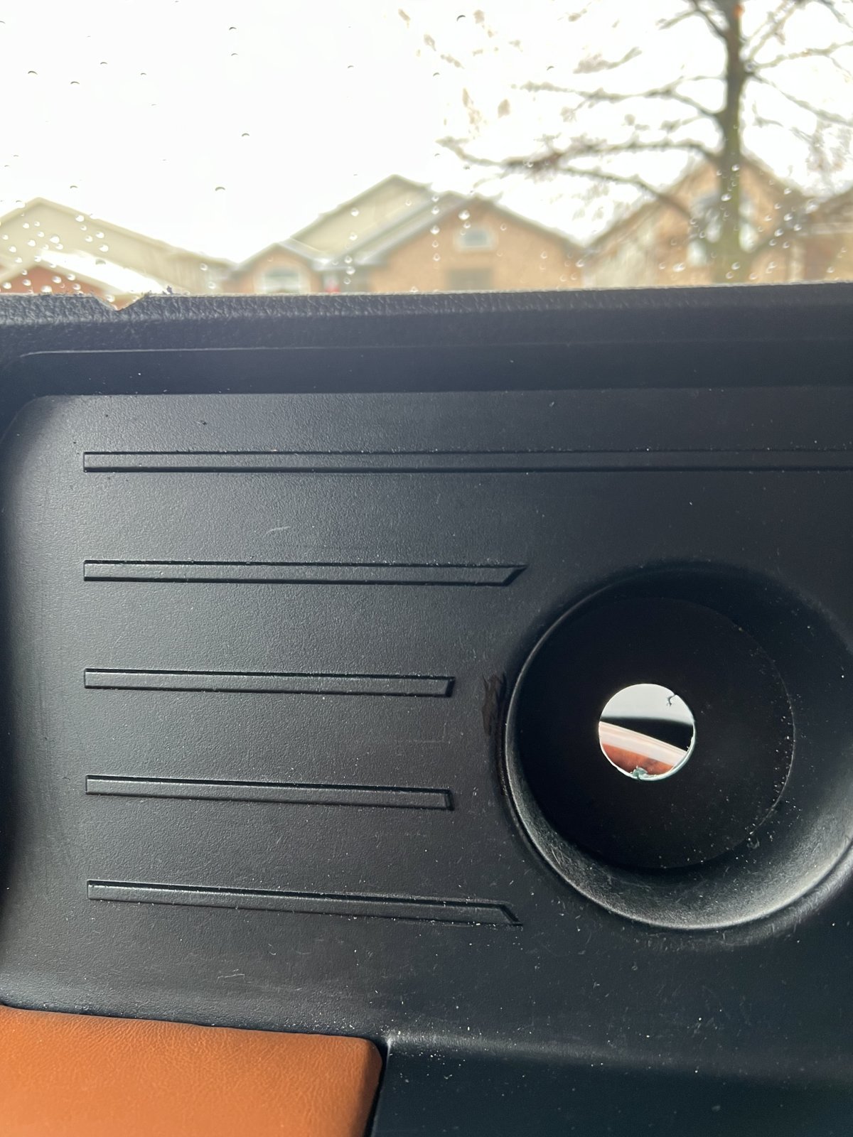

    Yeah there is an adapter that fits in that insert. I am in and out of that centre storage a lot. My phone would for sure get flipped into the back once a day! That’s why covering that cup holder worked better for me. Would not hold much anyway but you could drill a hole anywhere near there. There is a ton of room there
