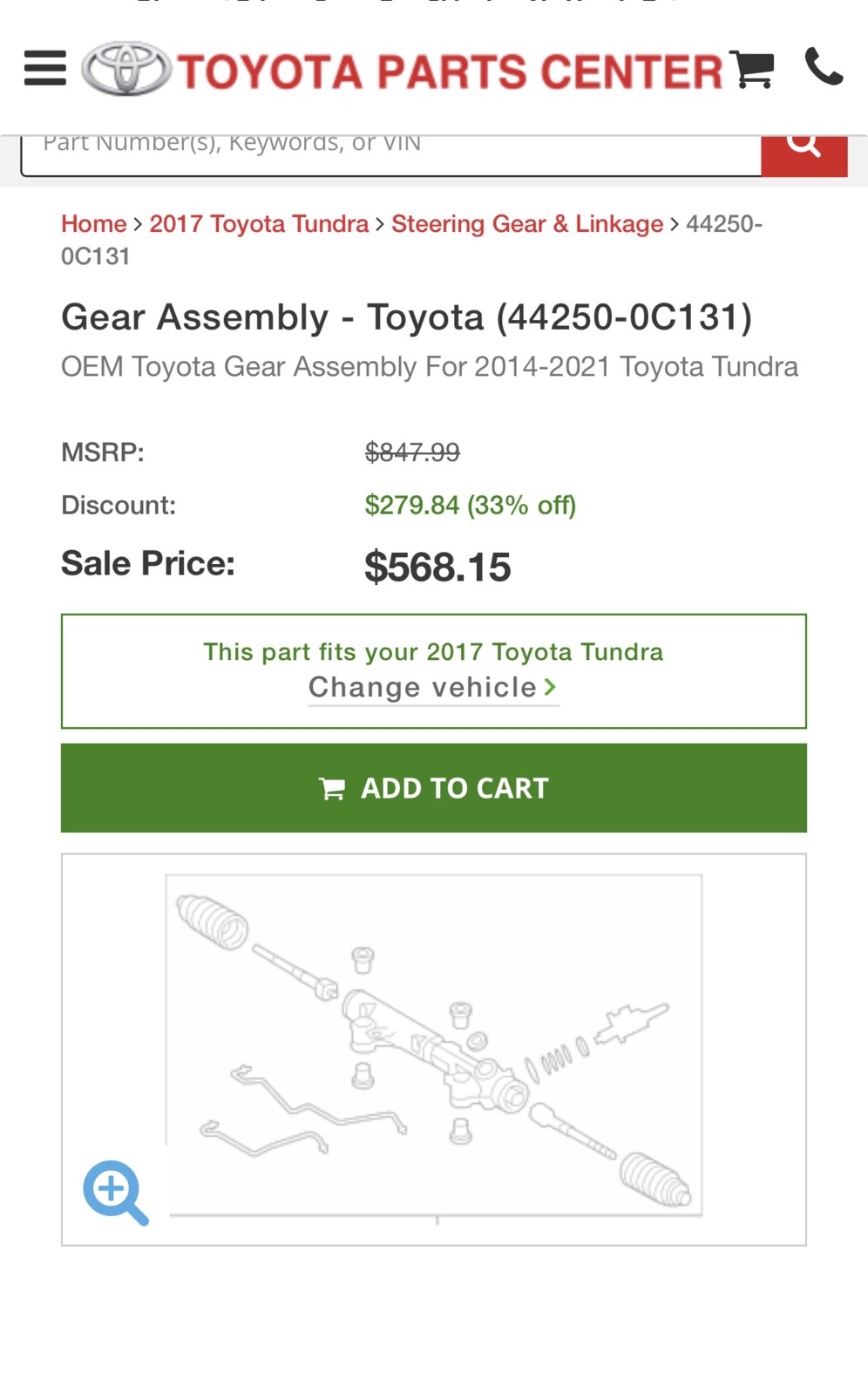

    I get the shit happens comments and sure I could probably repair it myself but the parts alone are over $3k. It would likely take me a weekend. My time is better spent working or with my family. That’s not the point. This truck leaves the garage maybe once a week. 98% of the miles are highway miles. Probably more like 99.8%. It’s super disappointing is really all. Never in a million years did I believe my now nearly 10 year old E class Mercedes would prove to be more reliable and cheaper to own than a Toyota. The Ford Raptor is interesting and the ownership experience can’t be any worse than owning the Tundra at this point. Not the best financial move but it would be new and have warranty. The Tundra was supposed to be the last truck we bought. And maybe it still is? I am disappointed and a lot pissed. Will see if I can get Toyota to step up to the plate some. Anyone know the best department to call? TIA

    Isn’t this it?
