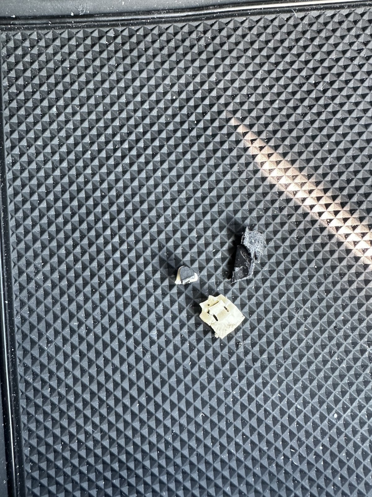

    To say I love this truck is an understatement, however…the windshield “tick” was driving my OCD insane!
    Here is the solution that resolved the issue:
    1)Dropped the headliner.
    2)The windshield glue clip that is inline with the center of the steering wheel and at the top edge of the interior roof line was cut as per old Toyota TSB - T-SB-0141-10
    3) Bend the sheet metal tab holding the glue and remainder of clip. ( do not pry against windshield). Remove glue and clip.
    4) Reinstall and tick sound is no longer present.
    If you don’t want to drop the headliner, you can CAUTIOUSLY bend the liner (don’t go to far) after removing the A Pillar plastic, sunvisor clips and top centre console
    Here’s a pic of the removed clip and glue

    Use a pair of side cutters to cut the tab clip, then simply use needle nose pliers to open the sheet metal tab to remove the remaining tab and glue

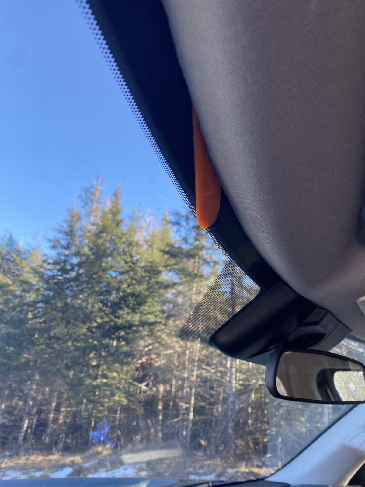

    I took 10 seconds and wedged this trim removal tool in mine and it’s all quiet. I have since rotated the tool out of sight. Did this about a month ago as the creeping was driving me nuts.
