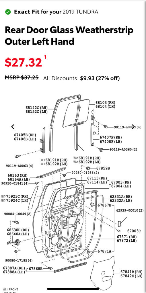

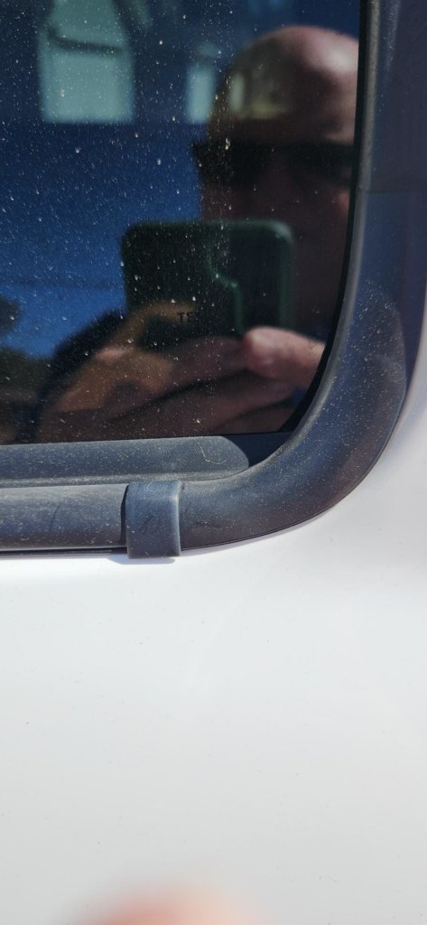

    I was looking for the cover trim piece that covers the window trim on the rear doors. I can't find the part online. Thanks!

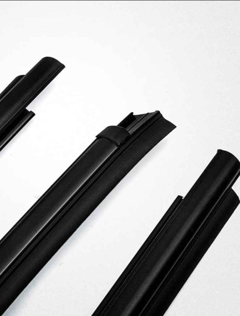

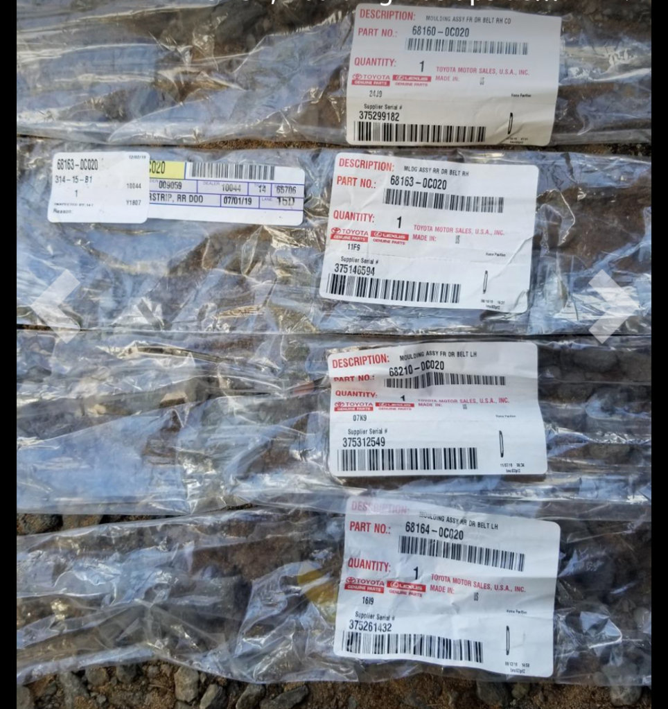

    IMG_0074.jpg IMG_0073.jpg IMG_0076.jpg It looks like the trim (cover) piece that covers over the splice of the two pieces might be built into the actual trim and is not a separate part. I would confirm that of course before purchasing.
    Hope this helps
    Part numbers- 68163(RH), 68164(LH)
