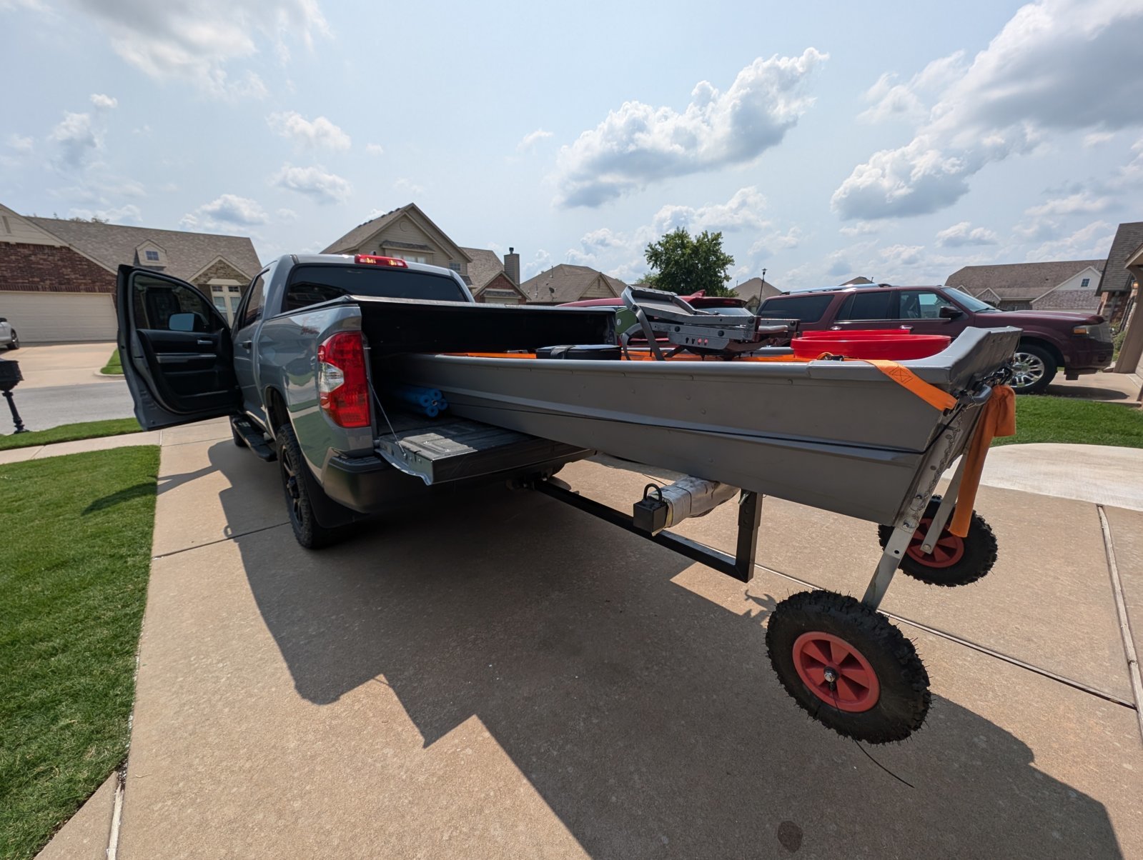

    I'm looking to mount a small winch in the bed of my truck to easily load my jon boat. Any thoughts on how I could accomplish? I'm looking to mount on either the wall or floor of the bed (wall preferably). I use a hitch extender and would love to have a winch just pull it up for me instead of having to lift.

    Didn't even know it was legal to have cargo extending that far out of the bed.

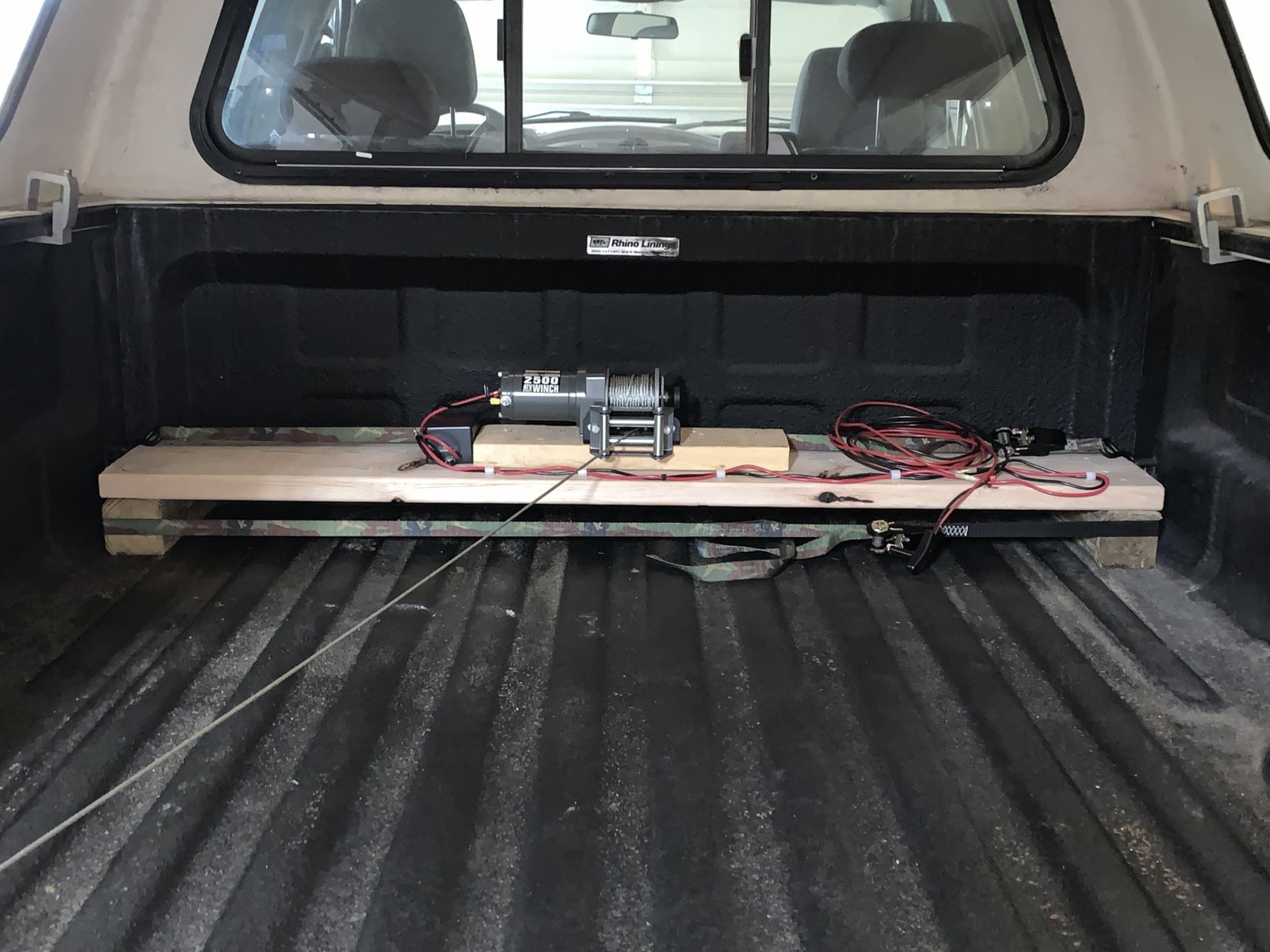

    I think I'll hold off on the track mounted option since the winch is gonna have some pretty good pull to get the boat up into the extension first. I found this picture but can figure out what they ratcheted to. I like this idea to easily remove.

    I bet they hooked those to the tie downs that are in the front of the bed. They will hold a pretty good load.
