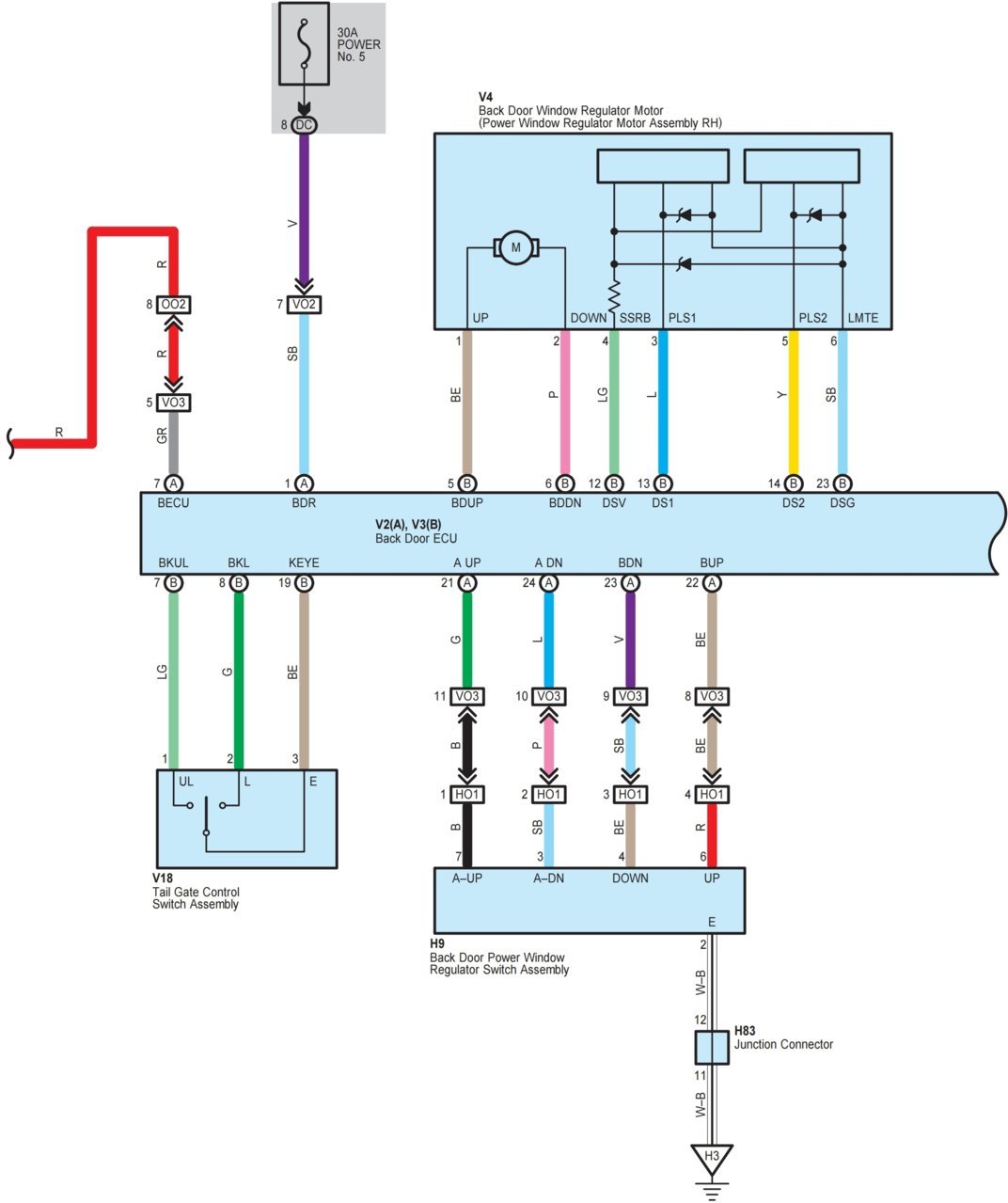

    This is from a 2019 Sequoia wiring diagram. The button has an AutoUp AutoDown as well as Up and Down, but it is all controlled by the "Back door ECU".

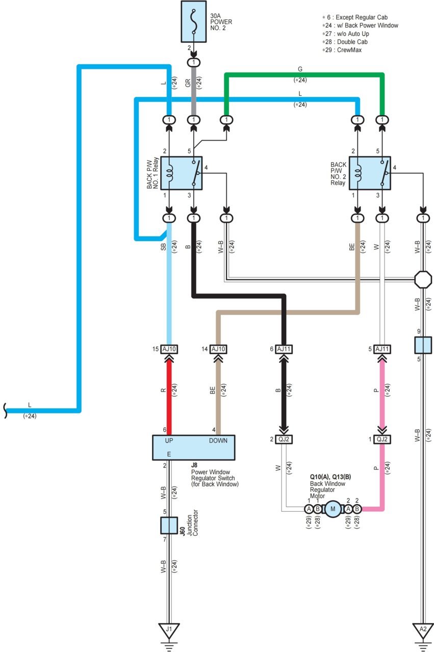

    The Tundra is just run off an Up,Down a switch that controls some relays and makes the window move up and down.
    Its more than programming and code, a whole physical ECU is added in the Sequoia for the "back door" that the Tundra does not have

    Oh wow. Thanks of the comprehensive/definitive reply! I guess I'll be sticking with manual up/down function.
