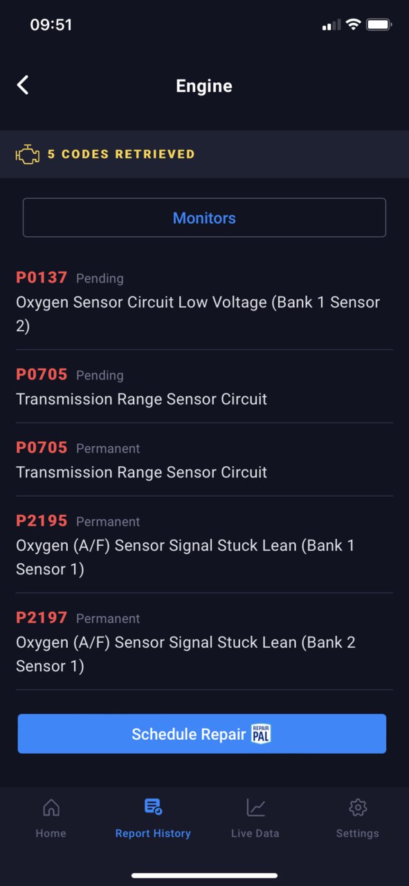

    I double checked and All the fuses are good. The codes I have are attached.

    I'm going to assume that you can physically move the xmsn lever to the "D" position, but when you do, the xmsn does not engage in drive. Your P0705 code means the that xmsn ECU cannot tell what position the lever is in. So it seems that you need to tackle the problem from that angle. A bad or corroded (or maybe even wet) connector, chewed wire, or even an ECU gone south.
    Since the only way that I know of for the ECU to know anything about the shifter position is to have electrical contacts on the shifter mechanism, then the wire or the contact for the "D" position is not working properly.

    It will not go into drive at all. It will shift normally into reverse and neutral but does not go any further.

    So you're stating that you cannot move the shift lever beyond the neutral position. Something's broke. Something has broken off and fallen in to jam the linkage.

    I was viewing this helpful tread yesterday while trying to figure out why my Tundra wouldn't shift into Drive. Ran the computer check got the PO705 code and took it to my mechanic to sus out the problem. Turns out a rock had gotten wedged in so that it was restricting the shifter. $42 fix!
