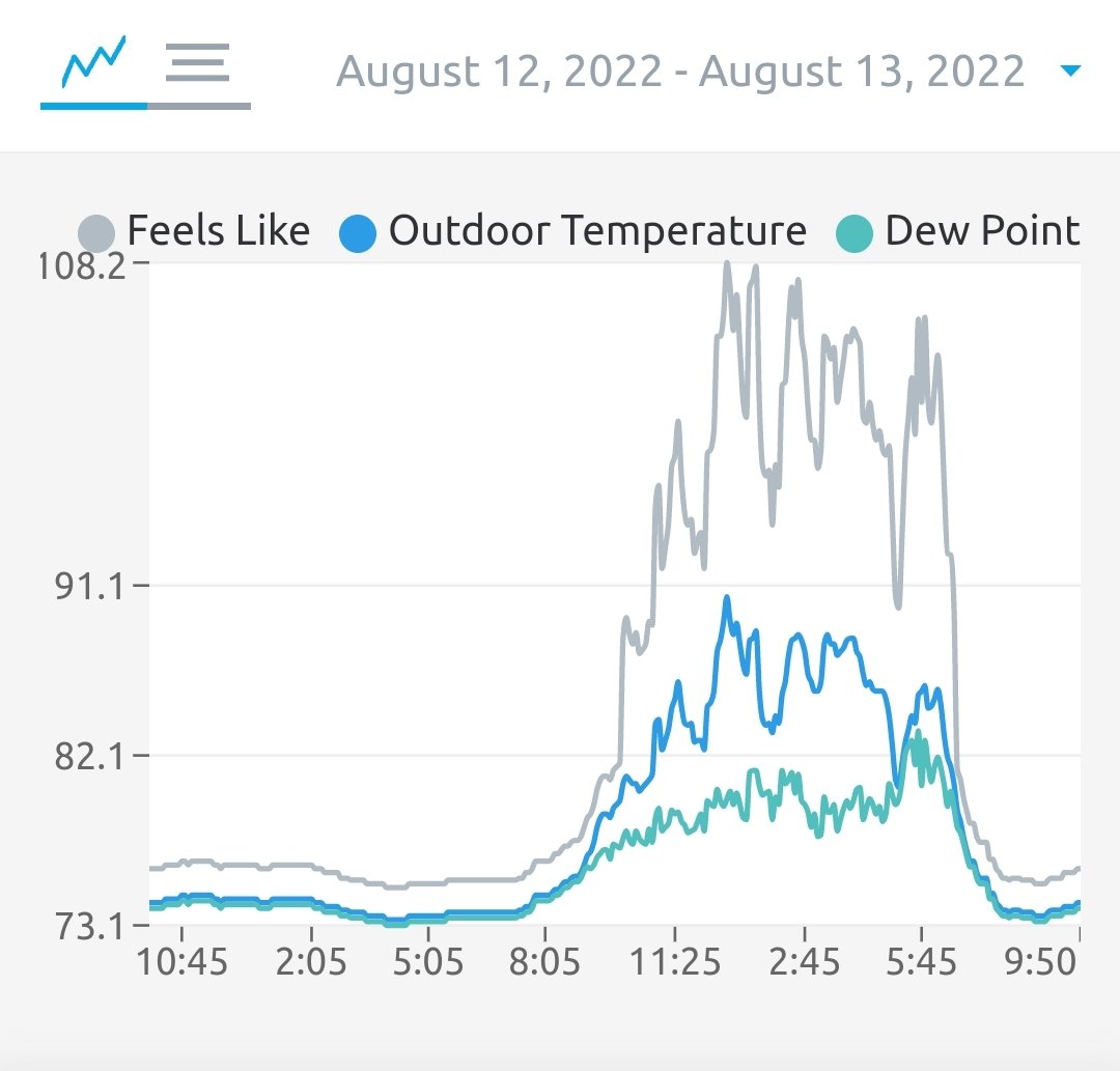

    Been putting the truck to work moving logs around for milling. Dragging a 10' 24" diameter oak up the side of the stack exhausted my little 100ah jobber tute suite but I can just switch to the starting while it charges back up.
    It rained 6 times today, just to make sure that we were in a sous vide all day.
