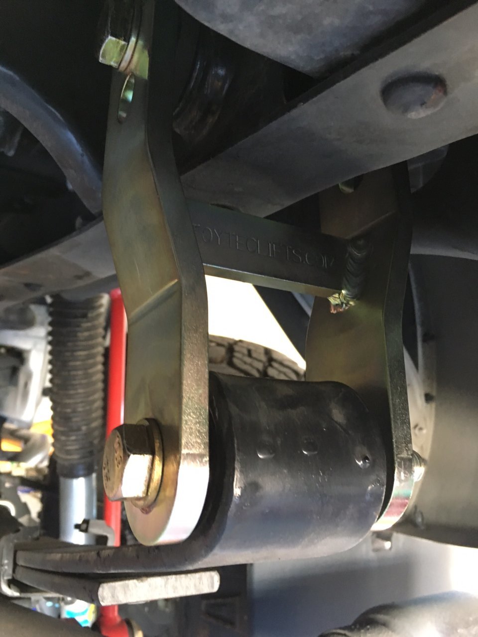

    There are three holes in the Toytec shackles but only the middle and top holes are used on the Tundra. The middle setting is 1" and the top hole is 1 1/2".
    These are set at in the middle for 1" of lift:
