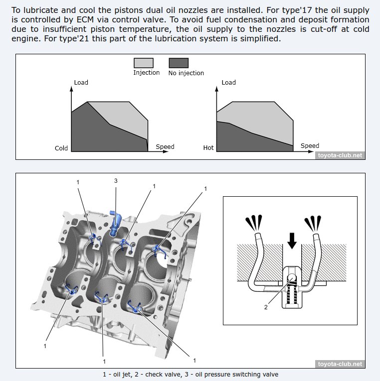

    From https://www.toyota-club.net/files/faq/19-09-10_faq_df_v6_eng.htm What does it mean "simplified"? No control valve and nozzles always spray oil on pistons? Or there's a control valve, but ECM does not do cold vs hot program?
    So I wonder what happens to the oil pressure at the mains when at low engine revs (and limited oil pump output) there's a load surge and 12 nozzles start to consume oil? The pressure starts to drop at the nozzles, propagates back to the oil pump, where mechanical pressure relief valve would has to adjust to the loss of pressure. Can it be that during this short period of time the main bearings receive less lubrication, oil film thickness reduces to below what is needed for bearings survival? Coupled with potential debris embedded into the bearings, which now can be picked up by the crankshaft once the crankshaft moves closer to the bearings in the absence of sufficient oil?
    Nozzles in the turbo engine I took apart are pretty significant oil consumers, looking at their size and proximity to the oil pump. They are not regulated, so there's no abrupt oil pressure changes in their vicinity. But in V6TT there could be such a drop. Unless the control valve has been eliminated.
