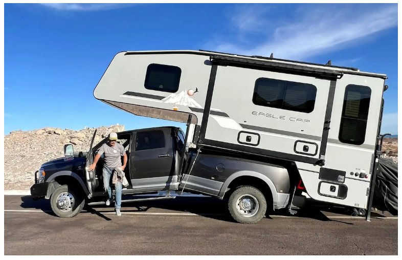

    Wow thats pretty crazy. i had a RTT and bed rack on my tacoma with bed stiffeners which was probably around 400# with the road shower but 900# is a lot to be sitting on bed rails. The x overland guys are hauling a alucab on their 22 tundra which sits on the rails and weights around 500# dry so probably around 700 with their accessories on the rails. I am hauling a 1500# FWC in mine. Only time will tell to see how it holds up.
    Pretty irrelevant compared to what OP was hauling but interesting nonetheless.
    Better buy a bomb proof 3500 next time! oh wait...

    That Ram was a few thousand pounds over if I remember correctly. I couldn't imagine that mess.

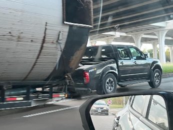

    Here's a Nissan Frontier that might be towing a bit more than it should.
    412B651E-AF7F-40BB-A89C-5218985E6CC7.jpg F73C552E-55AF-456D-9346-AE998FFB5B73.jpg

    Upset? Nah, no emotion here.
    The moral is to never assume anything, whether it's a picture or a posting.

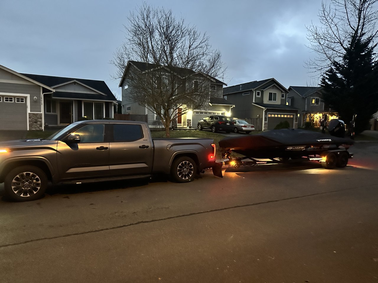

    Just finished the towing trip and it worked out really well. Things seemed to be a little more stable but that's a bit subjective, who wants to spend $500 on some airbags and not have them work out. I did spend a bit of time getting the hitch set right and getting the air pressure right, ended up at 20 lbs. I have an Andersen WD hitch and I ended up having to lower the hitch ball an inch because the bags ended up keeping things pretty level, compared to the 2 inch sag I get most of the time. The trailer is 4300 dry and weighed in at 5000 today with some gear in it. I towed it 200 miles and there were no issues.

    I just added the airlift 5000 to my 22Hybrid. The bass boat and trailer doesn’t weigh more than 4500 lbs but I seem to get a bunch of squat. Does anyone know if they changed the rear springs to acquaint to the added weight of the batteries? Adding bags doesn’t always mean you’re overweight because I’m far from it. I’ve had to play with the hitch a bunch to get the trailer level as level as I could before adding bags.
