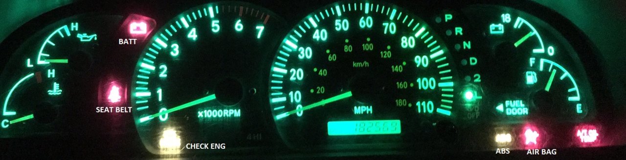

    If you are talking about with the key in ON position, truck not started, those lights should be on, along with others. Is that what you are meaning ?
    this is a 2004 with KOEO(key on, engine off)....

    so the engine light is only on when the key is in the on position, but then goes away once the truck is started. If that’s the case then that’s normal. I suspect something to do with the fuel pump installation or something to do with those cats missing.
