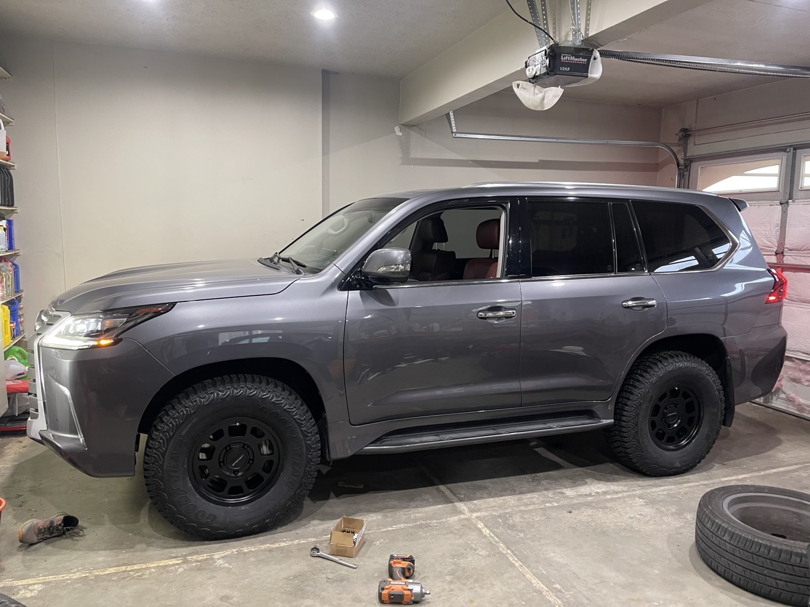

    All, I ended up getting a good deal on some Method MR705's in a 17" +35mm. While I would have liked it to be a bit more positive in the offset, its the closest to what I would like besides the RW and EvoCorse, but I just like the look on an LX570. From a technical standpoint I would like the RW but Im not sure they are my favorite look:
    Not my truck but this is what inspired me to pull the trigger.
    They will be wrapped in a set of 315/70R17 Goodyear Territory MT's.

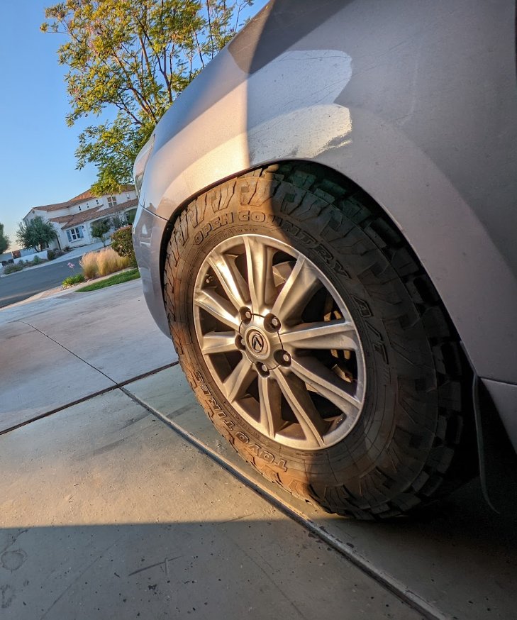

    Here is why I was pissing and moaning so much about the offsets on 17" 5x150 wheels:
    This is an LX570 with 35x12.5's on a stock +60mm wheel with a 1" spacer. Effectively a +35mm offset. They just barely tuck in the fenders when stuffed and I believe he even had to roll the lip slightly.
    IDK if the Tundra has this same problem or if it can even really stuff 35's that hard, but there is no way you could stuff a +25, +10 or +0 wheel like this on a 200 series. You would either need to start cutting fenders or extend the bump stops aggressively, cutting into travel.
    Also, after reading some more, a +35mm offset is just about ideal for a 35" tire in terms of returning the scrub radius back to factory spec.
