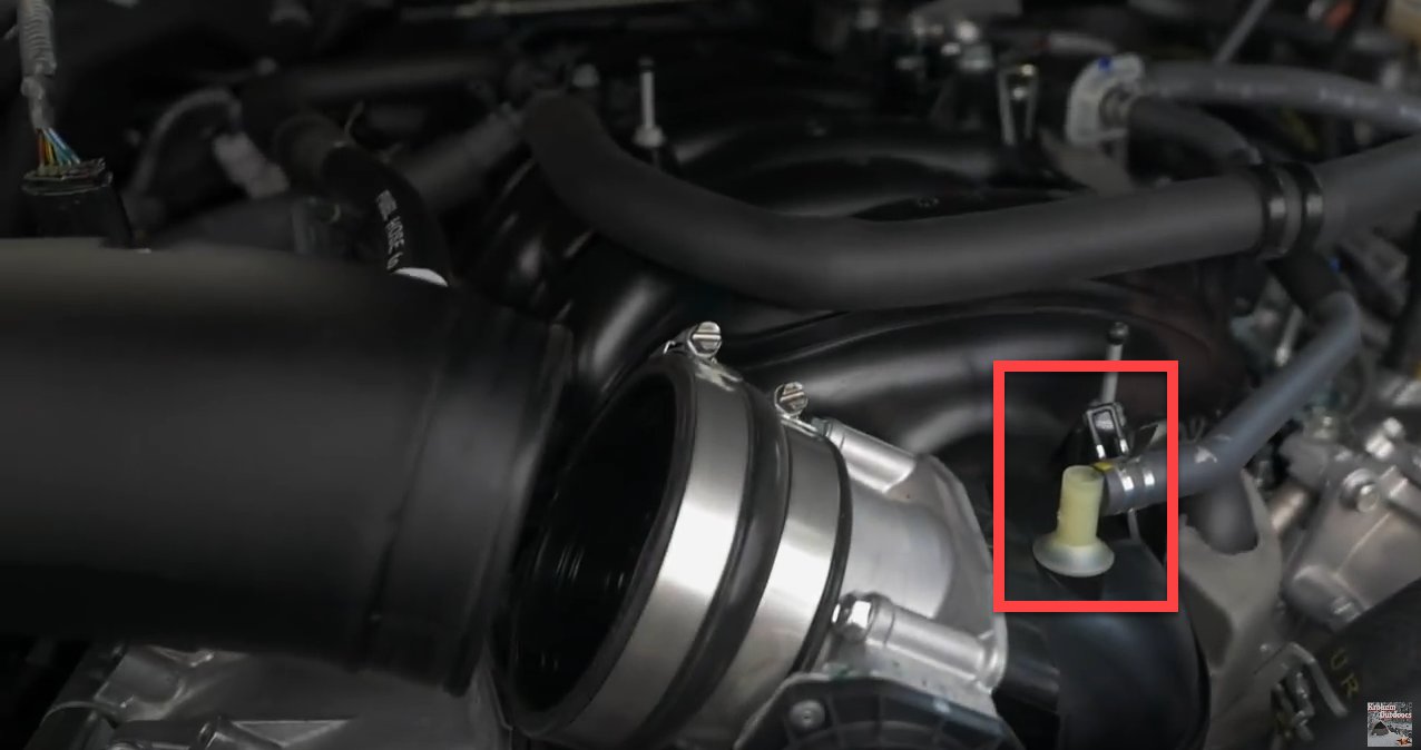

    Hey, I've never installed an intake before and I'm glad you figured it out but I had a question when I saw your video. What connection is this and why does it seem to not cause any issues for you so far?

    It’s hooked up. That’s a 90° fitting. That’s either PCV Hook Up or one of the coolant lines that leads to the throttlebody to warm it up. Without going out and looking at my truck right now it’s hard to tell. Either way it’s hooked up right.

    Ah, I see it now. Makes sense. Thanks for the clarification!
