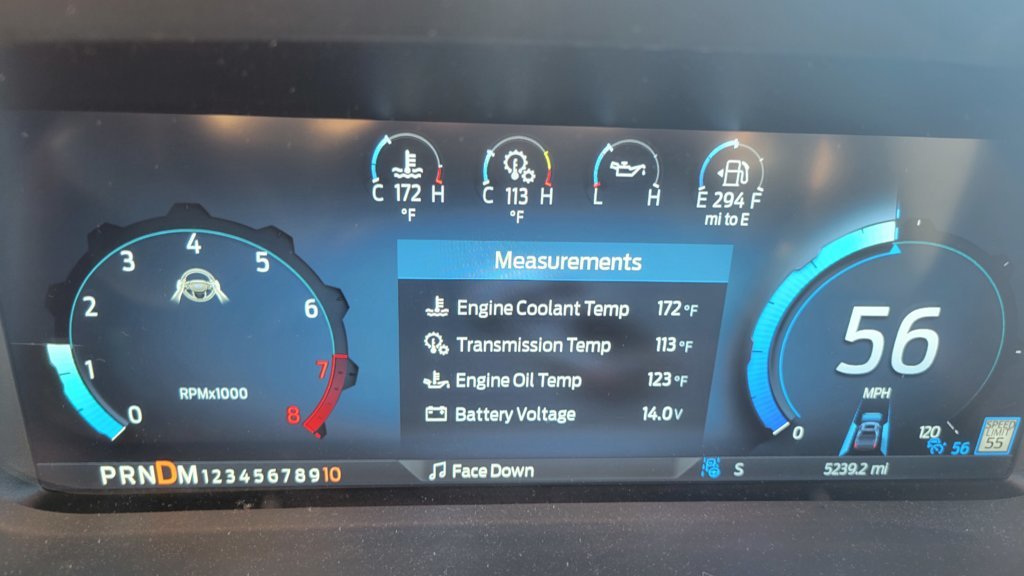

  9. Dec 3, 2024 at 12:53 PM
    #39
    33,703
    18" TRD Off Road Wheels
    Should have got a Ferd V8. :D
  10. Dec 3, 2024 at 12:57 PM
    #40
    Sirfive
    Sirfive Socially feral
    Jan 24, 2021
    #58078
    5,304
    SATX
    ‘02 Limited AC TRD
    Bassani cat-back
    you're gonna have to say it way slower than that.

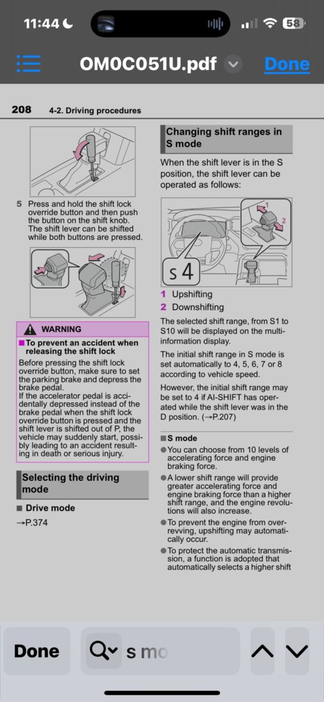

  18. Dec 8, 2024 at 9:32 AM
    #48
    FrenchToasty
    Sep 15, 2019
    #36156
    18,552
    Mo
    The SoAz….. big surprise
    Bone stock
    Raven67 and Breathing Borla like this.
  19. Dec 8, 2024 at 9:37 AM
    #49
    Breathing Borla
    Jan 21, 2020
    #41531
    6,874
    Northern Illinois
    that’s not the way that works
    Whatever you select is the top gear lock out and it changes shift points
    so if you select 8 n your example your top gear is now 8 with a slightly different shift pattern
    it’s limiting the shift range technically
