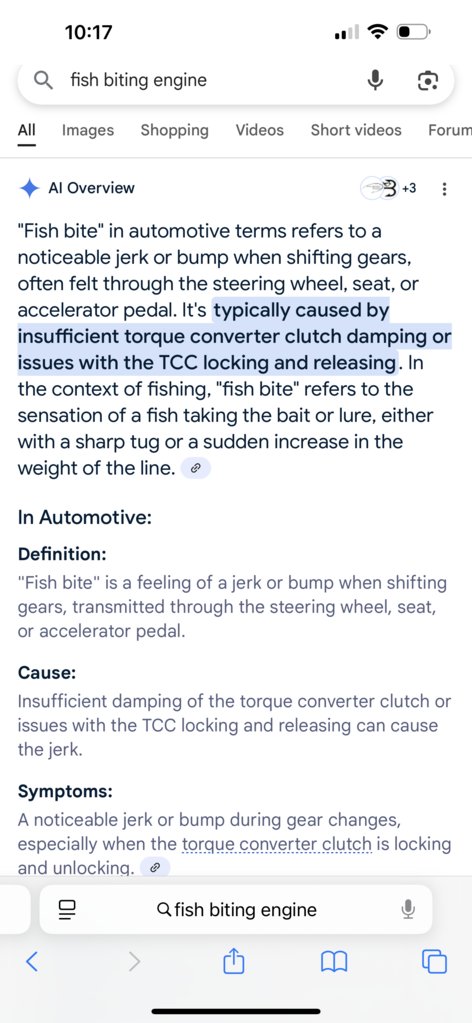

    I still want to know what “fish biting” is.

    Man this thing called search is really cool! :rofl:
