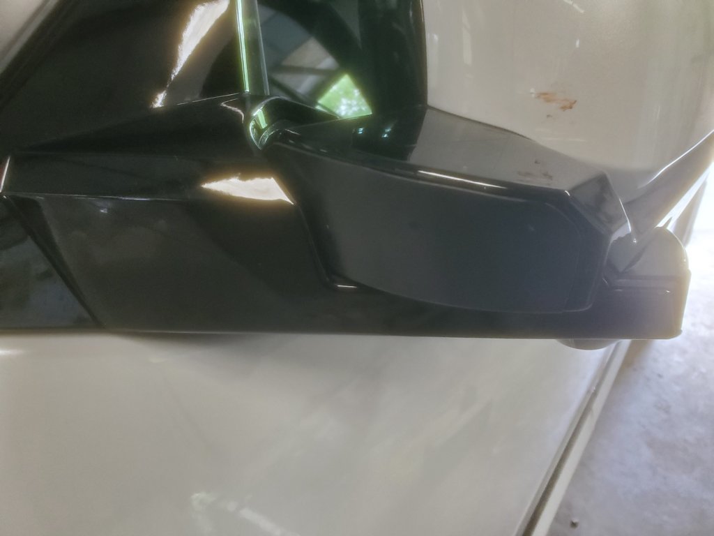

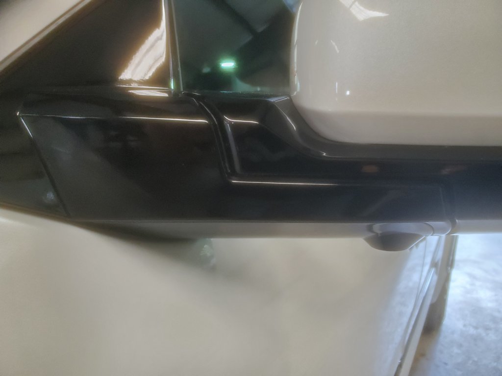

  22. Apr 26, 2025 at 3:22 PM
    #112
    JohnF4x4
    JohnF4x4 New Member
    Jul 6, 2024
    #119505
    212
    US
    2025 Platinum Windchill Pearl with AVS
    On my 2025 platinum they already changed the design of the mirrors. There is no gap anymore.
    Also, i have a slight wind noise above 55MPH. Nothing significant. My wife says she does not hear it. Being an OCD i used painter's tape on all the doors, windows. No gap left unsealed. Tried it. The noise stays the same, no more and no less. I guess it comes through the glass. If i turn the fake 8V engine sound back ON, i dont hear it.
    Will have to learn to live with it :rofl::cool:
