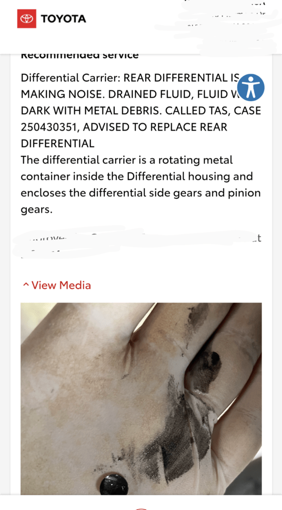

    Glad to find this thread. I got my 23 platinum 2 months ago and I thought the humming sound was normal. Today I went for a 2 hour drive and can't take the irritating sound anymore and googled it. I will schedule for a service tomorrow and reference this thread. I got 13k miles, is this diff replacement covered by Toyota warranty? Thanks.

    You guys are awesome. It's 2025 and decided to have this checked. And true enough, it's the rear diff. Dealer changed it covered by warranty.

    The question is - did that fix your issue and no more noise?

    Sorry about that. Yup humming gone.
