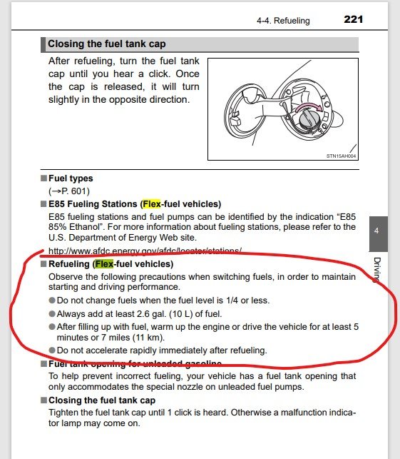

    Thanks!
    At the 10:07 mark he talks about it.
    https://youtu.be/l2OAHImTgA8?si=83gPcLPO4i6I-JQE&t=603
    Procedure from the owner's manual below. I live Florida so the cold is rare here and I always use the same type of gas with ethanol so now I know not to change or if I do, follow these. Also thanks to KNABOREs, I can have it fixed in the next 3 years before the 80,000 mile mark. If it doesn't happen, must mean it's fixed?
    In reality 3 years from now if it occurs, I'll have the pump done and re-flash (pay for it outside of warranty) and carry on for another decade.
