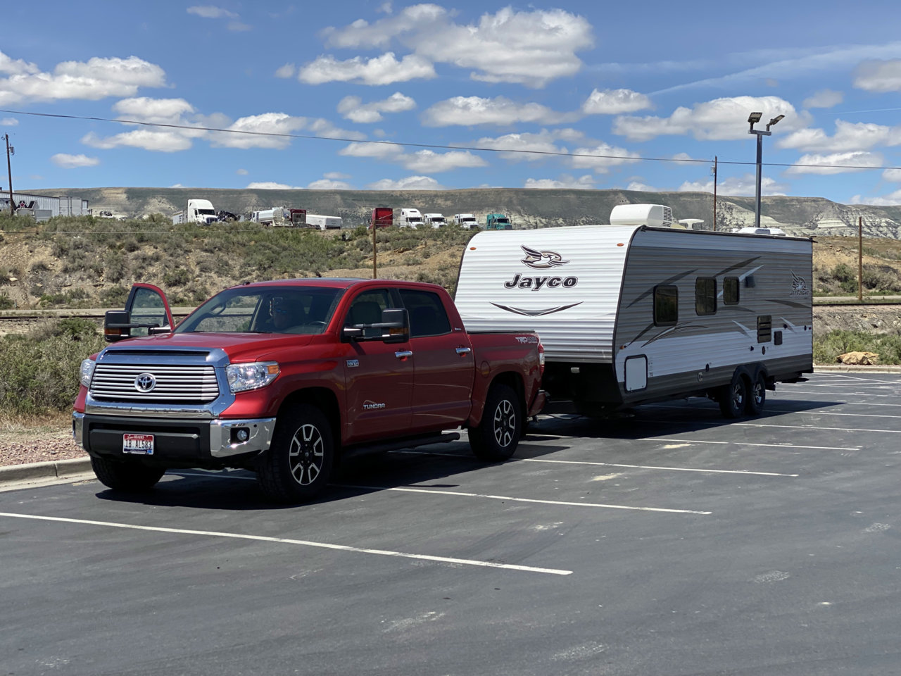

    We have a Jayco Jayflight 26BH with a gross vehicle weight rating of 7,000. We have made a couple of trips from Idaho to Mississippi and Texas (one of 5,250 miles and one of 4,775). Our 2015 Limited Crewmax has a tow rating of 9,800. There's just the wife and I and we don't have a lot of extra stuff. Our last CAT scale weigh-in was 5,680 trailer axles, 3,320 front truck axle and 3,440 rear axle. We use a weight distribution hitch with anti-sway and have had no problems. I monitor our transmission, engine oil and cooling system temperatures. The Tundra pulls it with no hic-ups. We averaged 8.8 mpg traveling at 65 mph. We haven't pulled over any real steep mountains, so I don't know how it would do on that. We have over 76,500 miles on the truck. I change the oil after every trip and have changed the transmission fluid once. We love our Tundra for towing our trailer. Anything heavier than a 7,000 lb. trailer would probably be too much for it.
    Tripleconpanna and LukeS like this.
  17. Jul 1, 2022 at 11:38 AM
    #47
    Tripleconpanna
    Nov 11, 2021
    #70515
    13,678
    2021 TRD PRO CM; 2008 SR5 CM
    That's a nice set up! You won't have any problems on steep grades; just MPG will take a serious hit! Have fun!
