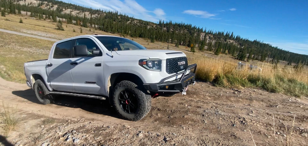

    Why not? :cool::):burnrubber::mudding:
    off road and towing rig :muscleflexing:

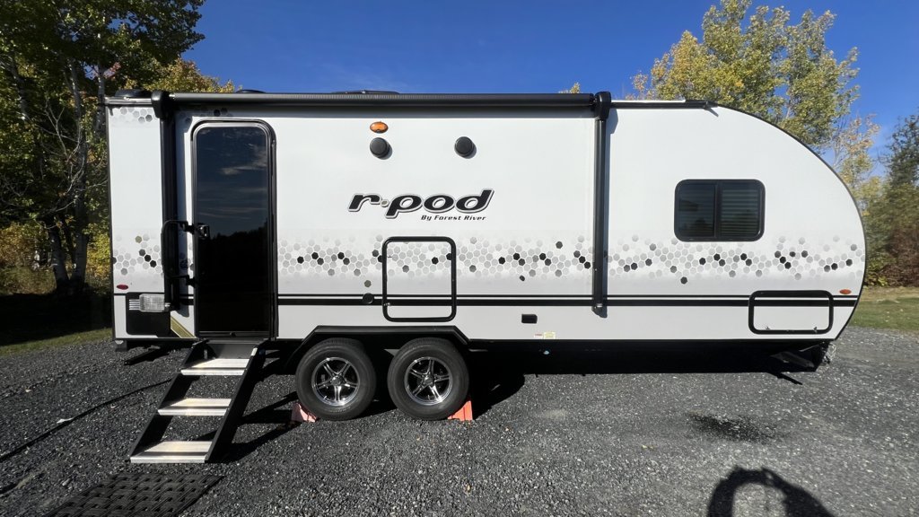

    A 3/4 ton truck to tow your small trailer is just overkill. Sure it will get the job done but you will have to live with it while not towing and give up the reliability of the Tundra. If you were towing with your Tacoma and never had any issues why would you want to step up to a 3/4 ton truck?

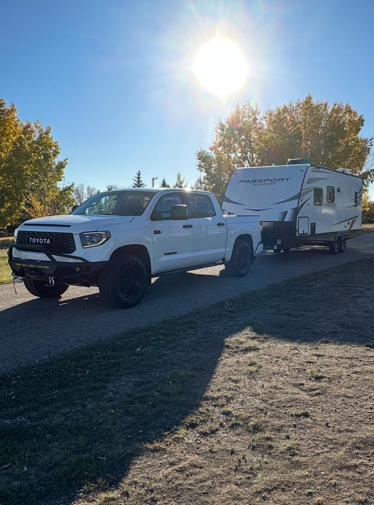

    This is the trailer we towed with our Tundra all over the western United States and through the Rockies. It’s 25’ and weights around 5,000lbs with a tongue weight of around 550lbs. My neighbour also has a Tundra and towed his 25’ Airstream without any issues.

    Didn't say they wouldn't tow, just the setup is more geared for off-road. :cool:
    Y0TA PR0[QUOTED] likes this.

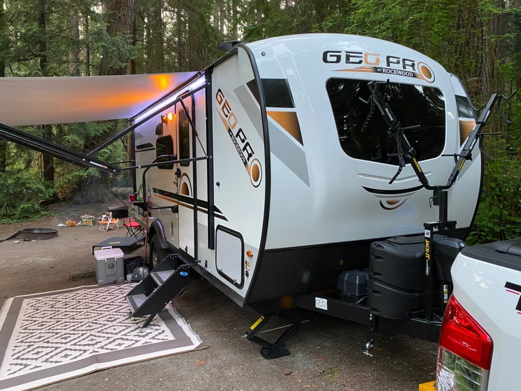

    Our first trailer was the Rockwood equivalent, the GeoPro G20BHS, and I loved that trailer. It was super easy to pull with the Tundra. We got that trailer when we had our Tacoma, but it was too much for it (3rd gear at 60mph is a little tiring...). So I bought the Tundra and the difference was night and day.

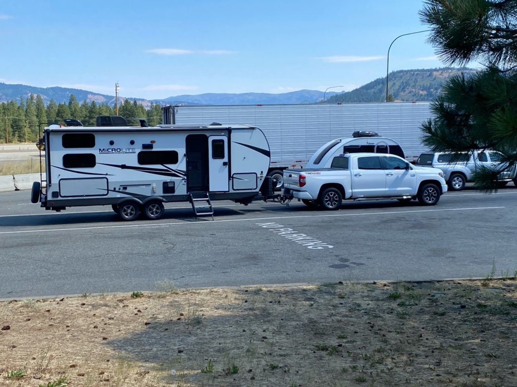

    The trailer did get a little small for us, so we up-sized to a Flagstaff MicroLite 25BRDS. This trailer is 26' and around 6800 lbs loaded. It pulls fine, but I will never forget it's back there, always tugging at the truck. My truck is a 21 CrewMax 1794 TRD Off Road, so I have minimal payload available, and am absolutely pushing it. I put nothing in the bed of the truck to leave all available payload for family members and tongue weight. While I am perfectly fine towing this one long distances, I feel that it is the max size I would be comfortable pulling with the Tundra.
