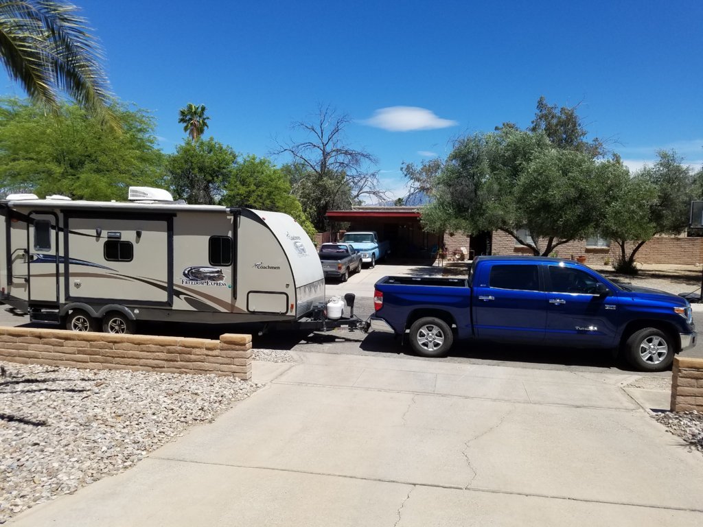

    This is good advice. Sure, the truck can tow more, but it won't be fun. I tow a 23', 4,900 dry (7,200 max) double slide trailer which is perfect size in my opinion for a 1/2 ton. Although even at those relatively light weights, I'm sure I push payload at times when loaded for a long trip.

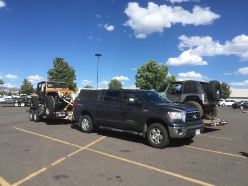

    Towing in CO was exhausting with my Tundra. Always floored, heavy braking, or looking for fuel every 100 miles.

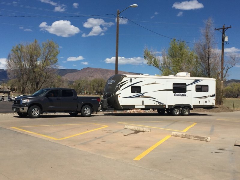

    This would make your shoulders hurt due to all the corrections due to the rather large wind sail.
    This was max capacity (9k) but less wind resistance and way better brakes. Easier to tow.

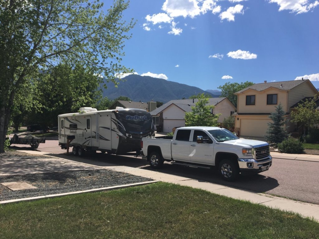

    This is just a whole different experience towing at even double the weight. I'm at 120k miles and still have 70% on my factory brakes due to grade braking and having an exhaust brake. Set the cruise and go.

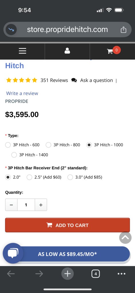

    Hensley? Or Propride?
