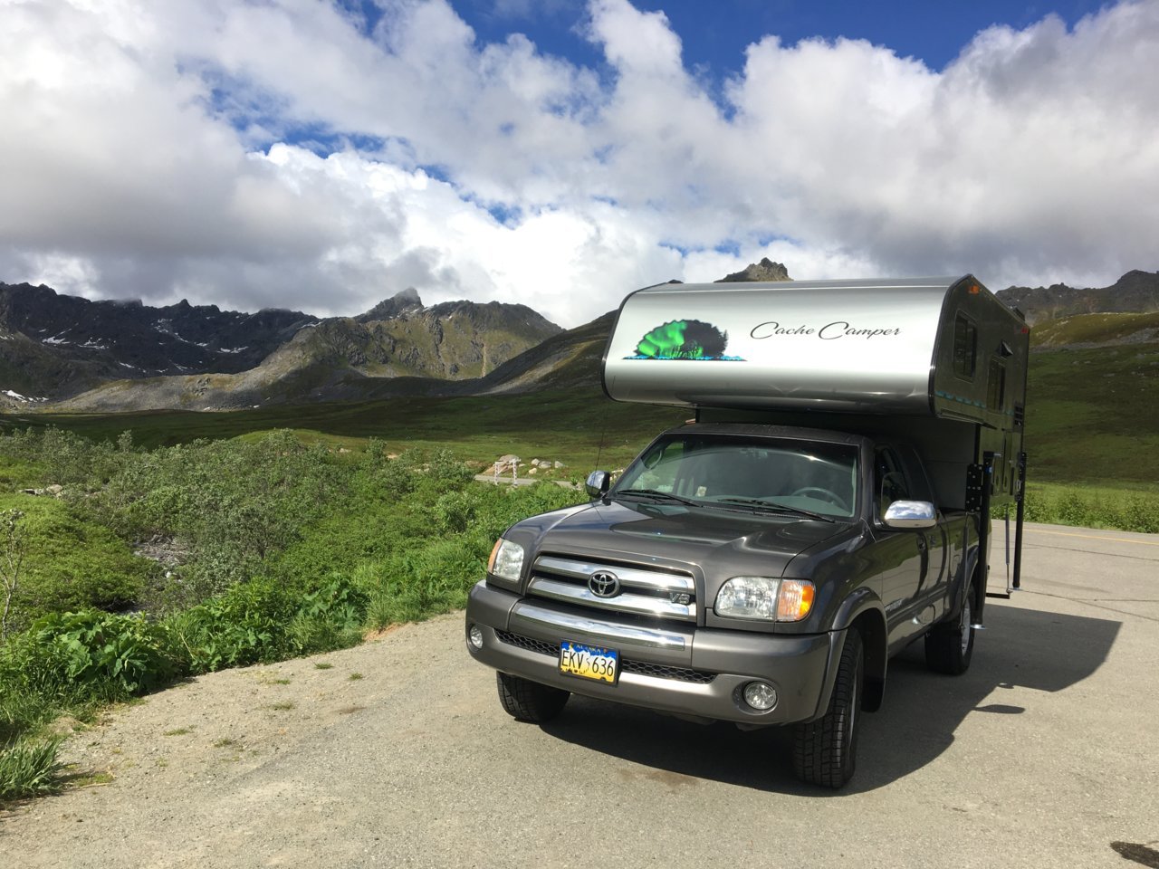

  5. Oct 10, 2022 at 3:11 PM
    #35
    ElleninAlaska
    ElleninAlaska New Member
    Oct 8, 2022
    #84587
    2
    Ellen
    2021 Tundra Limited Smoked Mesquite & 2003 Tundra SR5 Acc cab
    2021 - not much yet 2003 - Cache Camper Overlanding Truck
    I had a cab over camper built by a local manufacturer for my 2003 Tundra. It's a dry 4 season camper. I am hoping to put it on my 2021 crew max when I retire and drive in to the lower 48. Cache Camper put airbags on mine.
